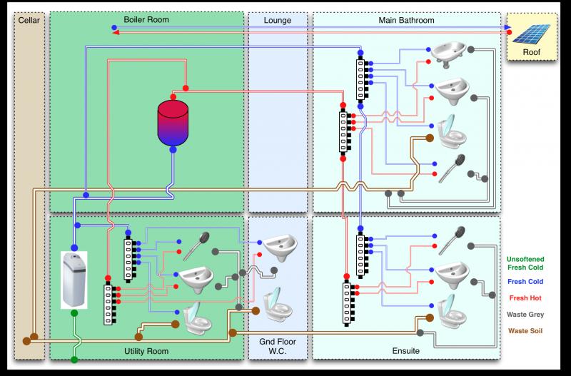

    Hi,
    [Apologies if this has been requested before - I see quite a few pipe sizing questions but not much on plastic variants]
    I am about to install new hot and cold pipework for a new floor on a house in Switzerland. This will involve:
    - Running H & C supply up two floors from basement to 1st manifold - roughly 4m rise.
    - 3m runs from this to main Bathroom Bath/Shower/Basin/WC.
    - Another trunk line from 1st manifold to 2nd manifold (4m) and ensuite items (Shower/Basin/WC).
    I prefer manifolds over trunk/branch to avoid burying any junctions in walls or floors.
    This is a very simplistic schematic - sorry for the lack of 3D or or other details but I didn't have time to do something more sophisticated.
    We have a vented HW tank in basement, with both H &C are fairly balanced pressure of at least 4 bar.
    I've settled on using Geberit Mepla PEX/alu/PEX pipework as it seems to be increasingly the standard here. As the new extension is entirely in wood, not waving a blowtorch about is also quite appealing.
    So (finally) to my question!
    Mepla comes in three smaller 'domestic' sizes with outside (inside) diameters in mm of 16(11.5) , 20 (15), 26 (20) : Please login (registration is free!) to view this link.
    http://catalog.geberit.com/public/product.aspx?cat=GB_GB-en_1&ch=212&p=38107
    Starting from the 'rule of thumb' for 22mm/15mm copper pipes I've seen quoted/in books and matching inside diameters, these would be the closest match:
    - 26mm Mepla for supply lines, bath & shower
    - 20mm Mepla for basin & WC
    However given the layout, the fact there are very few/no junctions on pipes to create pressure drops, and based on other installations I've seen I suspect the pipe sizes are excessive. I'm leaning more towards using 20mm & 16mm instead. Current shower on ground floor has a 20mm plastic pipe for some of it's run and has very acceptable pressure & flow.
    Can anyone give me some advice / thoughts on this, or direct me to a good resource?
    Thanks very much
    Richard

    Thanks that is useful as a starting point. It certainly suggests that 15mm internal diameter is adequate for getting a decent 12l/min shower.
    However I understand that a lot of other factors (length of run, number of joints, curves etc) will also impact this.
    My inclination is to oversize the pipes - as the additional cost is marginal in overall project. However that has downsize of longer wait times to bring hot through and more heat loss after.
    I'd be interested to hear what people who've done PEX domestic installations have used in a reasonable sized (4 bedroom) family home.
    Richard

    The problem is, the system you are thinking of using isn't standard in the UK domestic market. Mapress/crimped connections would be used in places where a naked flame isn't allowed, but a permanent union is needed, ie hospitals etc.
    I would be tempted to oversize my pipes too, and insulate them thoroughly. There are a lot of services there, even allowing for diversity of use. You could install a secondary circulation system (DHW ring main) for hot water, if you want it at the outlet as soon as you open it.
    PEX is a good idea. It's much more resistant to bursts when pipes freeze, if this is also an issue.
    You say hot and cold are balanced at 4 bar? Is the DHW unvented? Or a thermal store with header tank?

    Thanks for the helpful replies. Some thoughts/follow up questions:
    - Hot and cold are at least 4 bar - they could be higher but I don't have a easy way to check at present. It's a 200L unvented DHW tank, which is heated by an oil fired boiler.
    - DHW ring would be nice, but if I can keep the runs short enough, and insulated them then probably can live without it? My maximum deg leg is about 15m.
    - When you say "isn't standard in UK" I assume you mean Mepla specifically? I understand that copper is still by far the most common choice for domestic installations, but also that PEX or other plastic pipes have started to get more popular? So any experience with other types/sizes would probably apply. I will probably source pipes in UK, so I could go for another brand if there was a good reason to do so.
    - I was planning to use pre-insulated (6mm layer) pipe for hot supply, but for cold leave it uninsulated (links for both types below). As the pipes run in heated, very well insulated building which is always occupied, and none are for drinking, insulated cold didn't seem important. Do you think otherwise?

    Geberit Mepla, excellent system used extensively in hospitals in Scotland as copper is not allowed. The 16 and 20mm od sizes bend easly to save fitting and pressure loss.
    My main concern about your choice to run 26mm od for 15m is the volume of water this run will contain. Which apears to be 4.7 l.
    running it in 20mm od would near half this.
    Calcs here.
    So if the flow restrictors on the ensuite WHB are set at 4 or 6 lpm (can’t remember which) you could be looking at a 1 minute reaction time for DHW.
    Not only that but after you have washed your hands, no matter how well insulated the pipework, this 4.7 l at 60deg c will probably cool to ambient before the next use, losing energy you have paid for.
    If you are indeed running at 4 bar I would download the Geberit literature and do the math. It may save you money on fittings and energy.
    Also consider how you get from 20mm od onto your brassware. I would expect that 16 od should be fine for these short runs.
    I dont work for Geberit and i am only expressing a concern. Geberit may be able to help if you provide the drawing above complete with pipe lengths etc.
    Please don’t take my advice before checking for yourself.

    Thanks for the thoughts, however I've already bought the 26/20 lengths so I'm committed now. I'll look again at my runs as I can probably shorten them a bit more to reduce the delays and loss.
    Time will tell if it was oversized - I'll let you know when it's up and running what the delays are like.
