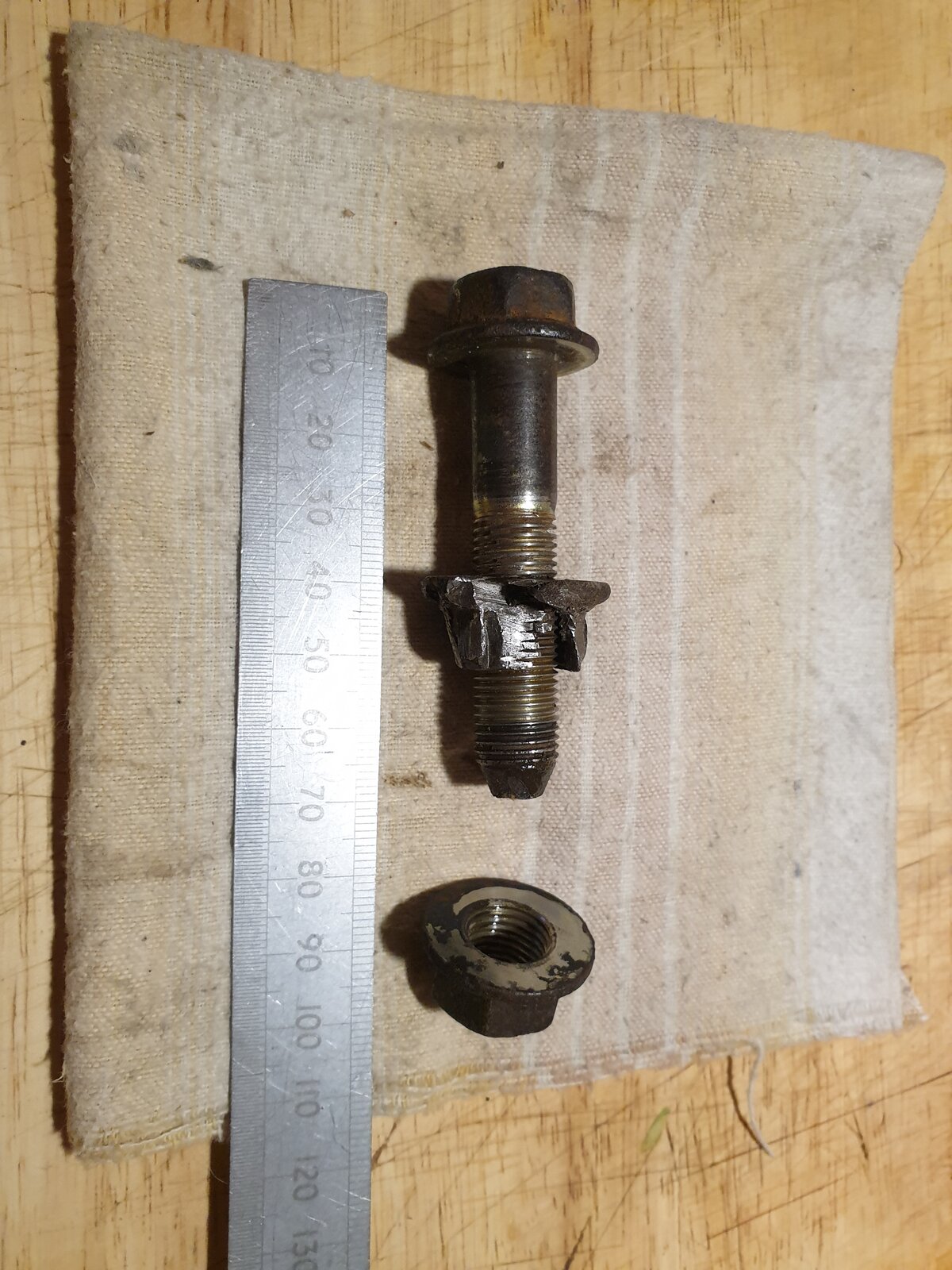

That is a bolt from a rear strut on a 2006 lacetti.
The bolt is the original, I split the nut with a hacksaw then opened it with a chisel. I got the "new" nut from a scrap Mazda. The joys of motoring. 20210302_203028.jpg
