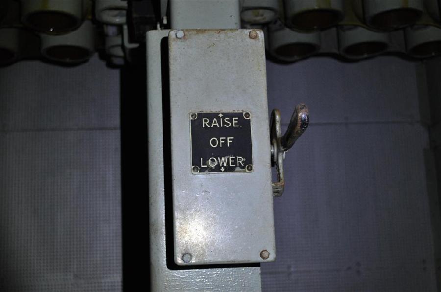

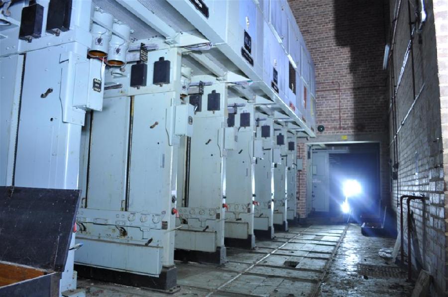

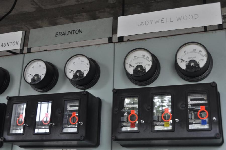

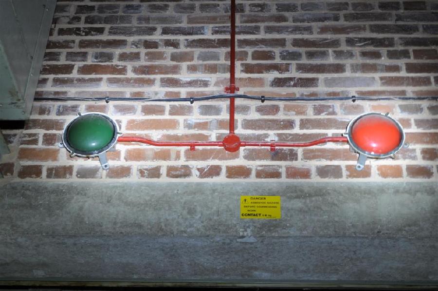

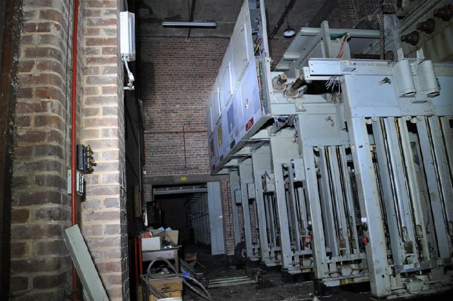

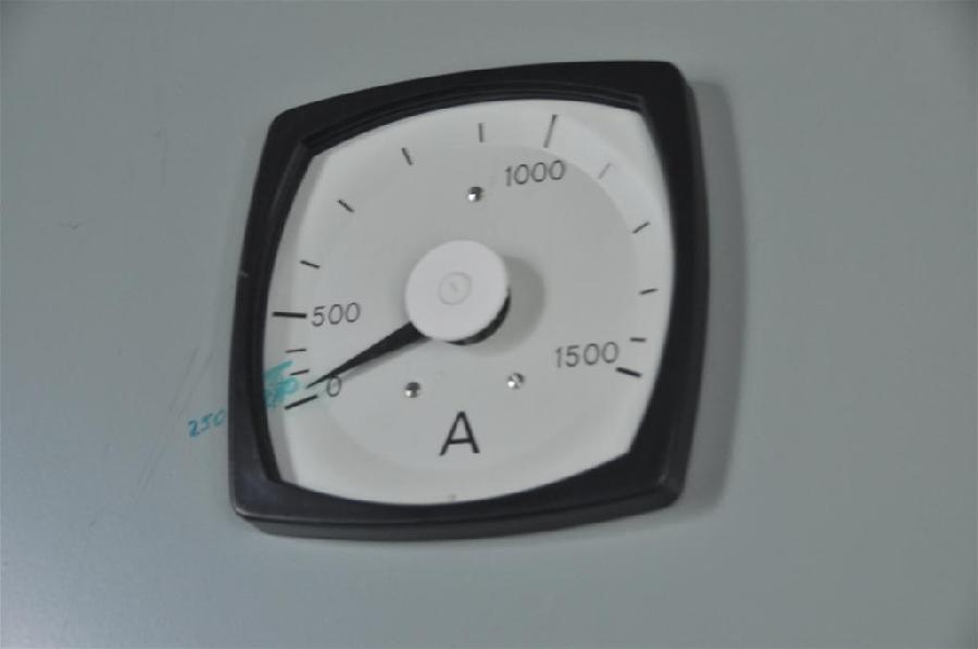

There used to be a coal fired power station across the water from me - Yelland Power Station. In closed down in 1985 after 30 years service. The power station had two outputs, via transformers, feeding 33kv into a long busbar set approximately 40m long. This then fed out to the various local distribution points. The substation was demolished, but the switch room retained, and up until 2001 was still live and working as a switch room (less the input from the power station. It has now all been moved to kit in an external substation with 132kv feeders, and the building is just derelict, slowly being stripped, and is subject to several planning arguments.
Some pics from the decommissioned switch gear. Pics taken mainly in the dark, so pics not too great (I was new to my camera at the time!)
