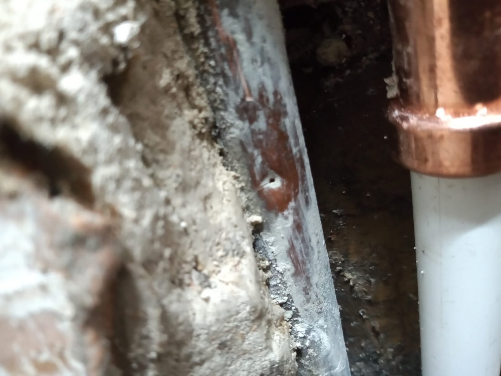

I just have seen this pinhole or nick in the pipe - it was covered with dirt and only after cleaning it did I see it. It's not leaking, the plumber repaired the actual leak in the adjacent pipe - what is the best way to repair this and explain what this is?

Is that pipe redundant ? If it's water carrying it would be leaking unless it's something like an overflow ,or pressure relief pipe.
What is it buried or surrounded in , seems to be corrosive ?
It's hot water pipe I think, the other pipe was just repaired today. It's not leaking but I suspect it will?
Can it be repaired with some compound?
I suspect it is perforated right through it certainly looks like you could put a sewing needle right in.
It would if there was water in the pipe under pressure.
Various ways to repair ,but the pipe needs exposing more and cleaning up.
I would just clean the area thoroughly, with some wire wool, or sand paper, to get it back to bare clean copper, apply some aggressive flux, and solder over the hole. Forget other botches.
