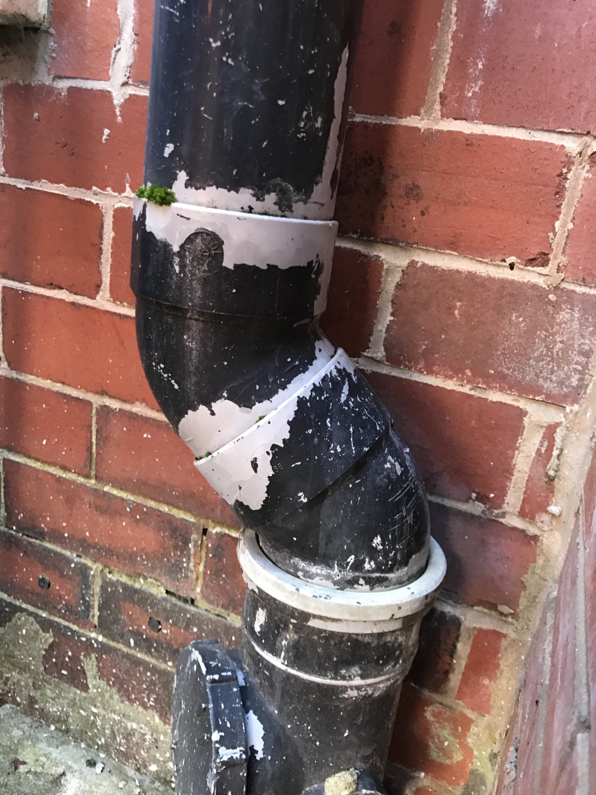

Anyone know what the offset distances when 1. A male 45 bend into a female 45 2. A male 45 in to a female elbow.
All 110mm
2 Osma Ringseal 45deg. bends used to be 4" Centre to Centre probably the same these days.
These glued ones look a bit less.
