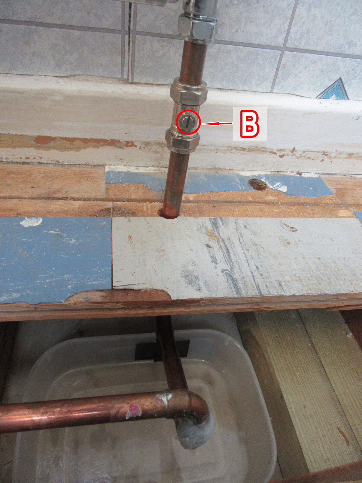

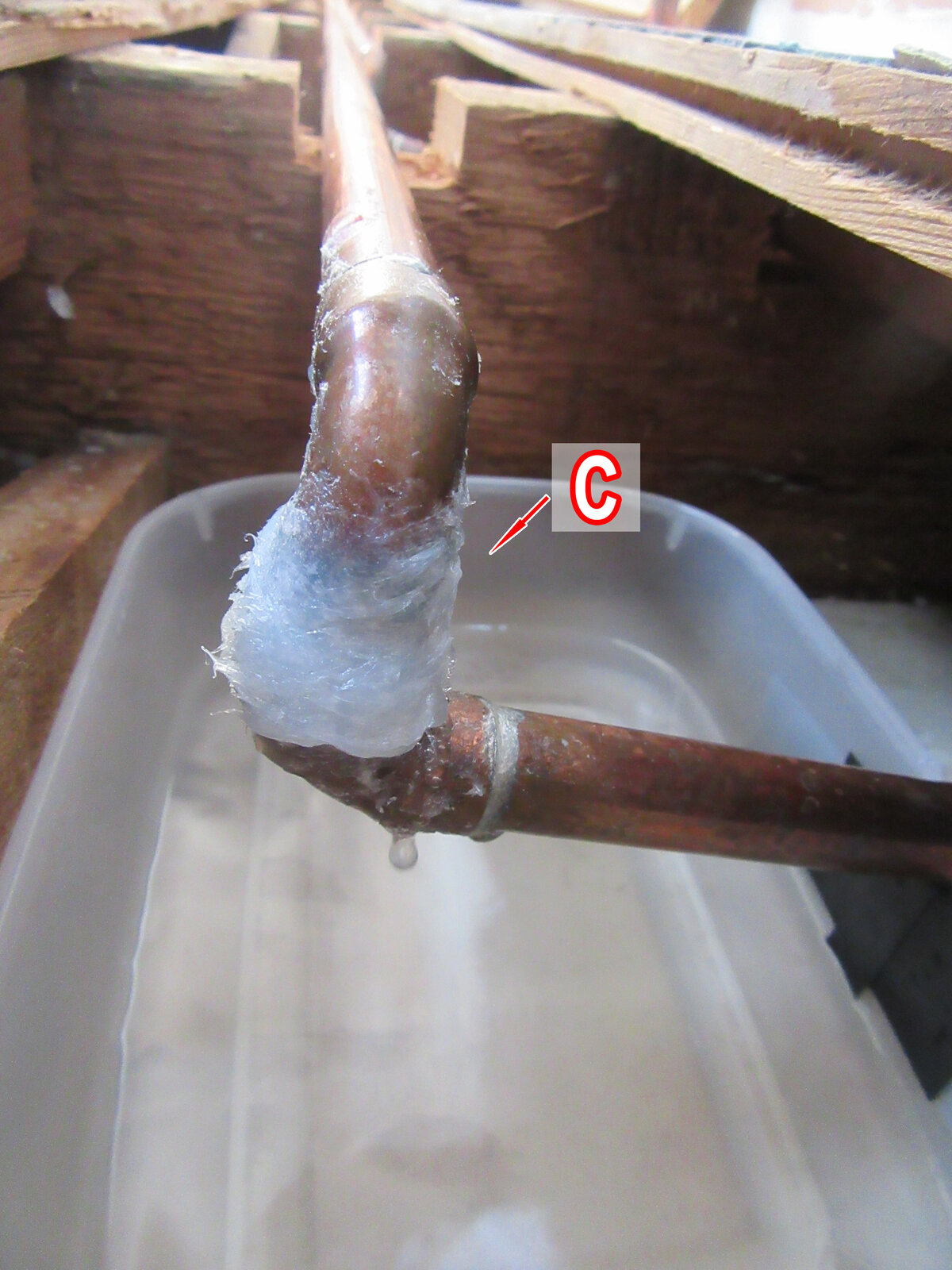

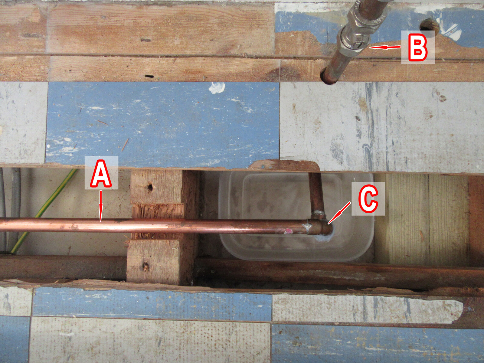

Apologies in advance if this has been answered previously. I'm in a bit of an urgent pickle with a copper pipe joint that was recently installed along with a whole central heating system. I can't get hold of the engineer to a fix a failed soldered joint and so am seeking some trusted help from you guys please.
The leak relates to the pipe that feeds a towel radiator in the bathroom and is located on a bend I think is called an elbow ?
See pictures please :
The leak is at Point ( C )
Please pardon the gunk that has been applied. It was late at night when we spotted water seeping through the ceiling and on inspection of under the floorboards found this area of pipe to be the problem and specifically the elbow joint at ( C ). And so I attempted to seal the leak for the night with this 'stop leak silicone' type paste called 'FERNOX LS-X LEAK SEALER'.
It didn't work needless to say.
Without lifting a whole load of other floorboards I can't really find where the pipe leads to in order to turn off the water to it and don't really want to turn off the mains. I'm unsure how having the water turned off will affect the central heating combi boiler.
So...
Can I...
1) Freeze point ( A ) with a cold spray ? to stop the water getting to point ( C )
(this would be to temporarily stop water flow in order to fix the leak at point ( C ).
2) Then turn the screw at point ( B ). Will that stop water coming back down from the radiator to point (C ) ?
3) With water then out of the elbow at point ( C ), I could then redo the solder of the joint ?
I hope that makes sense. What I said, not my plan.
Likely it makes no sense but that's why I need some advice.
Trying to get hold of a plumber right now I'm finding very hard.
Thank's - any advice much appreciated.
