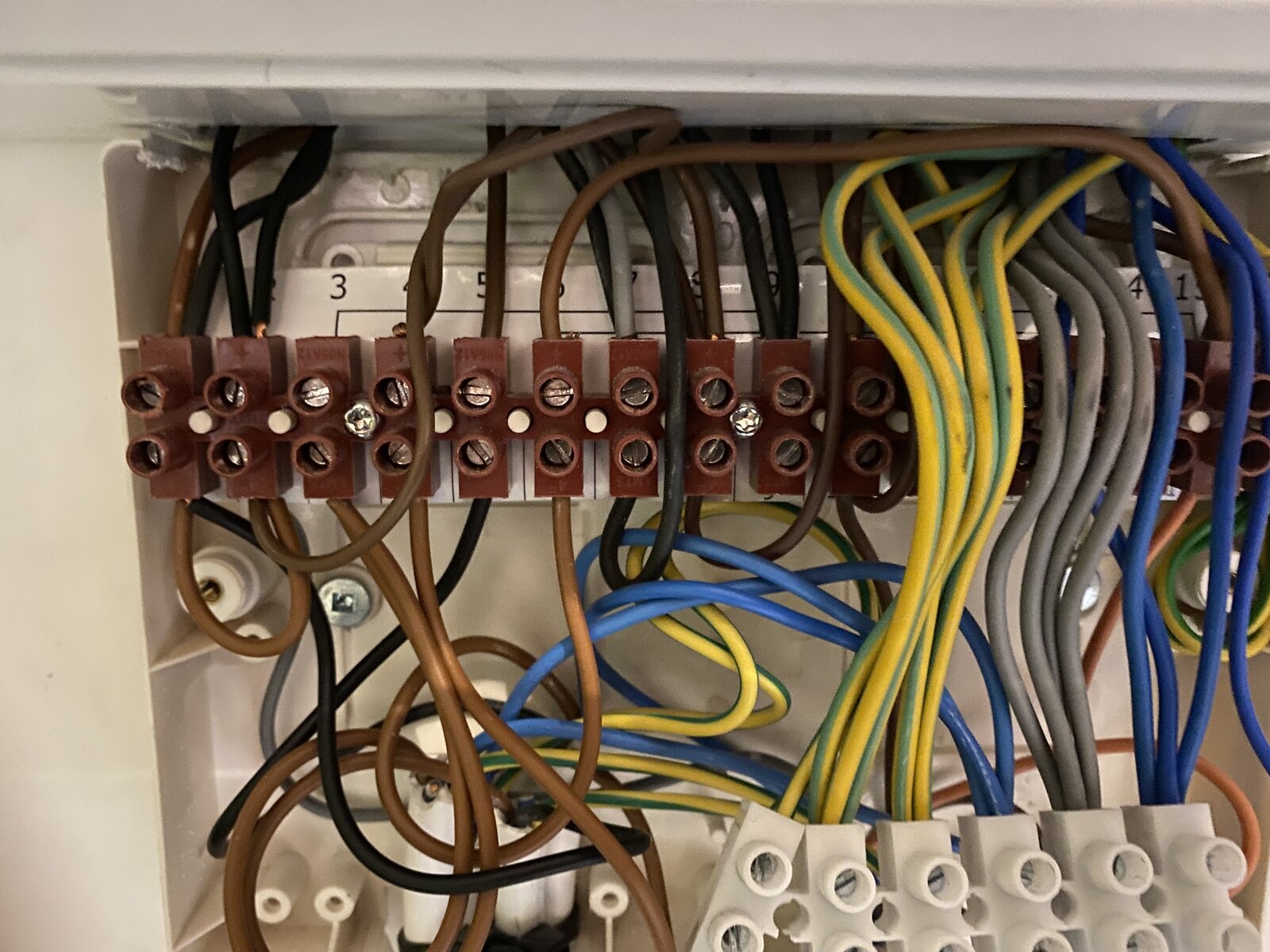

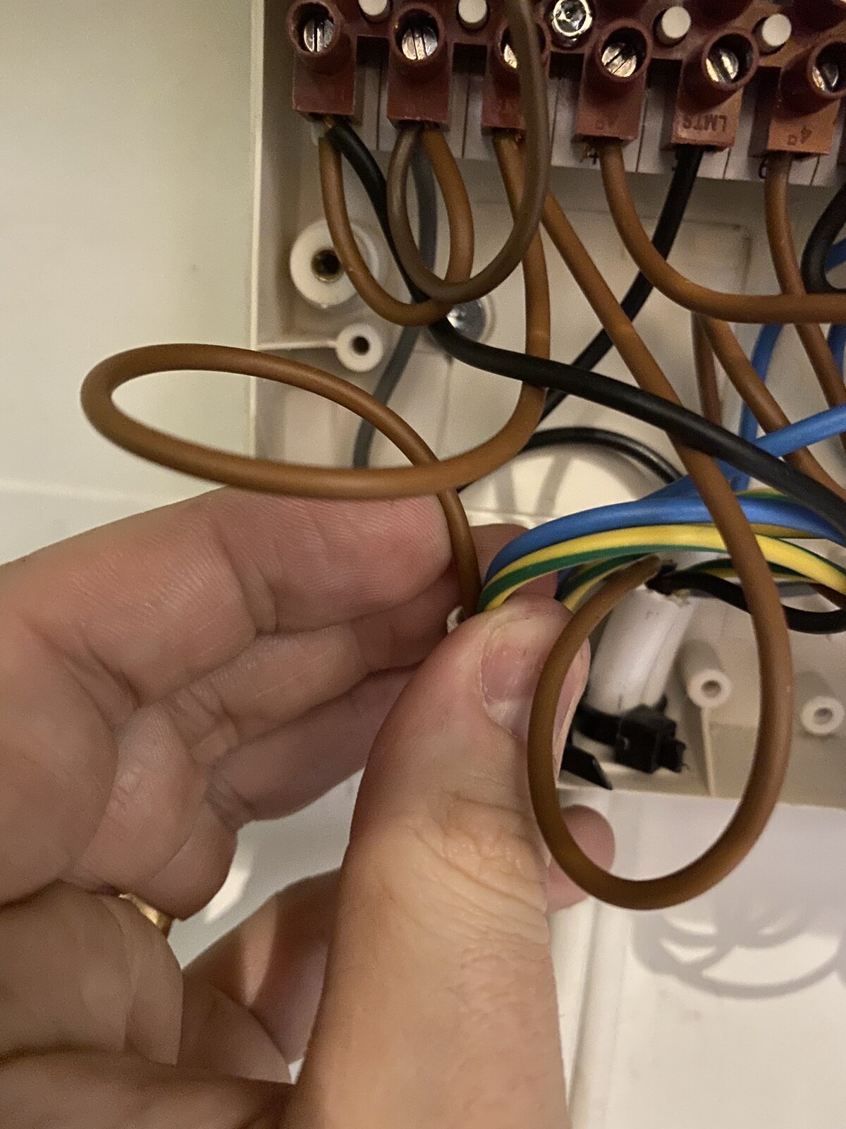

Hi I’ve a pipe stat connected to a danfoss wc4b control centre which then should fire a pump for my back boiler, stat is getting power from the controller but doesn’t seem to be sending a live to the pump. Any ideas I’ve attached photo of danfoss controller setup black cable on bottom of number 1 is the live to the stat and the pump and the stat brown lives are into number 3. Any help be very much appreciated

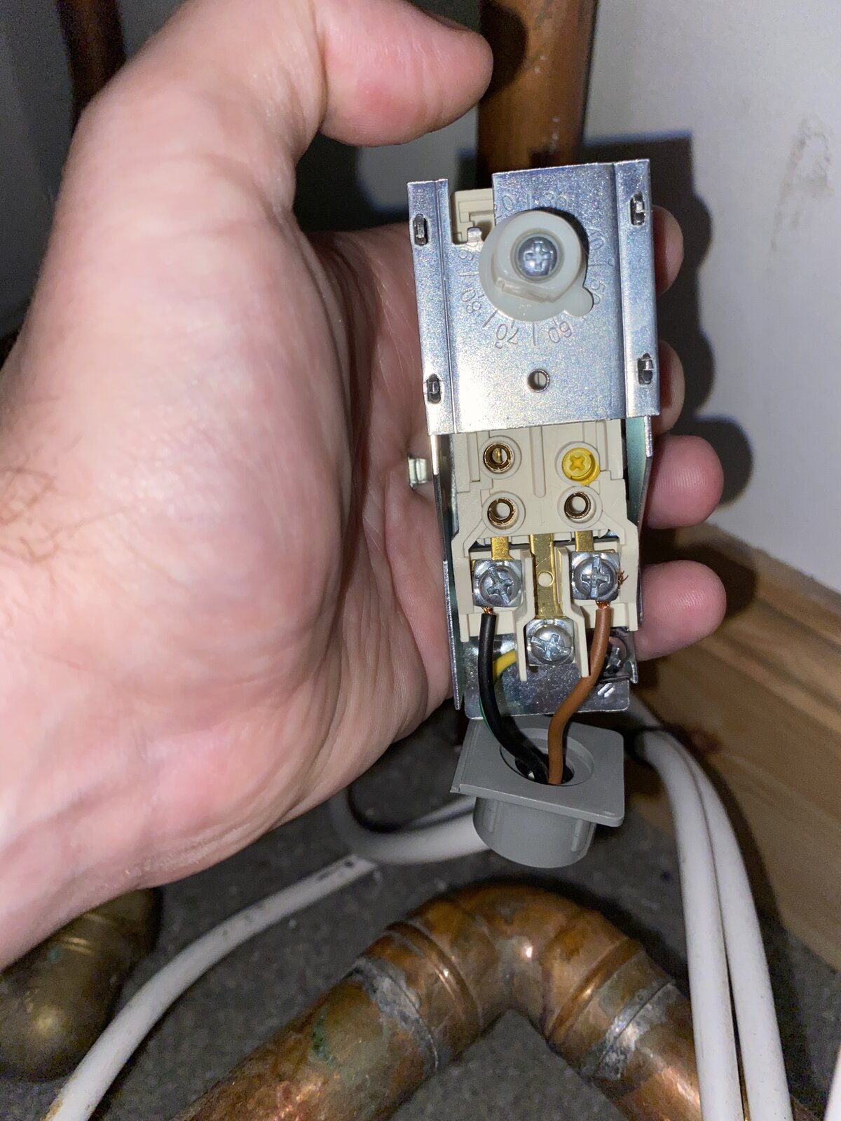

Picture of said stat showing how its wired would be
Hi apologies I’m not at home and know a pic on inside stat would be helpful as far as I can remember the black wire is on the left
Hand side and brown is far right I’ve a pic of outside of stat but will post inside as soon as I can tomorrow am

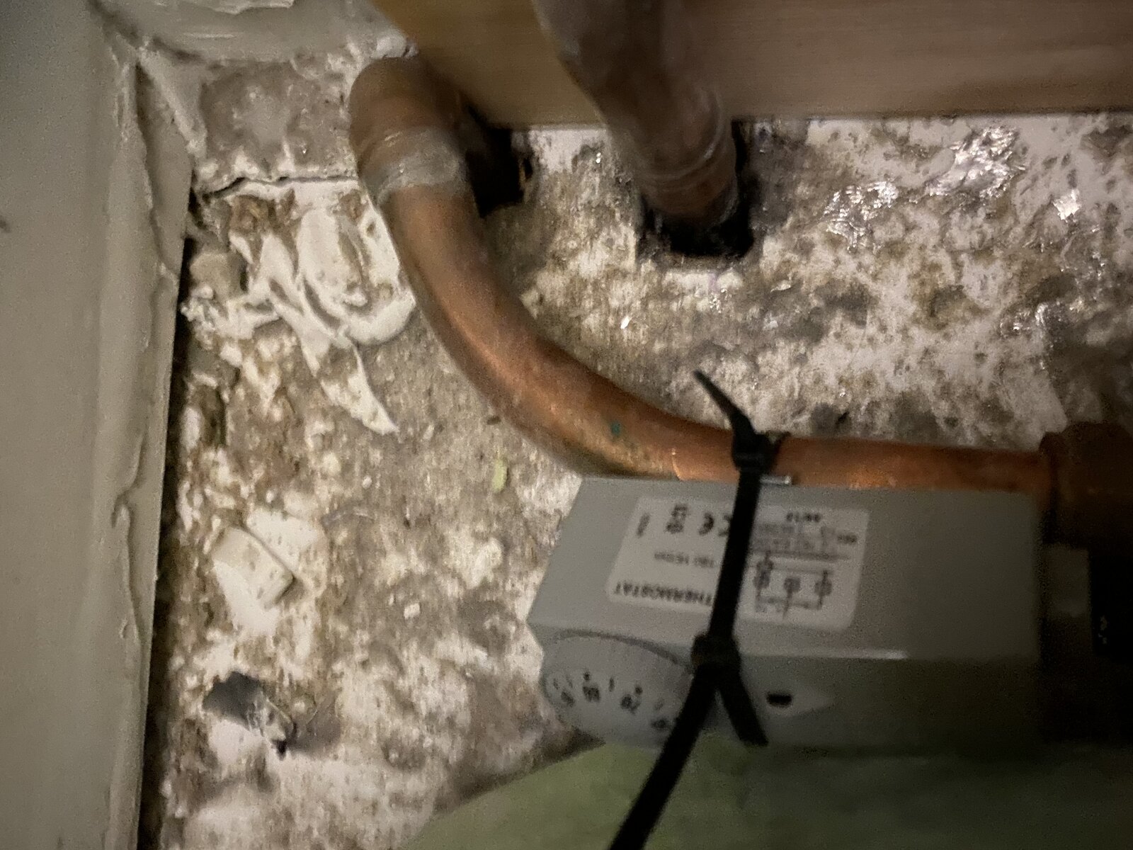

Here’s the stt

Hi there is power to the stat, the stat is attached on the stove return pipe which gets hot, the stat will click in and out at correct temps, the pump doesn’t get any power at all, it’s working as when connected to central heating pump power it powers up, but the stat doesn’t seem to be firing the live to the pump when it should be. The black wire in the stat is the one with mains and the brown goes back to the danfoss controller into the bottom of number 3which the live for the pump is also connected

Maybe i am going nuts but #3 connector is empty?
I assume this system has been working fine and that you haven't changed anything? If so, something has broken or failed.
If not, and you've changed something, then get an electrician in to sort it for you.
Could be loose wire has arced out in the conn box. Hard to say really.
#3 being empty when you say its a pump live is odd......
Edit: #3 has two in the bottom. (Hard to see on the photo :) )
Edit #2: Have you checked that 240v is being switched through the stat?

It’s a new build house horrendous issues with contractor hence having to sort any issues out myself, the pump has never been required as no fire ever lit until recently. The two browns in bottom of number 3 one comes from stat and the other goes to the live connection to the pump, haven’t checked that 240 is being switched have an electrician booked to come have a look but thought if it was something straight forward coulda sorted myself

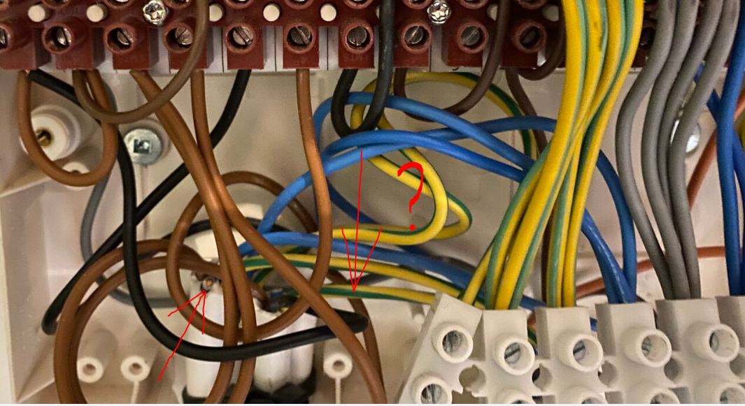

Oh dear, well first thing electrician will do is rewire that stat with 3 core and earth.
It already has 3 core + E - hence the Brown and Black - which makes it even dafter.
So, where is the green/yellow wire connected at the other end?
If it has been connected to an earth terminal then it can be expected there has been a short which might have damaged the thermostat.
EDIT - Picture altered from original which had the wrong g/y arrowed - see later post.

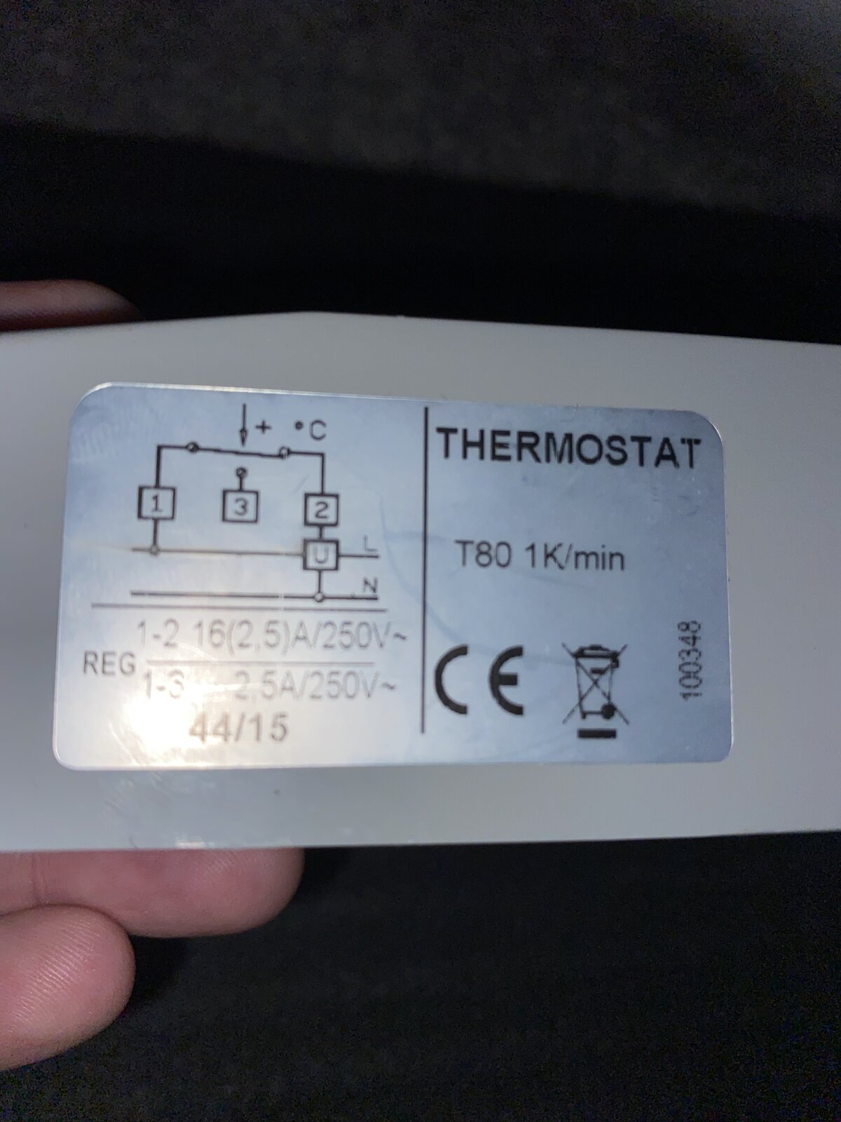

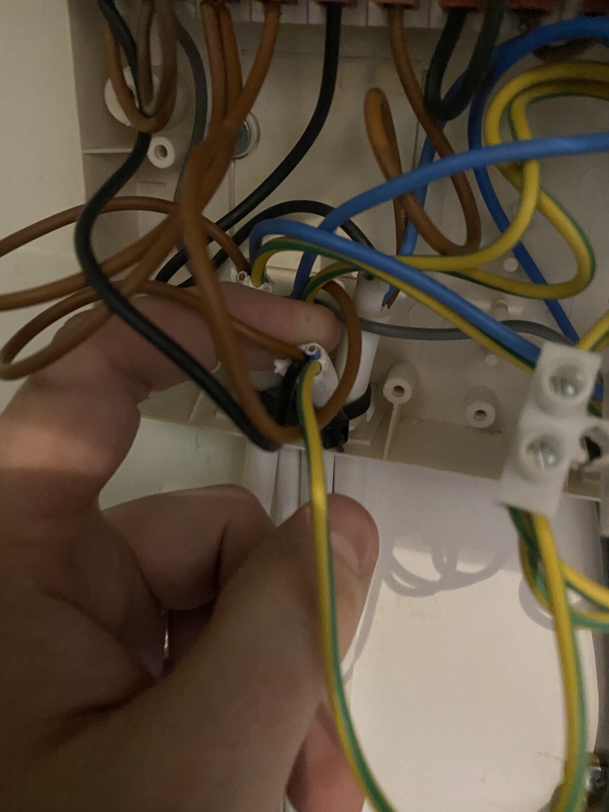

Hi thanks for the reply the earth is attached to the bottom right hand side of the stat. the black wire which is cut is the cable for the pump the only connections it has is brown,blue and earth. I’ve attached couple better images the first is the pumps cable and the second is the stat connection the neutral is not connected on either end of the stat thanks
