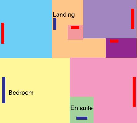

Not sure if this makes things any clearer, but the positioning of the radiators.
I haven't drawn all the downstairs rooms as all the radiators work apart from that single Living Room one.
Red is working, Blue is not working.
What happens to the rads that aren't working if you turn off some or all of the working ones?
You could try removing one of the nonworking rads and rigging a draining system to the valves and run water through it, do both valves individually and leave it running for a while. If you just open the valve, water discharges, turn it off, it might give you a false impression of being ok.

You can check whether a pipe is kinked by removing a non-functioning rad, then checking the discharge rate from each valve in turn, catching the discharged water in a bucket (then putting the water back into the header tank to preserve the expensive chemicals). A kinked pipe will exhibit high initial flow, immediately dropping to almost zero flow. Check each pipe in turn BUT MAKE SURE ALL OF THE OTHER RADS ARE TURNED FULLY OFF AND THE HEATING SYSTEM IS OFF TOO.
A single kinked pipe will show a low flow to ONE END of each rad it feeds.
