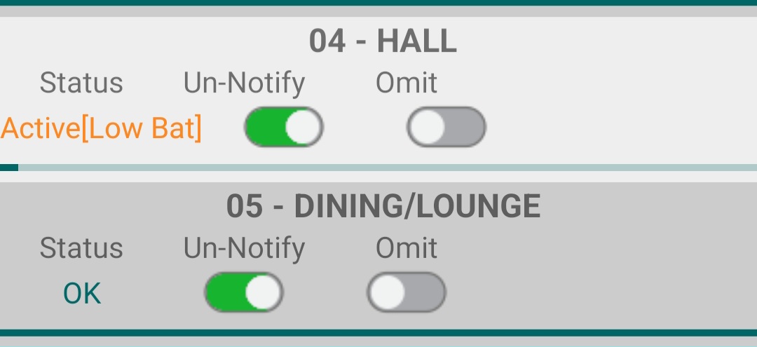

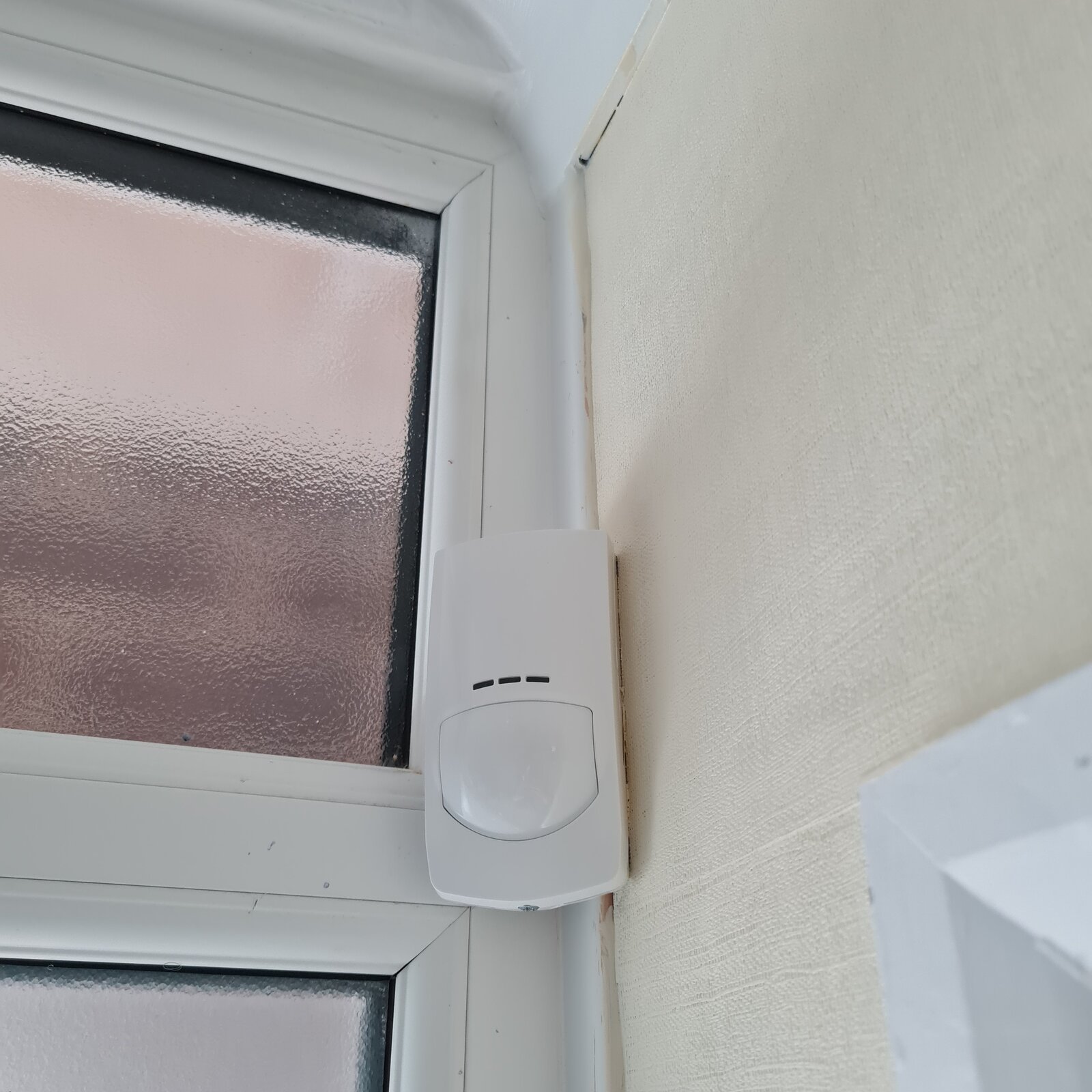

Thanks for the response. I've added a couple of photos.
The low batt warning has appeared in the last day or two, I suspect because the PIR is firing up all the time.
No tamper alarms/codes to clear either, when I watch it on the app it flicks rapidly between "OK" and "ACTIVE" every few seconds.

Interesting position for a pir, not recommended to have a PIR on a window frame or door frame.
Thanks for that. I'll give it a go.
Out of interest, can low batteries cause a sensor to constantly flag as active (thinking like a smoke detector, to prompt you to change the batt?)
New battery fixed it right up. Will still have a think for a new position. Cheers for the help!
potentially yes they could, Orisec gives you a battery warning when low but its possible to check the voltage of the batteries on the Orisec systems.
