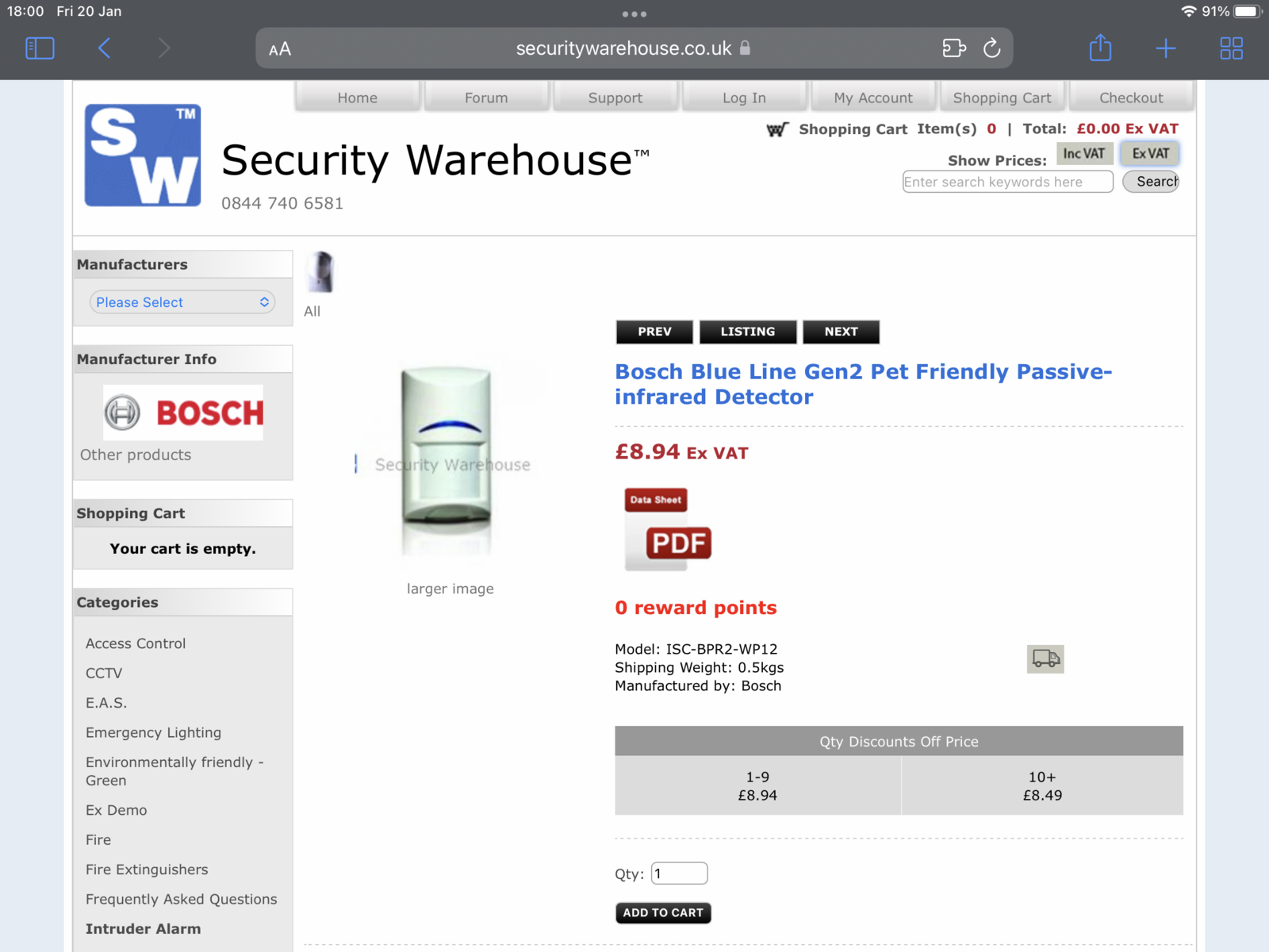

I have self-installed a Texecom Prem Elite 64W with a wired expander. I absolutely love the system and find it very versatile, however I have an issue with the wired Capture 15 (AKB-0001) PIR's.
We have 2 cats who have 24/7 access between indoors and outside through a cat flap in the kitchen, this then gives them access to the hallway and landing as there is no door to stop them. With the PIR in pet mode the cats are never picked up and we haven’t had any false alarms, great! however they don't pick up people very often either.
We can walk downstairs in the morning and the hallway PIR won't pick you up as you walk through and start the keypad Beeping to remind you to unset the alarm and then after you are in the kitchen for a little while the kitchen PIR will pick you up and set the alarm off. The PIR's in the rest of the house and external buildings which are not in pet mode work great and pick you up as soon as you enter the room.

A neighbour was plagued by small dog false alarms, Eventually a break beam detector was fitted in place for the problematic PIR and since then no more false alarms from the room.
Bosch pet detectors or RX 40 ( this is been phased out ) ….please note you can’t have pet detectors facing stairs as it will false alarm
Thanks for the response. The PIR's can't see the stairs. I will have a look into these 2 PIR's you have recommended, would you preference one over the other?
More likely to get hold of the Bosch ones , both have been fine

Cats are more likely to cause false alarms as the jump and climb, our two certainly do.
We always recommend that animals are limited to an area/room in the house if they are staying in or allowed outside.
Perimeter protection is essential to cover that room especially if its low down or easy access.
With PIRs facing the stairs, is the pet gets above the 1.2M threshold of the pet sensor and triggers the alarm.
Because the sensors are blocking out what it sees people can be missed. they wont miss me mind due to my size.
Are the sensors at the right height and flat to the wall.
You can attempt to adjust the pet screen in the PIRs I guess, not tried this but it may in effect allow a little more human detection and would be interested in the results.
I suspect you will find if you take off the pet side of the p15s that they will pick you up okay.
I vaguely recall some issues maybe 12 months or so back regarding the P15s as they stopped providing them for a while (think it may have been component supply issues mind) and replaced in the kits with the Q20, these also had Pet option.
You may want to ask Texecom, directly or ask on their forum for clarification on that one.
