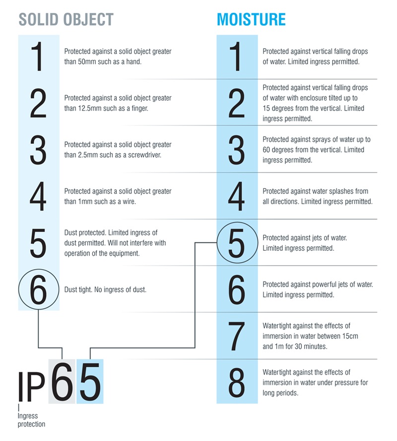

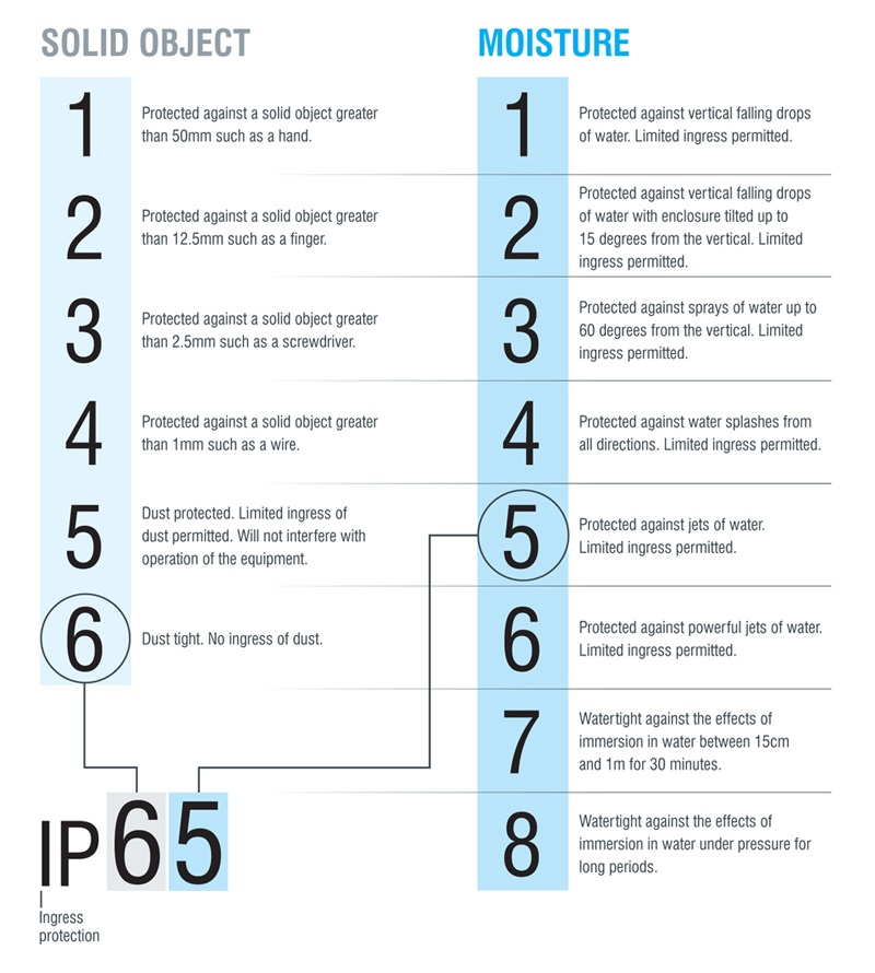

One last question, do you think given the intended use (i.e. outdoors with full exposure to the elements) IP 44 is enough if a good make is used ?
cheers!
IP44 is good enough for rain but not for being hosed down.
http://www.steinel.de/en/Motion-Det.../Infrared-motion-detector-IS-180-2-Black.html
is IP54 which provides protection against dust and insects getting into the sensor.
