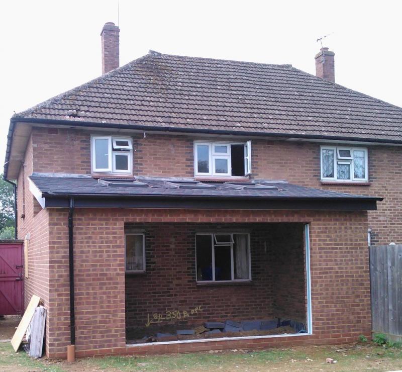

My builder hasn't tiled the sections of our new pitched roof extension that sit beneath the windows of the existing house. He said the pitch of the roof would not allow for tiles and flashing so we're left with what I presume is the membrane exposed. Is this normal or will it result in leaks in years to come?
The flat roofs below the windows have been finished in mineral cap sheet!
The detailing at the verges and tiling look very untidy.
As above.

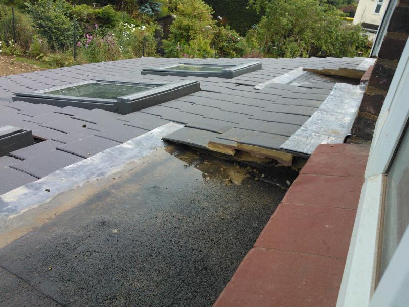

The untidy tiling appears to have run into trouble between the Velux frames - has it lost its bonding? And whats happened where the tile meets the main house wall - one gigantic leap disguised by a wide cover flashing?
You will have leaks in no time, and when winter snow builds up, the water will pour in - surely BCO hasn't approved of any initial drawing or the work in-situ?
You could strip the upper tile down to the change of pitch/lead flashing line. And then re-lay new tile across the roof, in a tile designed for the low pitch from below the cills to a continuous flashing line where the pitch would change. google pics for Mansard roof.

What did BC say when they did their mandatory roof inspection? Surely it was obvious at that point that you were going to have this problem and it should have been pointed out. Did use an architect? Did he specify this construction? I assume you are building off a notice as opposed to full plan submission as this would surely have been questioned before a spade went in the ground. I wouldn't be happy with this and would want the roof redone properly at the expense of whoever is responsible for this clanger. If this is not possible then you have a couple of options to try to prevent ingress.
The cheapest option would be to address the problem specifically beneath the windows. You already have water pooling on there, this is bad, especially when it freezes and thaws. You must redo this so it incorporates the maximum fall you can achieve. Remove the felt and use finings or wedges to get your fall then board and membrane, flashed properly where possible and whatever you can achieve under the window sill, flashing tape, silicone etc.
you need eaves protection on each of the 'gable ends' around your windows just as you do on the eaves of your extension, you could frame it and use cement board under your tiles for a mortar bed and UPvc cladding at the sides with your membrane flashing under the cladding.
Another option is to do away entirely with the roof where the pitch ends and have it done as a flat roof from that point, membrane, flashing etc.
Replacing your upstairs windows, adding a couple of courses of bricks to raise your sill height is an option...
It's hard to tell how much lap you have on your flashing at your transition but it doesn't appear to be enough, perhaps get this checked?
As I said at the start I wouldn't be happy with any of those options and would have the entire roof redone, the pitch you will be left with may be too shallow for tiles, I don't know, in which case a major rethink is in order.
Also, it might be my eyes but do you have engineering bricks up to dpc?

Thanks for all your comments. The builder did say that the tiles between the velux windows had to be sloped inwards, to allow water to drain away from the frames. In terms of the wall construction, I can confirm that engineering bricks were used, up to DPC.
BC have done their initial inspection but admitted that they only looked at the internal section of the roof and would take a look at the external work as part of their next inspection.
We were originally going to have a 3m wide structure, with a full pitched roof and instructed a draughtsman to produce drawings accordingly, we didn’t use an architect. We then decided to increase the width of the extension to 3m internally, bringing the overall structure to 3.5m. Drawings were amended, submitted to planning and we received permission. It has only just been pointed out to me that a fully pitched roof cannot not be achieved on a 3.5m structure but our draughtsman failed to highlight this on the revised drawings. Therefore the builder has had to install a flat roof protruding 0.5m from the house, before sloping it down to a 15’ pitch.

Ideally the simplest solution would be to do it in lead though the fall needs addressing as its pooling at present and a lead worker needs to be employed to do it not your butcher, ahem builder! However that said this may not work either as we don’t know the height from the flat bit to the cill, presumably FA! Some more photos looking towards the windows would be helpful. I wouldn’t rely on BC reprimanding the builder, they may do but maybe not.

What i suggested is perfectly possible but will require demolishing the upper pitched roof areas and rebuilding a new pitched roof to whatever falls are avilable.
As above, it could be done in lead (but think cost and theft), synthetic cap sheets or tiles suitable for that pitch.
All thats needed is someone to pay for it - if you attempt to codge this in you will be paying much more down the road.
