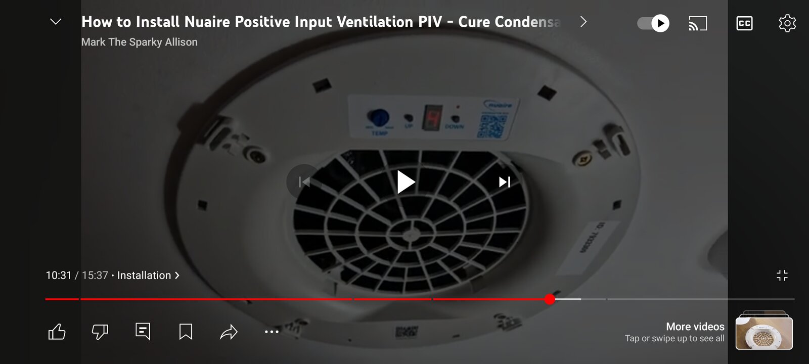

Which brand do you have? The nuaire ones seem to have different speeds. Surely you would need a different speed for a large property compared to a small 2 bed house for example.
You set the speed at at installation. Larger property = higher speed.
Exactly this, and then leave it alone for the next 5 years until the filters need changing.

Nuaire Drimaster Eco has controls under the diffuser, accessible from the landing...
