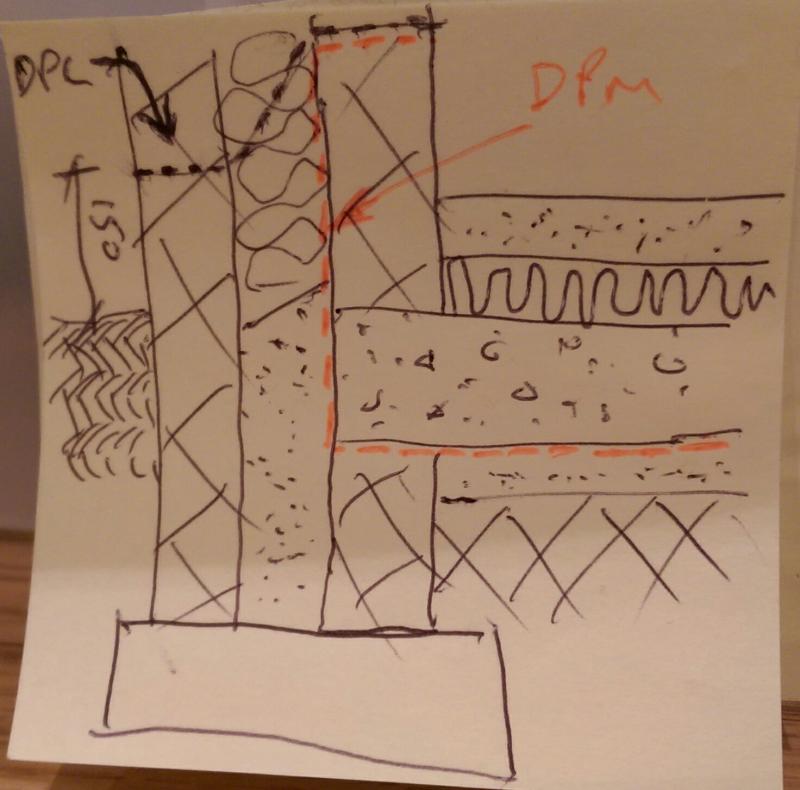

I was wondering if this would be OK, and if it would get passed the building inspector
The idea is to run the DPM through the inner leaf, and into the cavity. I would then lap the DPM up the inside of the outer cavity wall and then use concrete infill above and below the DPM inside the cavity up to the height of the finished floor level.

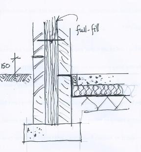

That picture is the 'oversite' i.e. build up of the floor inside the new extension and doesnt really address what I thought you were talking about.
If the ground where the floor of the new extension is going to be is at the same level as your existing floor then it will need to be dug out to the depth of the oversite. So measure your type 1 (hardcore), sand blinding, slab, insulation, screed and whatever flooring your are having and dig down that much from where finished floor level will be.

I would do that - but sadly it wouldn't be possible. There is a drive way running up one side of the proposed extension. I cant dig that out as there would be a step in the top third of the drive.
In my idea, the DPC on the external leaf would be 150 mm above the outside ground level. The issue would be that the DPM would run up the middle of the cavity rather than on the inside of the wall. I think it would work, just dont know if the building inspector would agree.

That would not be acceptable.
Assuming you have a cavity wall, then rain getting in through the outer skin - which it will do - will run down and be directed to the inner skin by your upturned dpm.
If you have a normal cavity wall, it will not matter that your outer dpc is higher than the inner. Those diagrams in Approved Doc. C are really just conceptual rather than practical construction details.

I dunno what the problem is, it's a very typical situation, you just lap the dpm from under the slab up the outer face of the inner skin and tuck it in under the stepped dpc, I did a 2 minute doodle to show you, this drawing would put tony to shame.
you're a bloody legend Freddy - I owe u a few beers.
I knew there would be a simple solution, but just couldn't see it.
Thanks man
And Tony, you too buddy. Cant thank you enough - seriously, this was doing my head in. Tony in your picture, when you refer to full fill what do u refer to filling the cavity with and to what height? Whats that horizontal line that bridges the cavity above the dpc?
