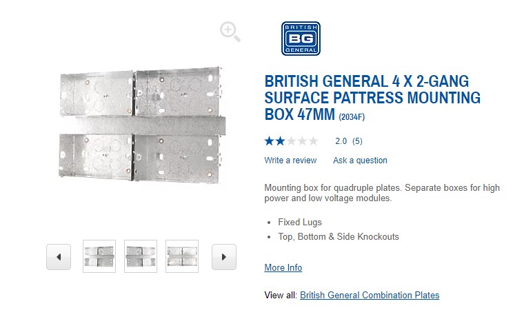

Hi, I have a solid wall as well and not planning a stud media wall at the moment. Has anyone fitted a back box like this meeting the above at the same time.
Horizontal chases are only allowed to be one sixth the thickness of the brick; one third vertical.
That is for a 4" brick - 17mm and 34mm.
It's 47mm deep, minus plaster, that's taking some 30mm off 4 bricks. Or do you suggest a few separate sockets spaced out?
