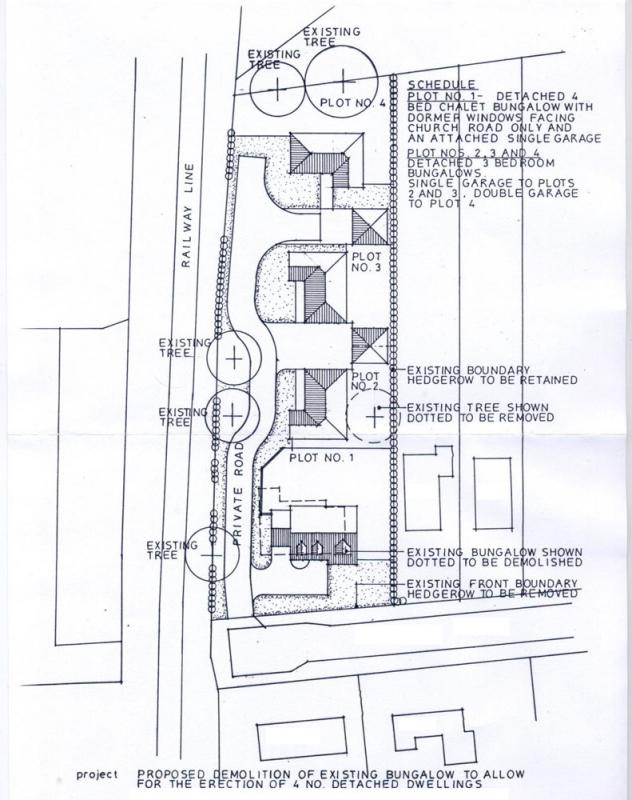

Initially we had an architect draw up plans (plans_01) to demolish the place we live in and put four new dwellings here, a dorma at the front with three bungalows to the rear. The council had two main issues with this, the first rear bungalow was close to the bungalow next door and because the plot was over .2 of a hectare the rules stipulated that 40% of what we put on here should be affordable housing. It seemed to us that having to provide affordable on such a small site was not fair. I can see that if you are building ten properties then there would be scope for having two that were affordable but to have one or two out of four just seemed unfair.
The place we live in is a large 1920’s bungalow in need of complete renovation, wiring, heating etc. The blank slate approach seemed attractive although obviously by knocking it down we would be losing the value in the place. If we had to forgo one of the bungalows at the back and provide affordable housing it just didn’t stack up. We are no serial developers and still have a substantial mortgage left to pay. This was never going to be a kings ransom we just want to do the best with what we have here.

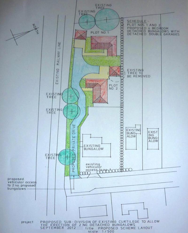

So last year we had new plans drawn up (plans_02). This time we kept the bungalow we’re in, this made the development plot smaller and took us out of the affordable requirement. We also had just two at the back pushed further down the garden acknowledging the councils issue with the proximity to next door.
We were surprised when the council came back to us that they would favour just one at the rear. The reasons they gave for this was…
‘…the two plots at the rear appear to have limited amenity space which would be detrimental to the potential occupiers of the site and also increase residential activity on the site to a level that would undermine the amenity of existing neighbouring properties. It is likely that any development over and above an additional single dwelling would raise unacceptable issues.’
I struggle with this, firstly, new properties tend to have very small gardens and the gardens here are larger than most. Secondly, both dwellings seem a reasonable distance from the next door neighbour and even further from neighbours at the bottom of the garden.
I would kindly like to ask people in this community for their views. In the current climate of a housing shortfall I thought the authorities wanted more housing. We have significantly reduced the concentration of dwellings from our first set of plans but the council still have objections.
If we were to go ahead despite the councils view we are unlikely to succeed. If this were the case would we stand a good chance at appeal? Would the appeal committee apply a more national view that we need the housing and that compared to many around the country and indeed within our local community this level of concentration is not unreasonable?

Amenity space, site layout, design etc. should ideally be in accordance with the local plan. If it is, then the local authority could not justify a refusal. If it is not, then it will be down to negotiation. On appeal the inspector will take the local plan into consideration and also the local planners report. But they are not bound by any of that and if they think the development is reasonable they can allow it despite what the local planners think.

As Jeds said, to do this you should (or your architect should have) consulted with the councils Local Development Framework. Within this, or the supplementary documentation, they should be able to set out some information that will help you determine things like how big they expect gardens to be, or minimum sizes / areas for rooms and buildings etc. be aware that this can vary from place to place so if your architect is used ot designing properties for one location then he may have just been going on experience without looking for this information.
One thing you should be aware of is that the council may be trying to dissuade you with their advice in order to minimise the development. I often find that officers will try to get developments reduced prior to an application because they may not be able to justify refusing it as it stands. The only way to find out is to assess the proposals against the LDF for yourself... if you can effectively tick all the boxes then you will be in a good position come the application stage, and if the application is refused then you will have a strong appeal case.
Other than that, it is difficult for me to assess the proposals in more detail as it's hard to make out scales on the pictures of what appear to be hand drawn plans! (haven't seen that in a while!)
I would comment that the houses themselves appear to be as large as the space around them - and significantly larger than the houses nearby. This may be a concern for planning because the development is not characteristic of the area. These sorts of "qualitative" concerns are the sorts of things that can be more effectively negotiated as opposed to the "quantitative" issues of size restrictions etc.

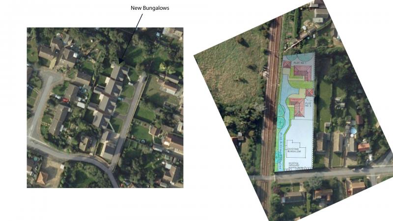

I have uploaded an image that shows a development of five bungalows not 200m from our property that were built within the last ten years. These are significantly more concentrated in regards to each other and the existing properties around them. Our proposal is shown at the same scale. Is there something different about the two plots that would make one more reasonable than the other? both are backland development. We have the railway bordering which I would think would benefit ours because we aren't hemmed in by neighbours unlike the other example.
I was dissapointed because we took on board what the council said in the first instance and eliminated the first property to the rear. For them to now have a problem with two when the other development is much closer to their existing neighbours doesn't seem fair.

There may be differences between the developments yes. For example, the nearby development has neighbouring properties, but they are all of similar plot and building sizes, therefore the development may have been considered to be in keeping with the character of that area.
However, the surrounding buildings of your locality may be characterised more by bungalows in large plots so the planners may want to try to preserve that character (which may be why they are trying to limit development to a single extra house as a way of maintaining the larger plots).
Your answers on this will hopefully be revealed once you manage to get through the councils LDF.
You should also make a note of when this document was published. Although the nearby development was completed within 10 years, a new LDF may have been published and this is likely to have changed the local authorities policies and stance on development.
As a final note on this bit; just because sub-standard developments may have been constructed in the past, does not mean that they should be permitted now.
