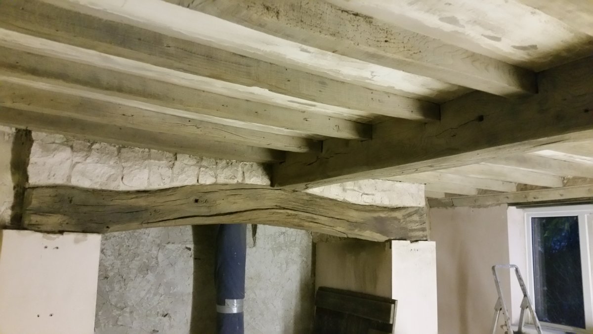

Plaster now or after oiling?
30 Jan 2017
14
Which comes first replastering the celin or oil the beams please.
Many thanks
I'd oil the beams first. Sometimes, water/wet plaster can stain untreated wood/timber, especially mahogany, oak etc. Oil the beams, couple of coats, then use some Frog Tape along the junction where the beam meets the ceiling. Do as much as you can to keep the beams clean.
