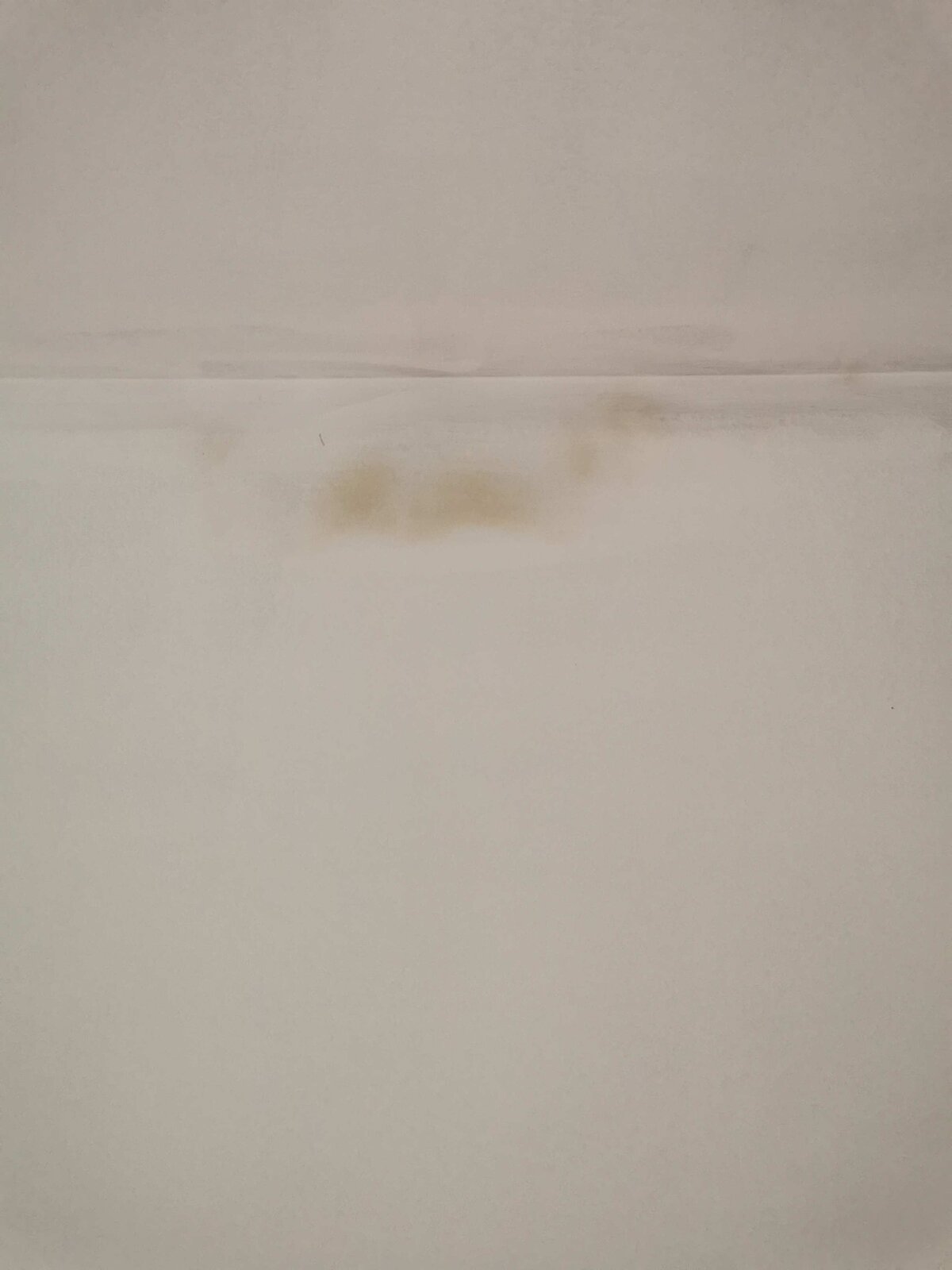

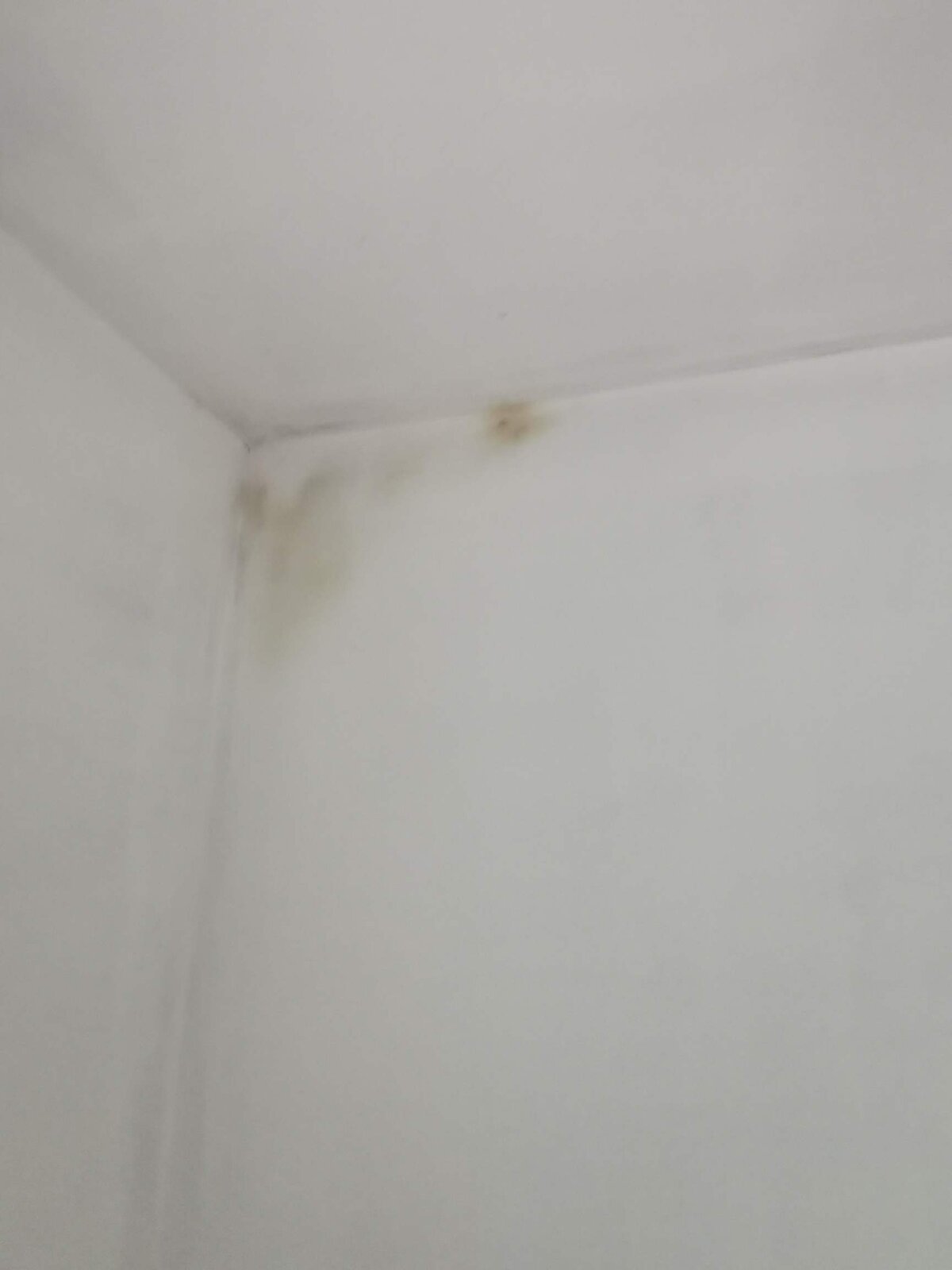

Recently had new room plastered. been left to to dry for 2-3 weeks - plaster pink and ready to be painted.
Did mist coat this weekend - and overnight noticed these random yellow/dull stains in random parts of the walls/celin. its in about 3 or 4 places overall in small patches.
The photos dont show its yellowness very well - but what could/would this be?
there is also no pipes nearby as suspected water issue but nope.
Any insight into what it may be - and maybe how to resolve? i keep reading about Stainblock - so likely head down this route but ideally like to know whats causing issue.
thanks

Looks like damp stains but obviously any entrapped water causes new plaster to dry differently which causes colour differences really if the marks were there before and it’s been reskimmed they probably just used pva instead of grit
Loft above?
Maybe no rockwool insulation along the edge and it's a cold spot. Condensation forums and mould then it stains
What do you mean when you say that it is a new room?
Old water stains can bleed through to re-skims.
Yellow stain is often water from a leak. In the position you show, it might be roof or gutter related. It may be an old leak that was later repaired.
What is above?
Please photograph from outside, and also the room or loft above

I had exact same patches. It was from a leak from a pipe that was under the bath tub and not visible from outside.
