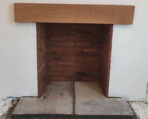

With the two vertical front edges of the brick slips not plastered over but left visible (see attached image), is a plaster stop bead used where the plaster and brick slips meet? If so, what sort of metal stop bead would be required?
Or perhaps edge of the brick slips left proud of the wall acts as a plaster stop?
