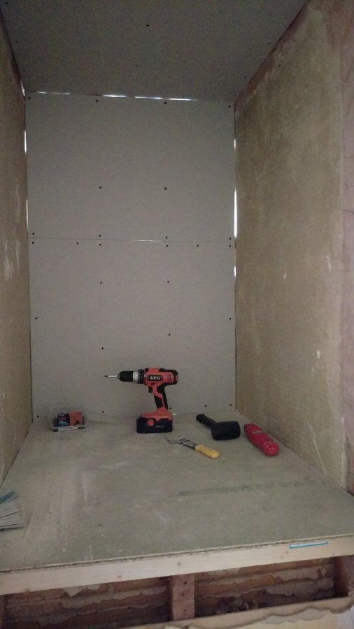

I have a section of ceiling in old airing cupboard to board. I have fitted 50mm celotex between the joists ( will also add 100mm roll on top when done)
I have my plasterboard ready ... But I was thinking... Should I be leaving a gap between the insulation and board? I also have small draughts coming from the gaps between the insulation and wall, I have tried to fill this with the roll insulation.
Should I also batten off the joists to make sure the new board sits below the tops of the walls? View media item 95439

Battened off the joists and actually started boarding today!
