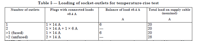

... and many of the tests specified for determining BS1363 compliance are written in a manner that clearly encompasses triple (or higher order) multiple sockets . For example, in relation to the temperature rise test, it says ...
Interestingly, there are many places where it makes reference to unfused sockets with >2 socket outlets, implying that such animals may be 'allowed' by BS1363 (something I didn't think was the case). For example, again in relation to the temp rise test, look atr the bottom row in this BS1363-2 Table ...
