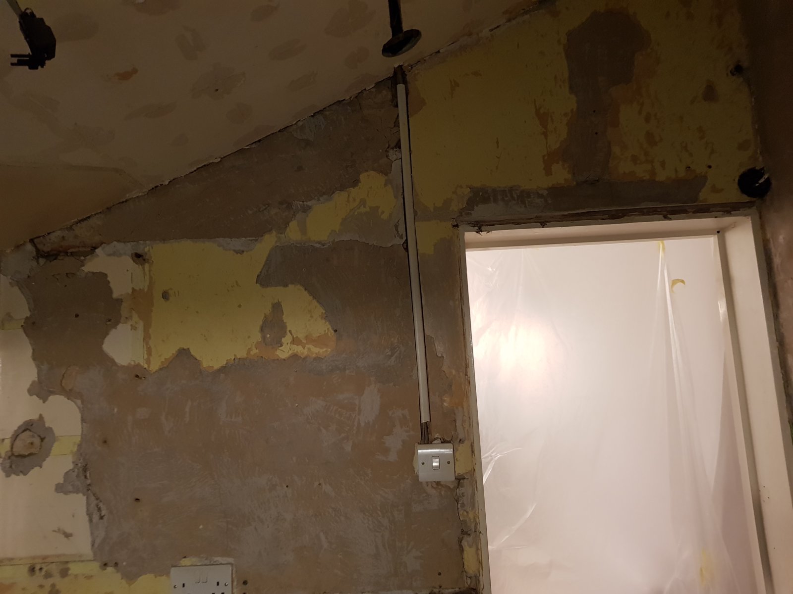

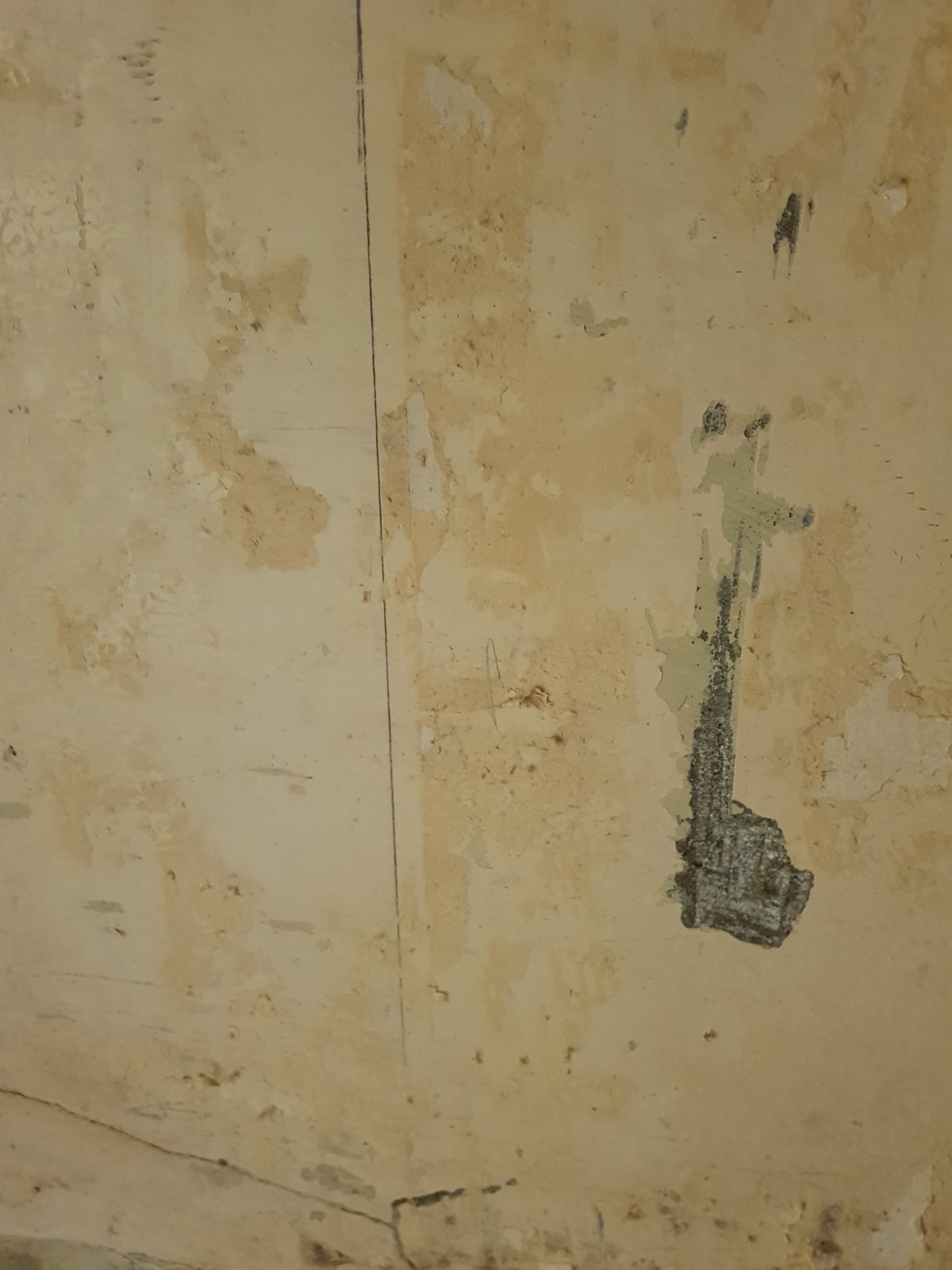

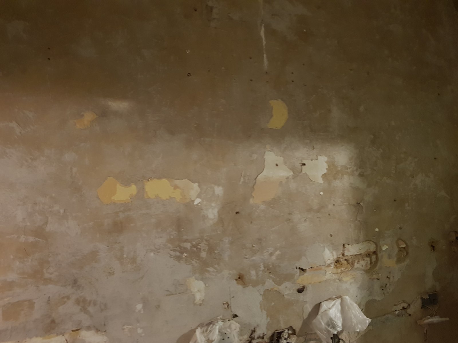

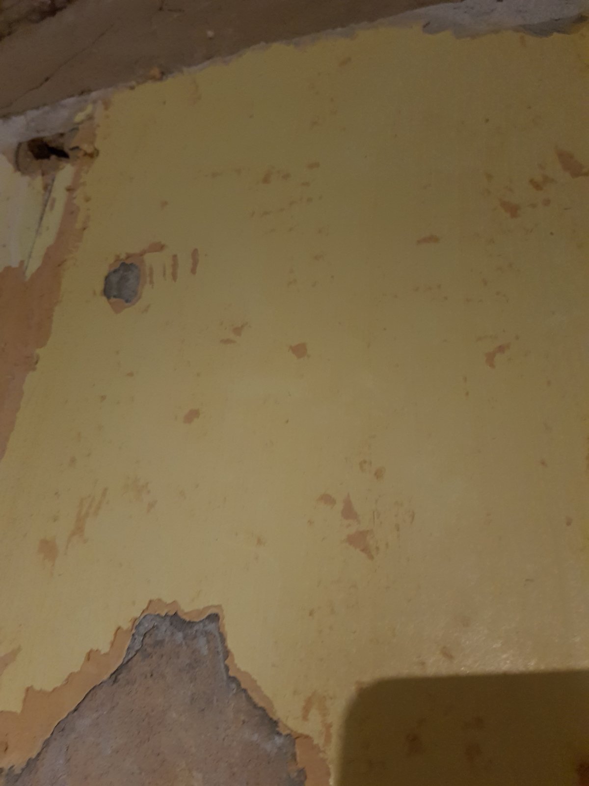

Hi.
I am having my kitchen plastered tomorrow and I've spent all weekend trying to get all the paper off the wall. It was a horrible green paint gloss over underlining paper under another sort of paper or paint. Really hard to tell. It wouldn't come off with a steamer or spray so I have had to hammer and chisel the whole four walls which has essentially broken me.
80% is off but some remains. I'm hoping it's paint rather than paper but the underneath to that does also tear like paper.
It needs to be plastered this week as I have a child due in two weeks time.
Is it OK?
Looks fine from here, your plasterer will advise when he comes as long as there is no paper or loose stuff your guy should be able to prep the rest with blue grit or similar.
