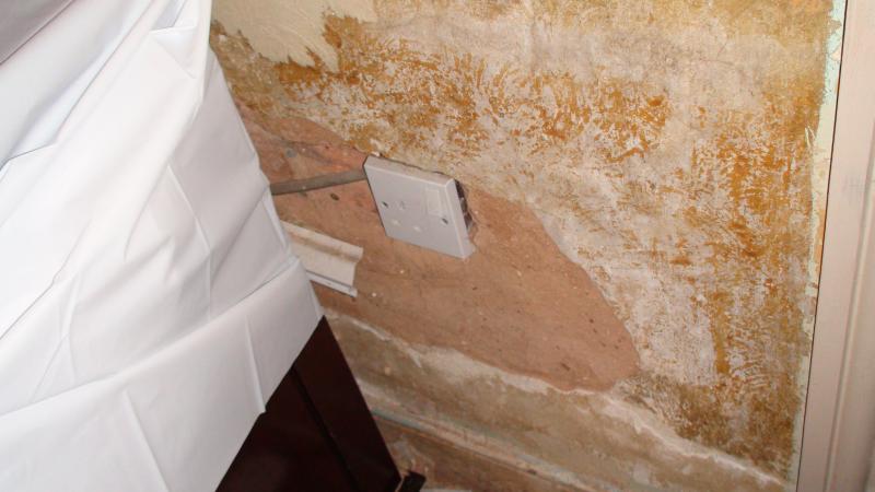

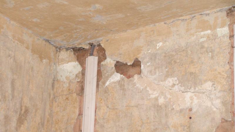

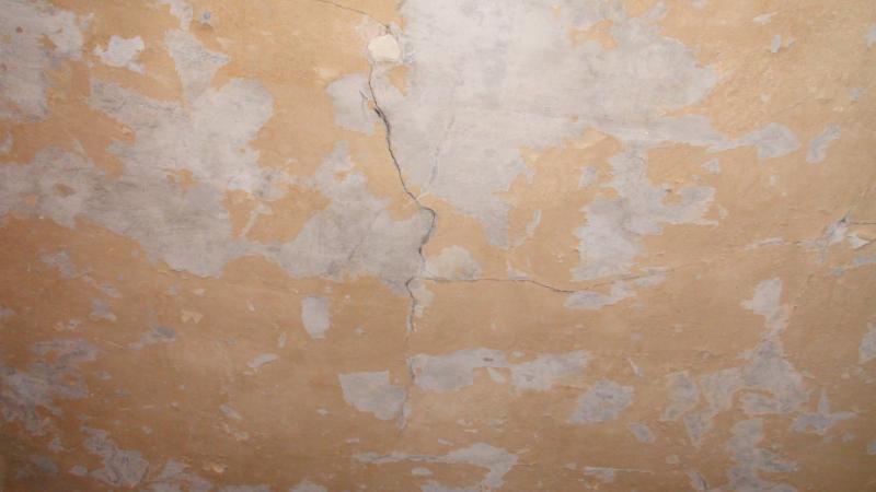

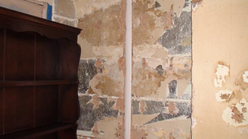

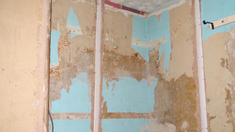

Hi - want to get some advice on a plastering job as have had several people say different things.
I have a 13ft x 13ft reception room in 1880s house. Ceiling has large cracks and one small section where plaster has come down. Walls are covered in cracks and in some places the plaster sounds hollow when tapped. One wall has some water damage below a window. All original plaster and looking rather worse for wear.
Also need the fireplace bricking up.
One guys suggested dry lining half the walls and skimming the other half, water-proof cement under window, overboarding ceiling, skimming whole room and replacing plastic electrical capping with metal = £980.
Second guy suggested getting all plaster hacked off by labourer (£180), then float and set walls and overboard and skim walls = 2 days and £900.
Third guy said fill in the cracks and gaps and skim only. Have had all the other rooms skimmed but the plaster was in MUCH better condition and I'm not convinced skimming will look goo in a few months.
Any advice? Am I being overcharged? I have never plastered myself and am not very skilled with DIY but could I dot and dab the walls myself?

I would have it all removed and then floated/boarded and set.
If you remove it yourself, that will save you labouring costs. If the old plaster isnt there anymore, it cant move or crack.
Thanks Bradleigh. That was my thoughts too - better to start again from scratch than do a bodge job over dodgy plaster. Can anyone say if the prices sound reasonable - last had a room skimmed about 4 years ago and this is obviously a bigger job so not sure what I should be getting charged.

looking at those walls, would not go with guy #3. Bit of filling and skim will not be good. Especially as you say there are hollow areas too - long term solution will mean taking it off the walls.
Overboard & skim on the ceiling probably ok and not essential to take it all down. If you do, will be v v messy!
Is your water damage under the window resolved? If not, I would sort that first. If you did go with a float&set undercoat plaster or plasterboard, the gypsum wouldn't like continued water ingress. Applying a waterproof render would be resistant to continued water, but really need to sort root of the problem first.

Thanks newbee - think i have decided to go with the float and set and will discuss the types of plaster with the plasterer. The damp seems to be sorted out but I will double check while removing the plaster.
