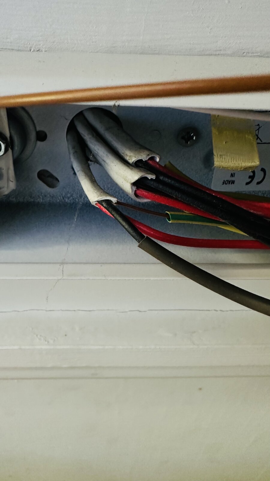

I'm just switching out a fluorescent light in my utility room for a little LED ceiling light, and I'm very confused by this wiring:
I don't quite understand what I'm looking at, since the live doesn't appear to be going anywhere, and I'm further confused about why there is so many different feeds.
If someone could explain, and help me simplify the layout so I can make this work like a standard single switch light, I'd really appreciate it.
The entire house has been switched off, and all lines have been tested with a multimeter.
Thanks!
The single black is the switched live (dont lose that mark it with some brown tape) edit... sorry it already has a brown sleeve.
The 2 blacks together are neutrals
The 3 reds are the loop they don't connect to the light.
The green and yellows are the earth wires.

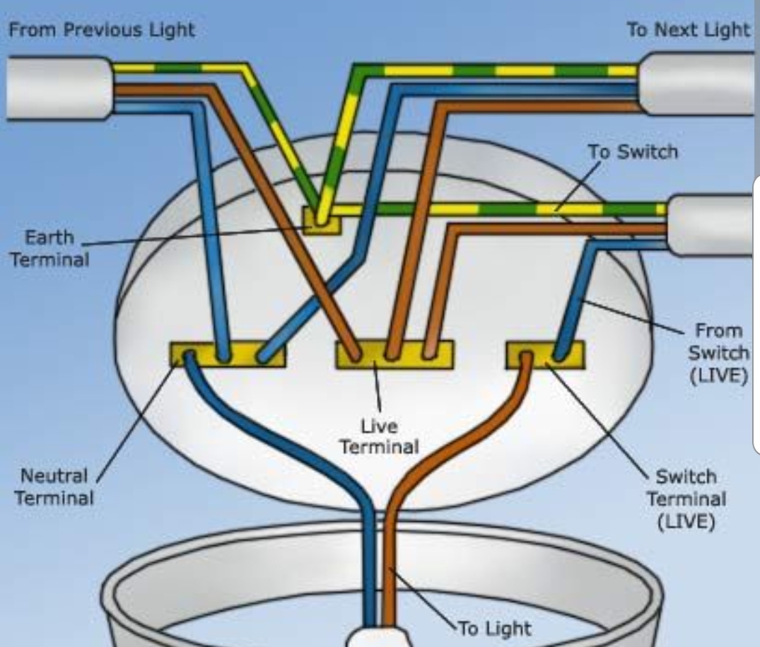

This might help you makes sense of it, although the switch live isn't marked in this example for some reason.

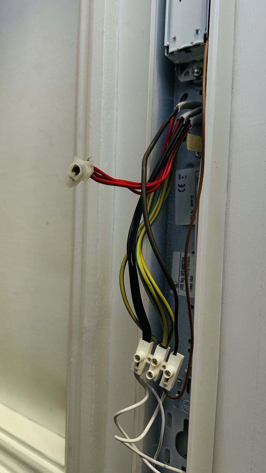

No the 2 blacks in the white connector marked N are neutral.
The black with brown sleeve going to the white connector marked L is live.
The reds stay in the connector block as they are now and connect to nothing.
OK, so essentially, I'm keeping all the terminal blocks in place, and the only thing I'm actually doing is sticking the light on the end of where the old light was?
Yes, but you'll remove the wires from the white connector block and put them into the new light terminals.
