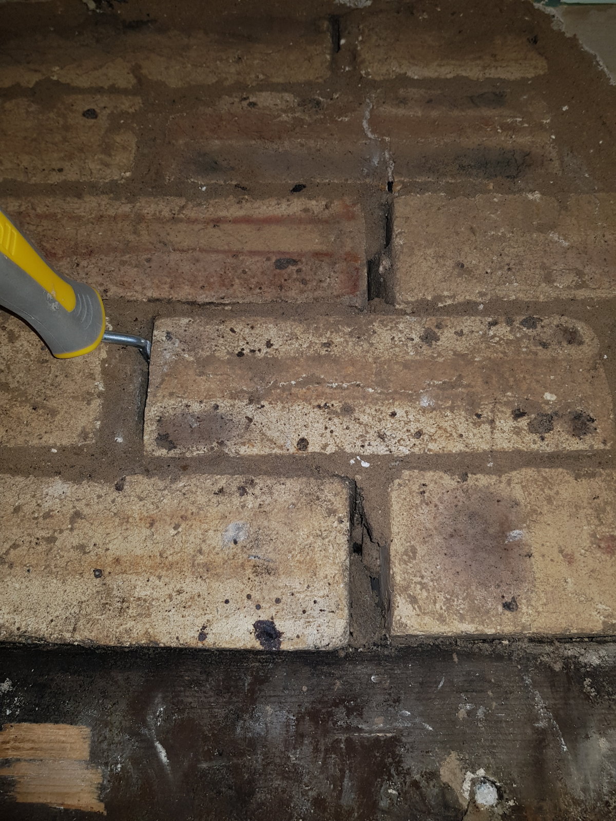

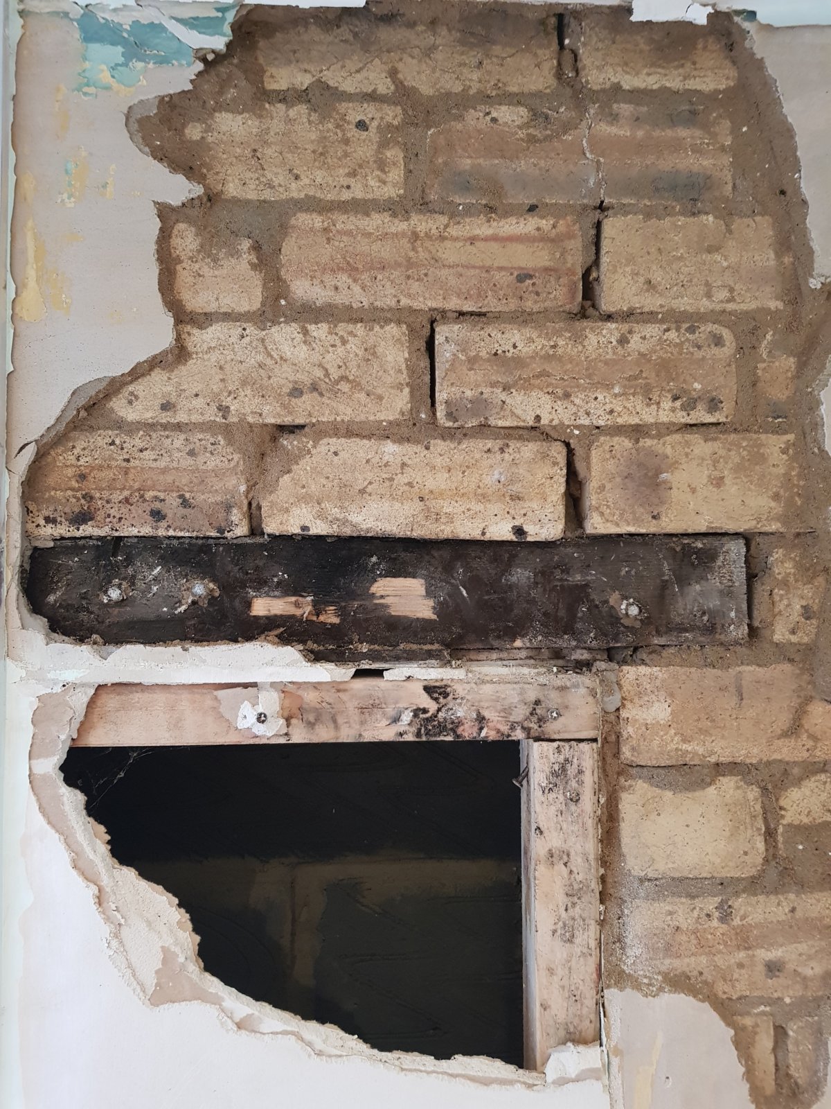

I proceeded to strip what appears to be original lime/clay plaster from the bathroom to check the pointing, since it appeared to have some issues as mentioned externally. Of course this is now the inner course I'm working on. And to my horror, this is what I found when I exposed the portal (see pics). It appears that the inner course portal is supported by a wood lintel that looks original. It appears structurally decent. The portal face was covered with plasterboard and the whole skimmed to create the wall surface, which is what I've removed. However, there is a really nasty looking crack emanating from the corner of the lintel in a roughly vertical direction. This is what has me scared. The mortar around it is very soft to non existent in places - I could take it out with my finger. The crack is deep - see pic 2 with embedded plaster trowel to full depth. I didn't clear that out, it was like that. Worse, one of the bricks has cracked through the middle, suggesting significant loading to me.

1) Penetrating damp causing over time softening and erosion of the mortar. Hopefully with fixing the external leak issue and repointing the bricks appropriately on the external course, the ingress will be greatly diminished and the wall can dry out, permitting me to address the problem with crack stapling and injection of fresh mortar into the joints.
2) Movement of the 80+ year old wooden lintel, leading to the structural loading of the brick and its transverse failure.

Timber lintels in older houses are pretty common its not that big a deal. Its probably best to replace it, especially if it could be weakened by rot.
Im not sure what you mean by portal -the lintel carries all the load to the brickwork either side, the door frane isnt carrying any load.
I wouldnt be worried about subsidence, the house is 90 years old, itll still be standing in 90 years time.

A steel box lintel might be easier to fit than a concrete lintel -much lighter to lift and maneuver into position.

ive just looked at the pics on a bigger screen -am I correct in saying this is blocked up doorway that led through an external wall into a garage?

That is right, yes. You can see the blocked up doorway on the outer course - which is breeze block or similar large format - and also the lintel and part of the opening on the inner course of brick, as well as a "door frame" that is not original and I assume was put in with the wet room. I put my phone in the void and used the flash to take a load of photos - appears that the cavity is (somewhat) isolated from the door gap by timberwork inside the wall, which looks to be intact enough, although not at all pristine. I had wondered if that might be related.

it looks like you have a redundant doorway on an external wall.
the opening was framed with 2x backing and plasterboarded.
the stout lintel above the opening appears sound.
if you think support is an issue then: after removing the 2x's the opening could be bricked or blocked and the lintel eliminated?
or you could replace the lintel - though i see no need for replacement unless there's some heavy point load directly above.
where you have bubbling plaster or other cracks then pics please?
fwiw: the crack above the lintel could have the beds and perps raked out and pointed up with a 3:1 mix of sand and lime - or even remove and re-bed the bricks.
