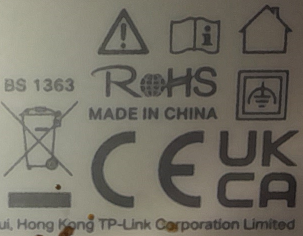

My own plug in doorbell
it also works as a hub for loads of smart stuff around the house, but is marked BS 1363 and UKCA which is what one would expect. I keep forgetting Hong Kong is now China. But having lived there, they do have BS 1363 sockets, so same unit would be used local to where their base is.
