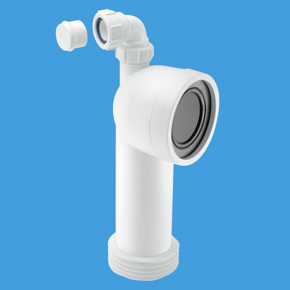

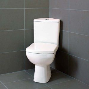

You can get a corner pan, in case you didn't know? These are sometimes useful in small spaces!

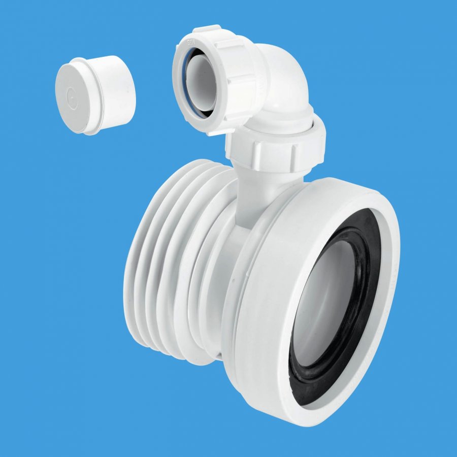

You can also get a pan connector with a spigot to receive waste from another sanitary source.
Cheers. Yup, I've seen corner toilets. Probably won't go with one as there's enough room for a standard toilet.

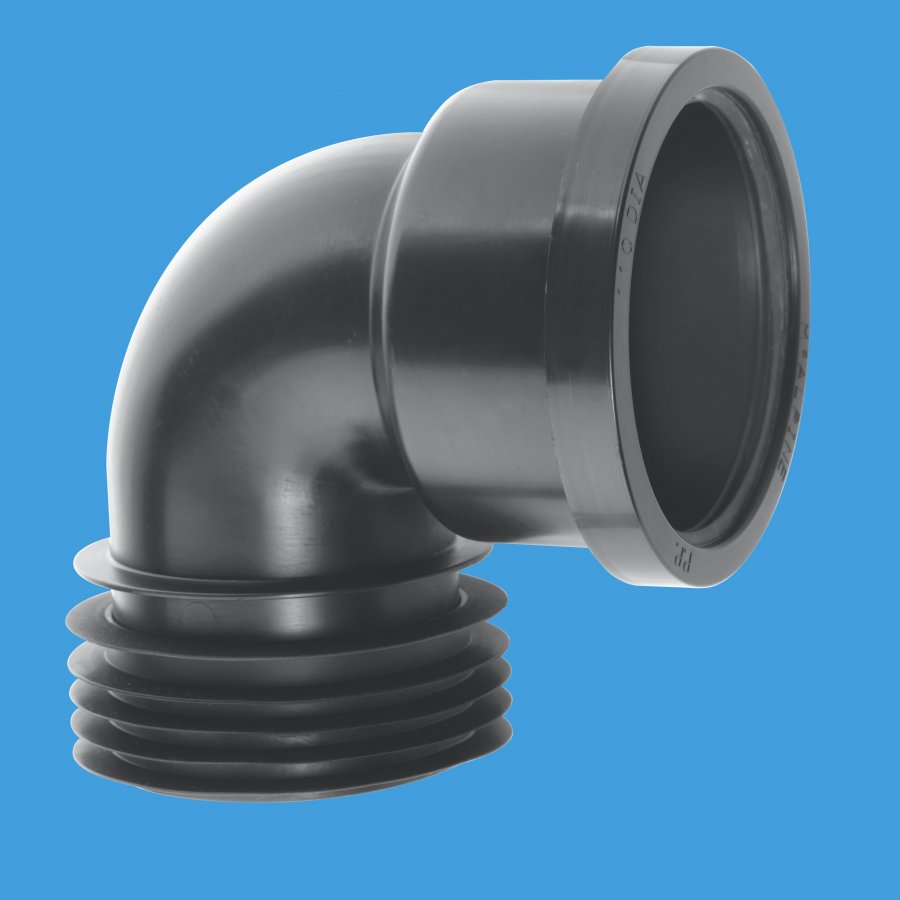

I was thinking along the lines of the pan connector in the middle picture but i can't fathom what I would need to connect the pan. I.e. the pan connector in the 2nd pic would go in the floor but what goes on the pan & to that given there's a couple of feet between the pan & drain?
pQ632iXBh_wuM0yxFbVG6ljOqRYY2_AxSPkUjDq5BqrihyxXFslOryCzCDEInu_bcK9xs9t4e6ovbp4wxxZCpADbKGUKrUvgclvjgXkcUDxR31BgsOumAuah7b4HJr0v6cGwn1x10Nm1YKdEjtNBIxH3jq_6rAKYN__AxWmoj0ouADJ0Mp-vmq2XxbTEtxgbn2cYB2sNnT63NEyiesDn-m4NMfQcrpx2ROw4QGlR9M0BIJI8GJyZwj05vTGAPfhnnSvupRB_10VJByIr6wOp_SK1XwpXSHm3l60Su7ptUzVLdAi2uzOiYDuIs6Rg-7jKFoP45qaTZdFScHonddoqUVEPNPNiAQ82cTb34K_qB4zAGA-1f8jjs2OH7hUOSumlJ_XcshMYiL5oJwOJfW9TtThTTiAa_bVtHQukPStMcQTuzrjl8fw0jh8QVe3hKDUahKh1mn8PKEMUSrdovc7zOqkMde528XhzxW23Mh6igKWN1WgPwZs6AjnFxaX6Jj-eSp3yjwiHg7kIbS_QMAYEWmR8s1qpsHX06ofHzXP6dMmyO3Y0uq6qNRG9Vx11uBioEHjmag=w1510-h850-no
What is in the floor? Is it a 4" fitting or just the end of a length of 4" pipe?

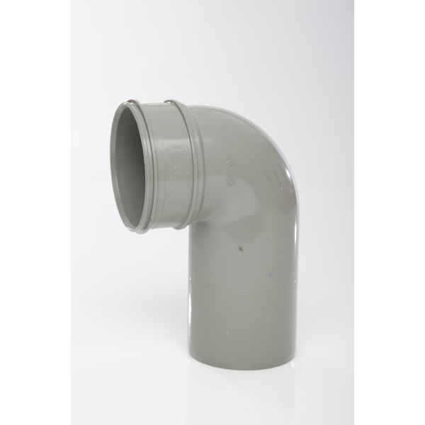

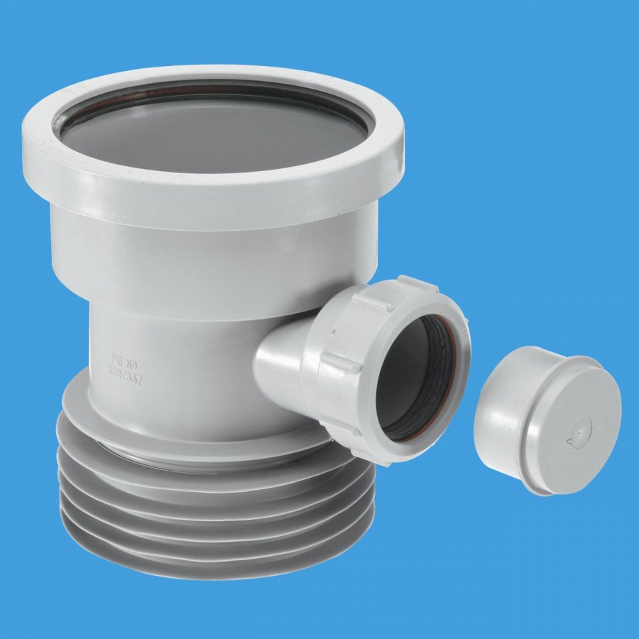

If it's a female socket, you can come off of it with 4" soil or m&f elbow and pipe it over to the position you want your pan, then you get onto that new soil branch with your multikwik fitting.
If 4" pipe, you'll need a socket to multikwik fitting... Mcalpine do everything you need.
Then it's simple... Knuckle 90 degree m&f elbow with solvent or pushfit socket; length of 4" soil to pan position with boss inline to receive basin waste or uninterrupted to pan connector with boss as in my 2nd image!
