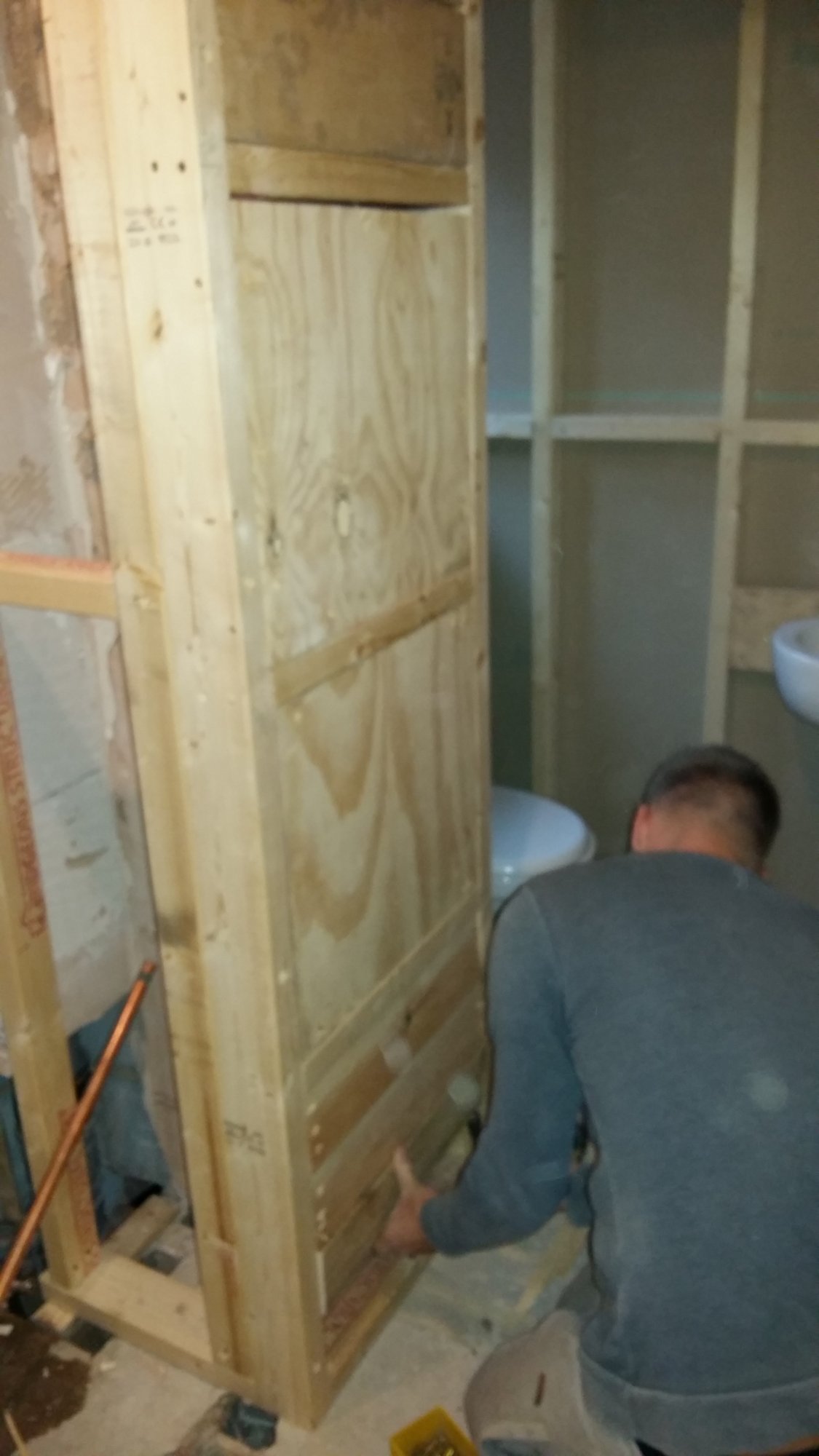

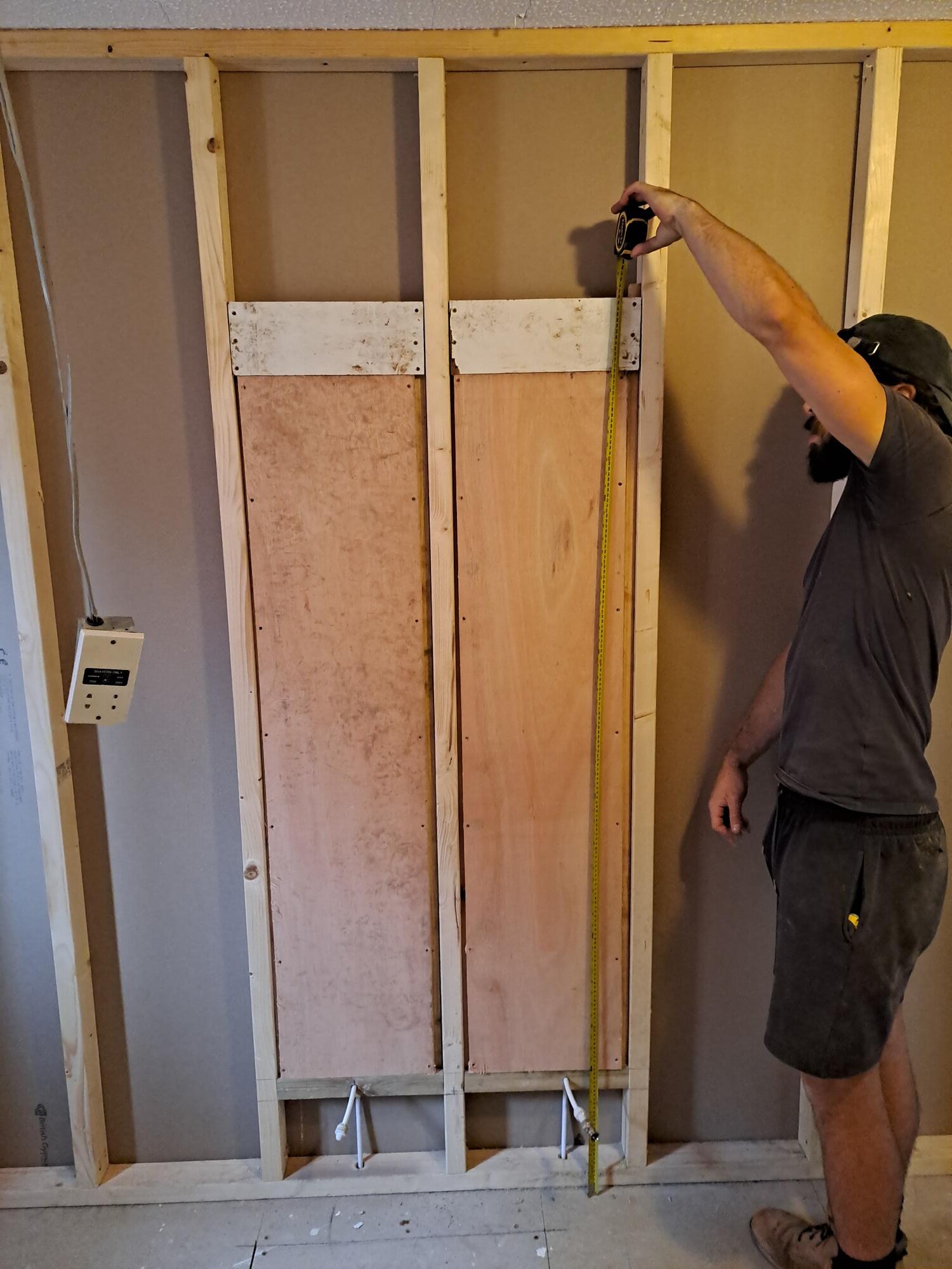

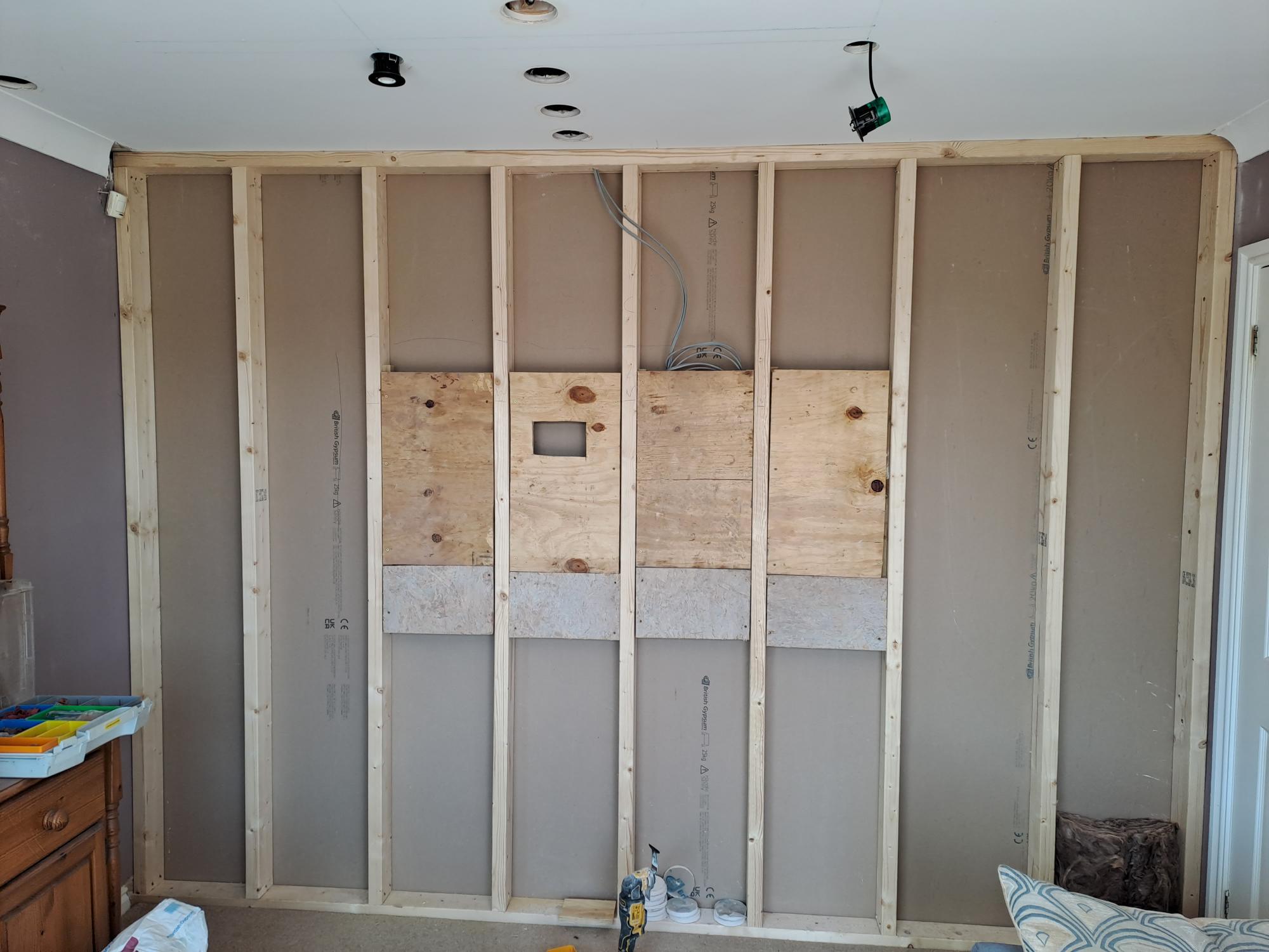

Only an issue if it's a protected escape route (unlikely).
even if it was, you could fix ply gussets between the studs (beneath the boards)....
