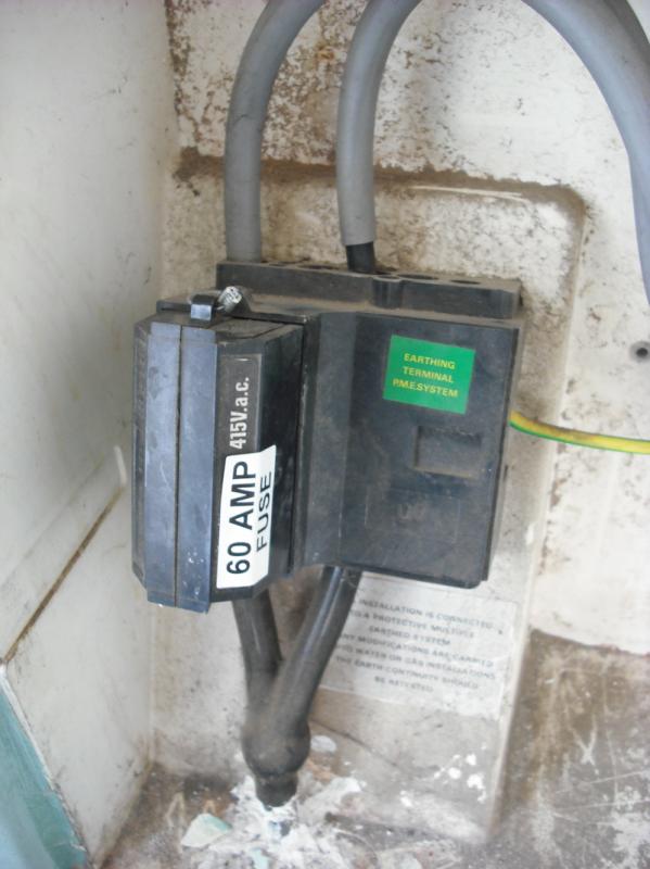

Thank you, the cut out has a label on it saying PME. Here is a picture.

Thanks, 100% its not 10mm, I took some 10mm earch cable with me, and it was almost twice as thick as the cable from the cut out.

Looking at your photographs uploaded 6 days ago, it looks as if your incoming tails are either 16/25mm so your earthing conductor should be 16mm
A point of confusion, according to our regs for a supply neutral conductor size up to 25mm2, 10mm2 earthwire is acceptable to us.
The service cable looks to be 25mm2 copper.
I picked this up from the OSG and Table 54.7 of the BRB - where the cross sectional area of the line conductor (S) (16<S<=35) the protective conductor of the same material as the line conductor shall be 16mm.
