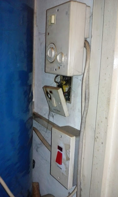

This is the sort of thing I've experienced which I feel an AFDD could have found and would have voted 4 (Yes other) In my view the fault was the switch contact, not the wiring.
This was one of my rental properties,what doesn't show is the bit of T&E to the left of the shower switch had been connected directly to the top immersion heater by the tenant (who had moved his girlfriend in then moved on, leaving her in place) and left permanently on, it also feeds the shower.

On the face of it, that looks like the typical situation of thermal damage (hence potential fire) due to overheating of conductors/terminals/whatever due to poor/loose connections. What makes you think that 'arcs' were involved?
Kind Regards, John
