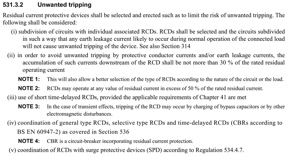

"Do you believe that having just three sockets circuits (one being for the kitchen) in one house, with those circuits spread across two RCDs (i.e. two circuits protected by one RCD and one circuit by the other RCD) is 'non-compliant with BS7671' ? "
Did you actually mean 'non-compliant' - as per the definitions?
This is from BS7671, and where the 30% limit for leakage current is from:
30% of a 30mA RCD being 9mA.

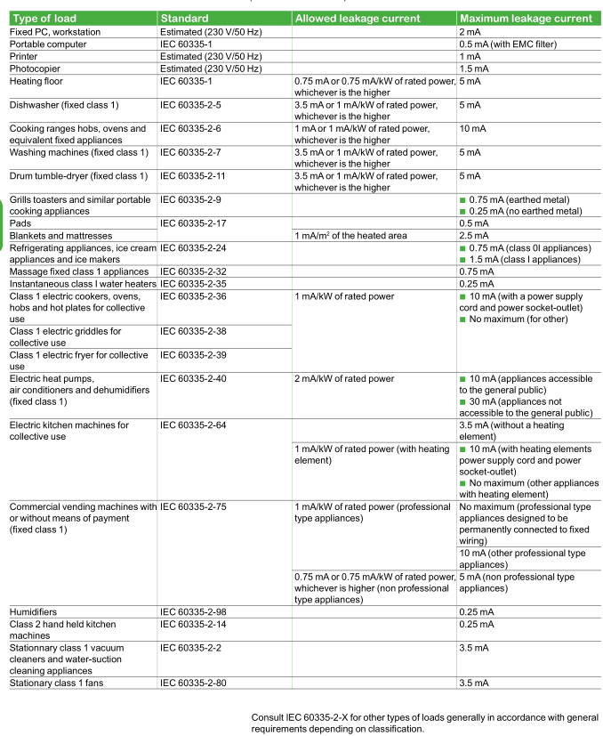

This is a sample of leakage currents for a selection of equipment.
which is taken from this document: https://www.se.com/uk/en/download/document/CA908066E/
the contents of which are from IEC 60335-2- series standards. There are more than 100 of those, one for each type of equipment, and they are all sold separately.
531.3.2 first appeared in the 18th edition in 2018.
Section 314 which is Division of Installation has been in there for decades, since the 15th edition.
The relatively recent prevalence of everything having electronics inside, and specifically switching power supplies, has significantly increased the leakage current for a very large number of items, including those which previously had little or none. Modern homes typically have vastly more items of equipment than those of only a decade ago.
