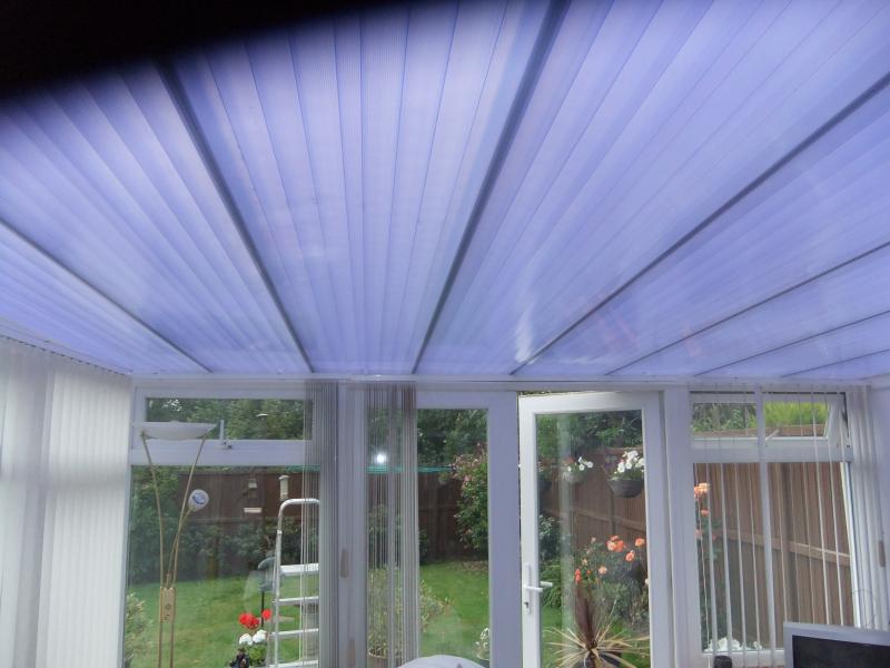

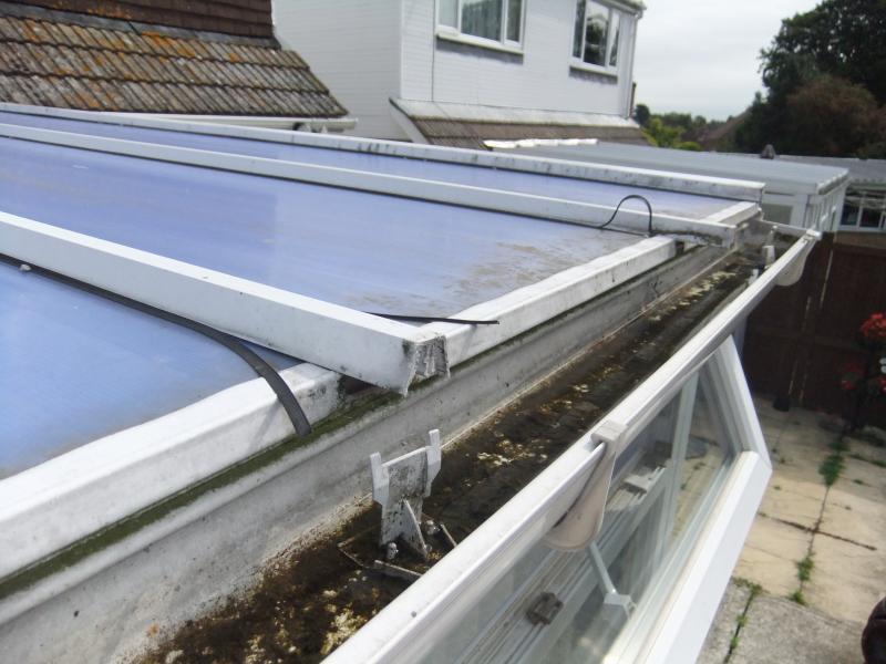

Hi all,
I have a polycarbonate roof covering to my rear lean-to conservatory, it is triple layered, has panels 4 metres in length supported at eaves and wall bracket. The panels are apparently 3 years old, have cover strips externally with stop ends. there is no evidence of glazing bars though, internally, just looks as though the panels are fitted up against each other.
In one corner of the roof, the panels are very loose in the middle when pushed up and are letting in water. A couple of the cover strips have slipped down the roof also.
My question is twofold, shouldnt the panels have intermediate glazing bar support? Does anyone know what type of roof this is? (most I have reserched that are self supporting seem to require glazing bar support).
Any advice would be greatly appreciated
they must have some glazing bar or they would be buckle in the middle. In the picture showing the gutter I see what looks like thin rubber strips and if they are not in place then they cannot act as the seal.

That is what I thought, but from the internal view, theres no evidence of a glazing bar supporting the panels from below, usually they are both internal and external.
Any ideas?
this looks like an ultralite 500 roof (sheets are 500mm wide) sheets slide together and they have a thin central aluminium support that slides between the joined sheets giving the appearance of a seamless roof from the underside. the top capping clips into the aluminium but yours looks like it has become dislodged generally these roofs are okay try taking the cappings off and having a look it wont do any harm then knock the cappings back on lubricate rubber seals with glass cleaner and knock back into correct position you may need someone to hold underneath to stop glazing bars bouncing when you knock the caps back on
