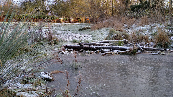

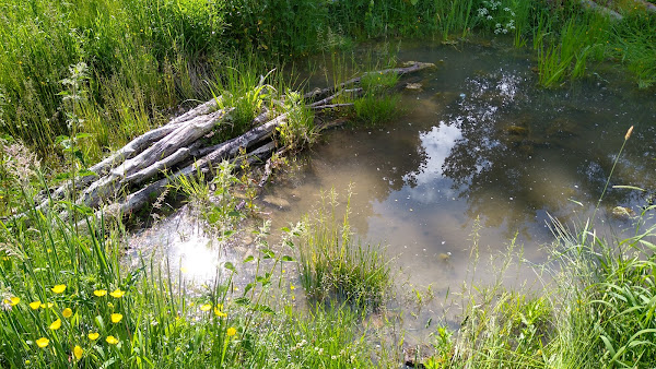

I did a few very successful wildlife ponds with the liner sandwiched between two layers of old carpet.
Looks awful for the first season but next year the plants ,and wildlife move in.
Toads newts dragonflies make homes and bees come to take water.

The pond pictured is spoon shaped with a max depth of around 2ft shallowing back to zero.The liner is 7metres sqare
The shallows provide marshy areas which are vital.

But as the pictures show the flora and fauna have been undeterred.
