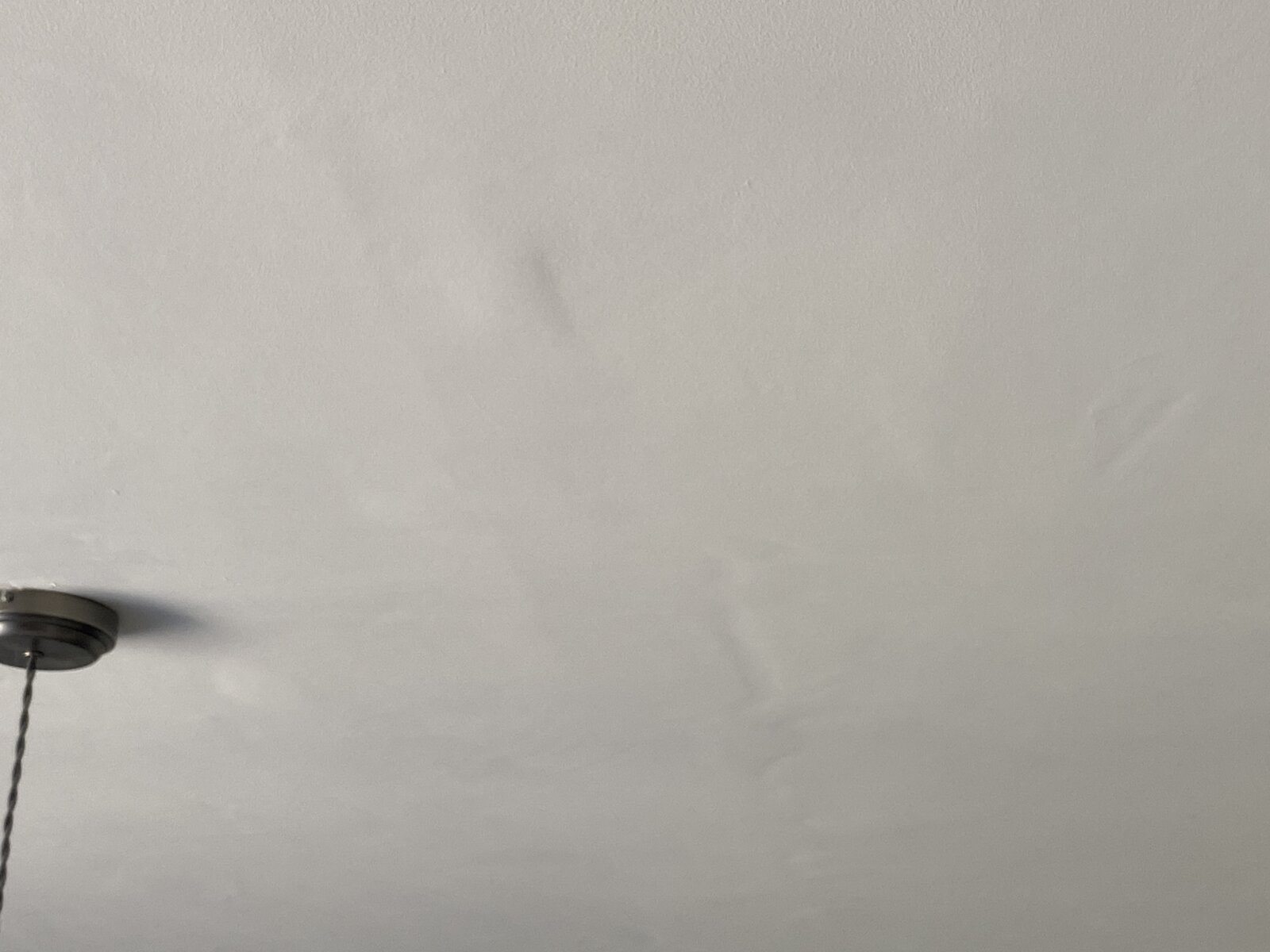

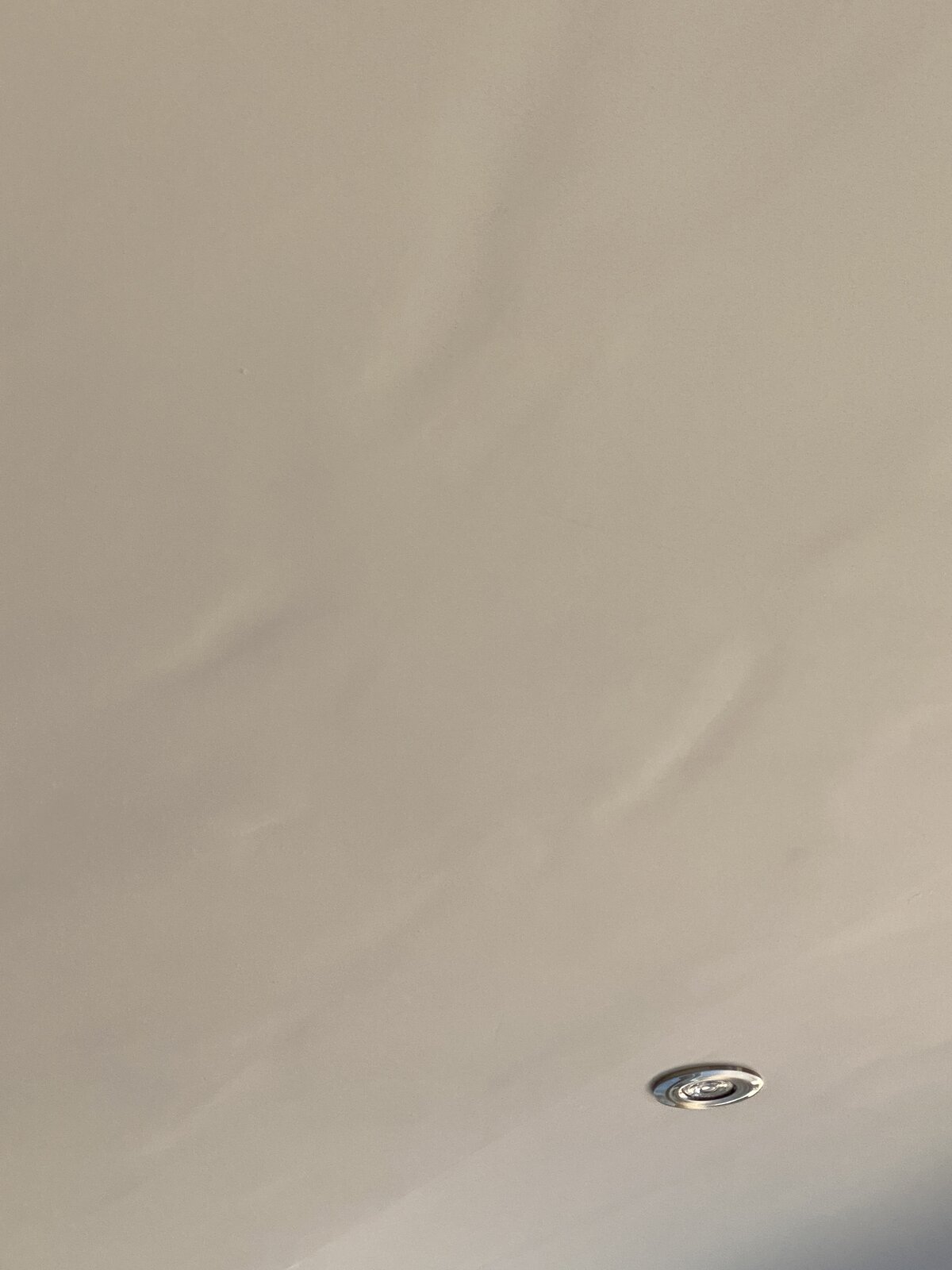

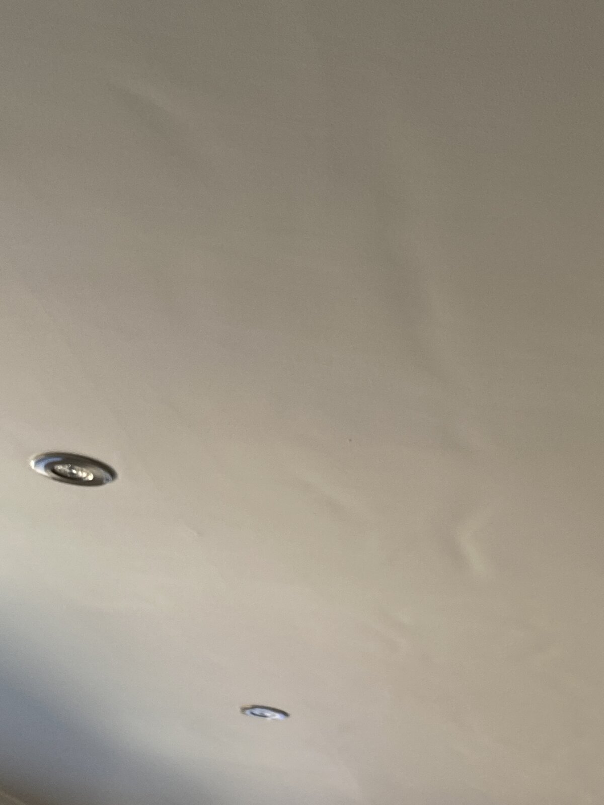

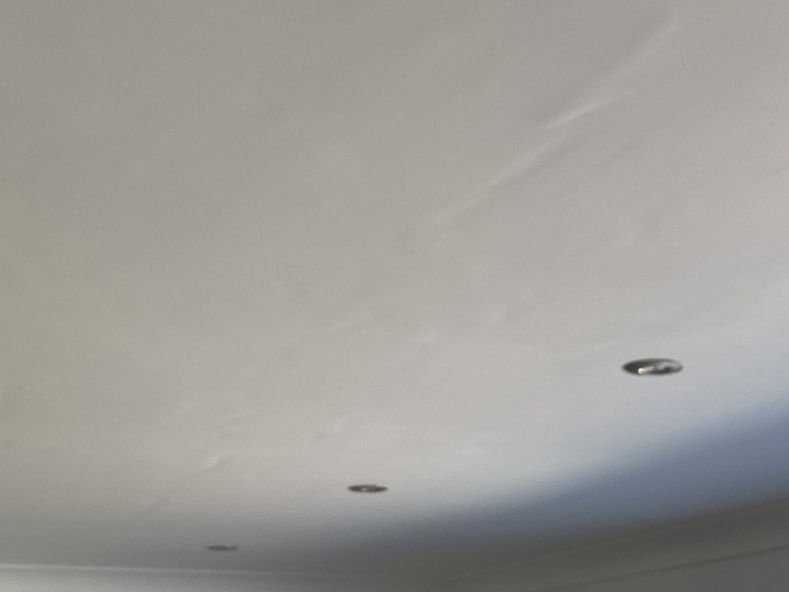

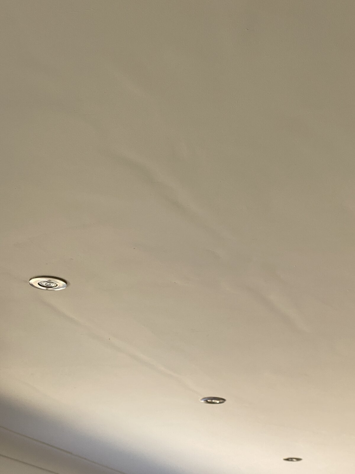

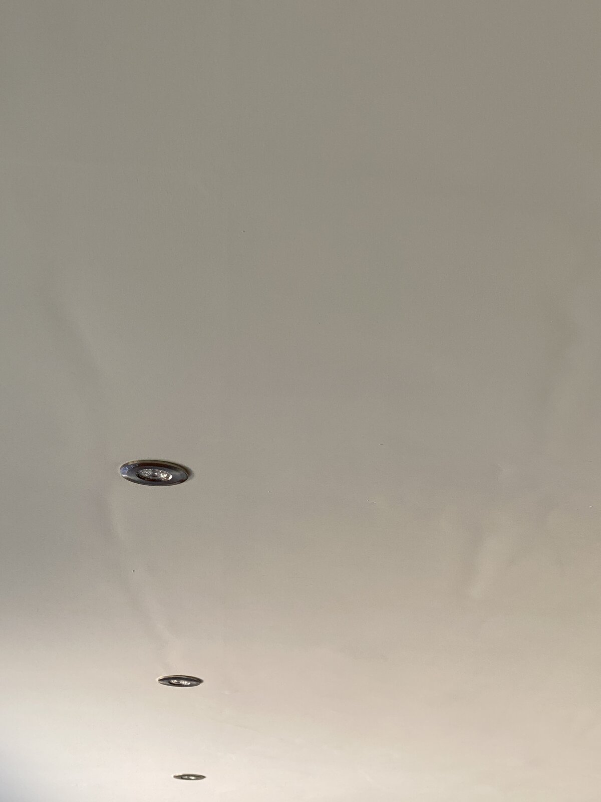

Our builder finished six months ago now and I keep looking at the plastering. Is this acceptable or am I right to request it to be redone ?

Well, it's not the best.
One of two things -
1 - Ask him to redo it, will it be any better?
2 - Mist coat emulsion it, fill and sand down.
Get him to pay for the decorator to sort.
I can see why you are annoyed.
As per @Bonni 's post, will he be able to improve it?
He could get a decent plaster to go over it again- that is a day's labour (set up, prep etc) Then just over a half day to repaint the ceiling and re-cut in.

I hate to see work like this its shocking how the hell did he end up with all those channels and divets? Was the ceiling flat befor he started?

That is truly shocking work, that builder should take his tools and throw them in the nearest river, it looks as though he hasn't really tried to leave a nice finish, people like him give the trade a bad name, I would seek advice from a local plasterer to see if an over skim would put it right or whether it needs over boarding and skimming again, but first you need to get the original builder back first to see if he will remedy it or pay to get is remedied
