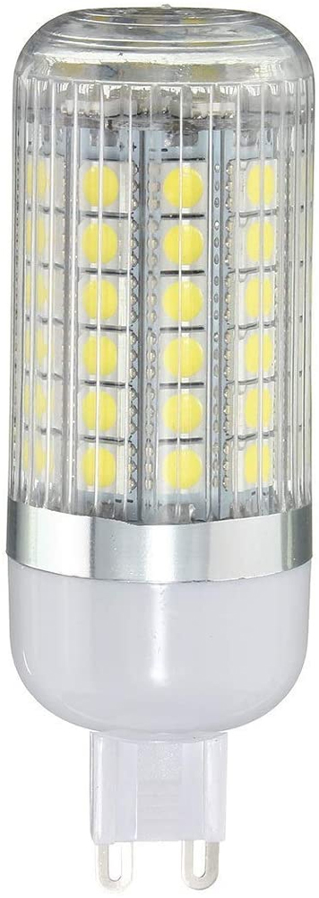

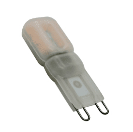

I had a replacement for a fluorescent tube fail, and a G9 fail the G9 I opened to see how made, found a dry joint, re-soldered and put back in to service, I started moving over to LED around 2017 and other than the two had no failures, although had one showing signs of over heating, using GU10, E14 candle, B22d, and G9, my problems has been flashing when switched off, and a shimmer when switched on mainly with electronic switches.
I am sure the fluorescent tube replacement used a pulse width modulated chip, but the bulb I opened used two capacitors, a full wave rectifier and a resistor plus the LED's, one capacitor to control current, and one to smooth the DC, and resistor stops it flashing when switched off, the bulb looked like this G9-big.jpg very cheap and breaks the rules showing not wattage, or lumen on the bulb, but works well, the ones before looked like this G9-small.jpg and the but is very much smaller and clearly not enough room for the smoothing capacitor but they did allow the fitting of the glass covers, the larger ones will not allow fitting of the glass covers.
