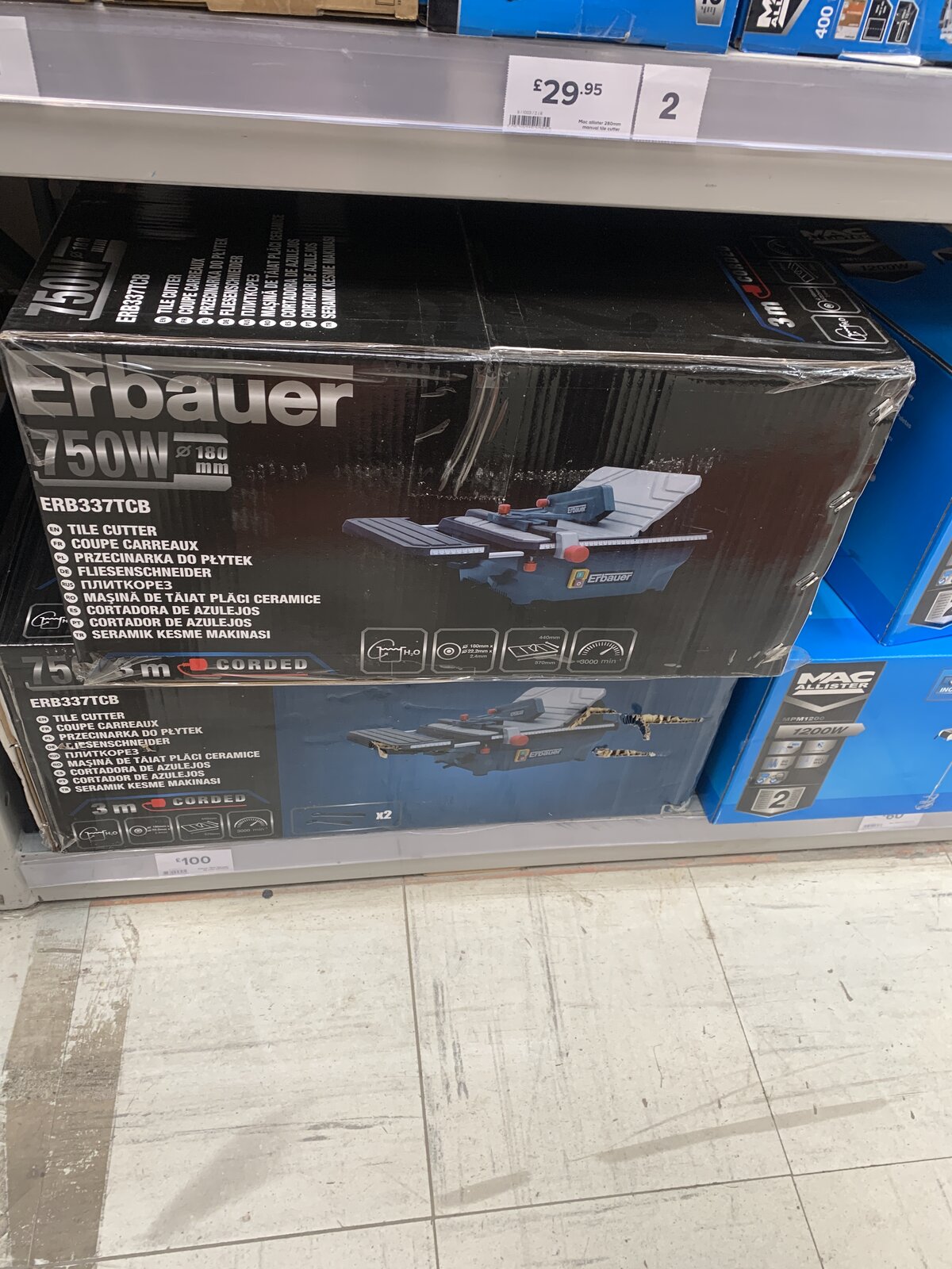

Hi All,
Tiling most of the ground floor in a couple of weeks’ time and am looking at tile cutting options. As I’m doing this over a period of time I’m not sure hiring anything is a suitable solution so was looking to buy something not too expensive. What are your views on this? Has anyone used one? I often see things like this as being ok if you change to a decent blade etc. If that’s the case, what is a decent blade?
https://www.screwfix.com/p/erbauer-erb337tcb-750w-brushless-electric-tile-cutter-220-240v/134fv

Depends on the tiles and the cuts required.
If your using 30" tiles you might need a bigger cutter, if the tiles are thick you will need one with alot of break force.
It's worth investing even just for one job, as it will retain resale value in any case.
Make sure you also get a set of diamond pads and you can return a factory edge if required with a bit of effort.
Thanks. I have 2 tile styles. Both porcelain. One is wooden plank designs that are 13cm x 100cm
The other is a travertine style pattern with the largest tile being 60cm x 30cm
Based upon that would the tile cutter above be suitable do you think?
Thanks!!! That seems to have some great reviews. I was under the impression that porcelain tiles needed wet cut/diamond blades etc to remotely stand a chance of making the job easy. I guess that’s not the case in reality with a cutter like that then???
Personally, as a DIYer who has done loads of tiling of all types, I would never use a score and snap cutter over a wet cutter. I'm sure that they can be faster, but wet cutters from a DIY perspective are easier and more certain to cut cleanly. My own experience with very hard porcelain is that they tend to shatter.
I have a big wet cutter and a tiny little plasplugs cutter a bit like this https://www.screwfix.com/p/mac-allister-mtc500-500w-electric-tile-cutter-220-240v/776fx. I prefer the small cutter because the wheel is thinner and takes less material out. I have regularly cut 600x600 It's easy to rig up a little supplementary support if you need it.
I would go with a wet cutter. It also allows you to easily cut awkward shapes by making slither cuts and snapping out the slithers.
