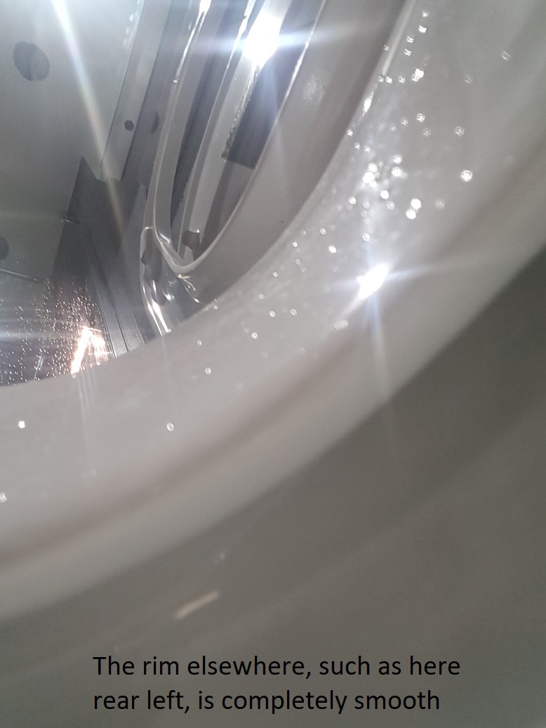

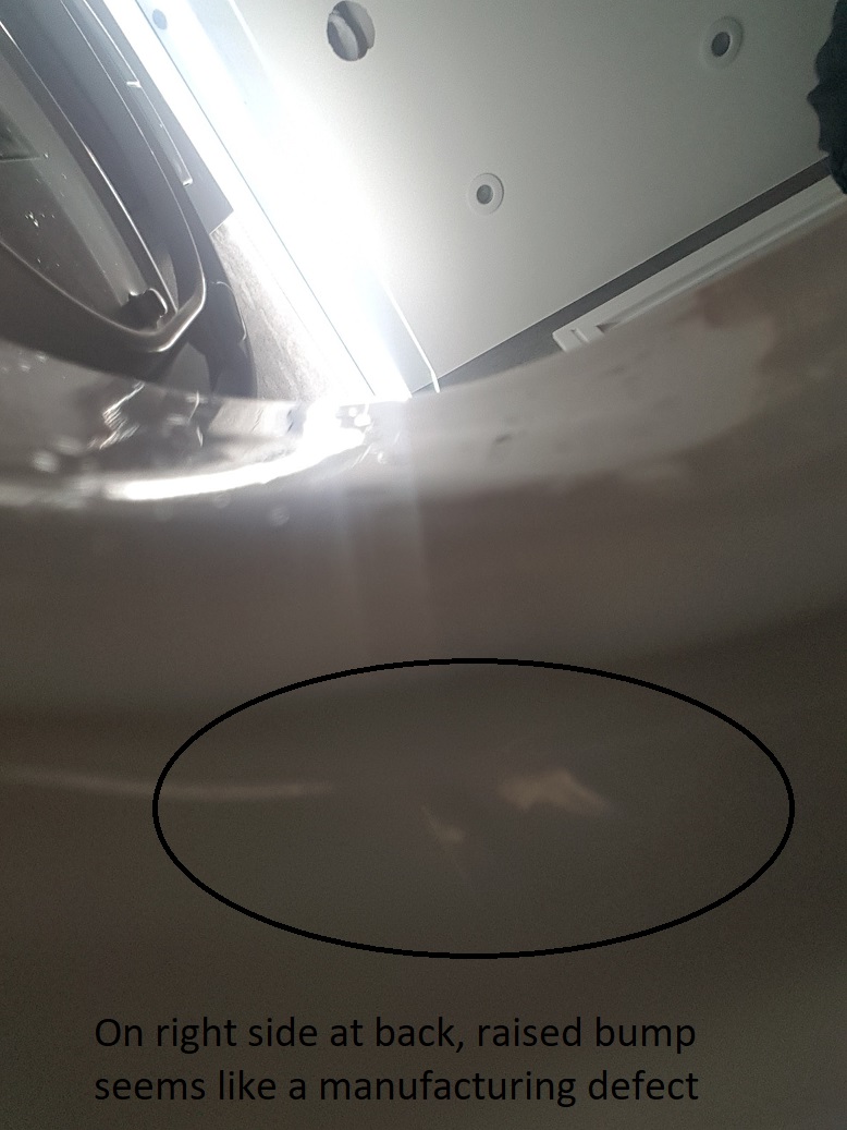

I have had a feel around the inside of the rim, and everywhere is smooth except on the rear back towards the right, there seems to be a faulty raised bit. I've taken some pretty rubbish photos with my phone selfie camera - you can't really see the detail, but most of the rim feels completely smooth and reflects light smoothly like this:

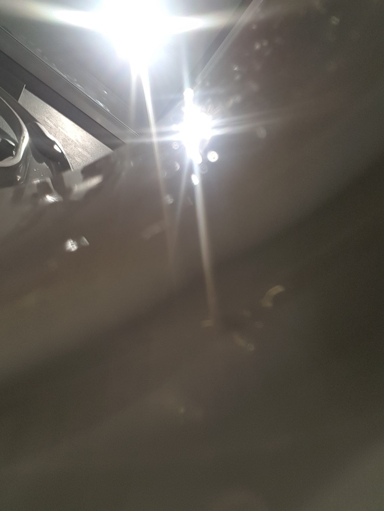

but the rear right has this imperfection that you can't really see clearly in the photo, but you can see that the light reflection isn't smooth:
I suspect it's because of this that the start of the flush is breaking up the water flow and overflowing the rim.
It’s a pan moulding problem.
Send it back for replacement but you’ll have to pay the fitter for a refit because it’s not his fault. Or introduce a restriction in the flush pipe... but that is bodgery!!
Definitely a pan defect so the restricter wouldn't help this time however it has been available for a long time, guess you've never heard of it.
