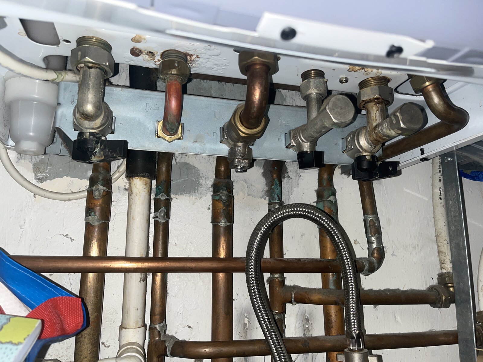

are these valves in the right position? My pressure is fine but heating won’t go on
No, both the flow and return are closed (outer black handled valves horizontal across the pipe). Is the boiler seeing a demand? Which boiler model is it?
looking at your pic you have or have or had a bad leak on the left inside boiler and there is also indication of one on the right from inside
