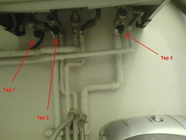

Hi everyone, The other day I bled my radiators, and later on there was no hot water or heating. This then led to a loud screeching noise from the boiler (which i imediately turned off.)
From what Ive read on here and other sites it sounds like a pressure problem, However I am crap with things like this and haven't been able to solve the problem myself.
There are 3 taps underneath the box, which I have taken a picture of here:
At the moment I have switched the dial on the front panel to the off position.
if anybody could give me a step by step guide to fixing this that would be great. Our landlord is crap at fixing things like this and Im bloody freezing.
thanks.
You need to open the slotted screw valves at either end of the silver braided hose. They will probably turn 90D only.
You wll then hear water filling the system. Watch the pressure gauge whilst doing this and when it reaches just over 1 Bar turn the valves off. You may need to bleed the rads again, then check the pressure and possibly top up the system again.

ok, so ive turned them the 90dg,
Unfortunately, no sound, no change :( any ideas?

Pressures gone up, boilers on, and radiators seem to be gurgeling! Ill give it a bit and bleed them again and reapeat. Nice one gas, you have saved me from another cold night.
Unless you have some sort of reverse angle on your pictures....
The hot and cold pipes are back to front!
