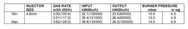

(p.s. it it really a 100,000 Btu boiler? For a system boiler, is this quite big?)
Nice boilers (apart from being positive pressure case type)
This is the input/output details from the MI.
