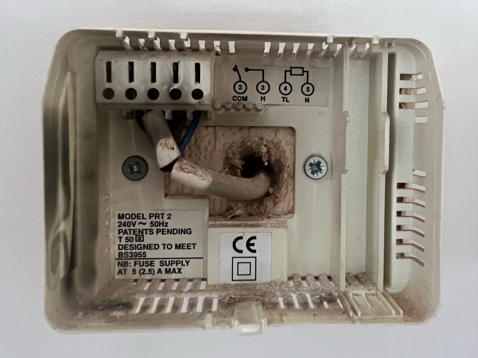

having this wiring with my potterton prt2 with bridge as below
How should I make it thru the Honeywell dt4/dt4r please?
Thanks for the help in advance.
what if go for a dt4r?
Seems here only got 3 wires and a bridge.
If you go for dt4r (wireless model) then it might still be possible, as you need a permanent live and permanent neutral, with switch wires. If you only have 3 then you’d need to link L to common.
