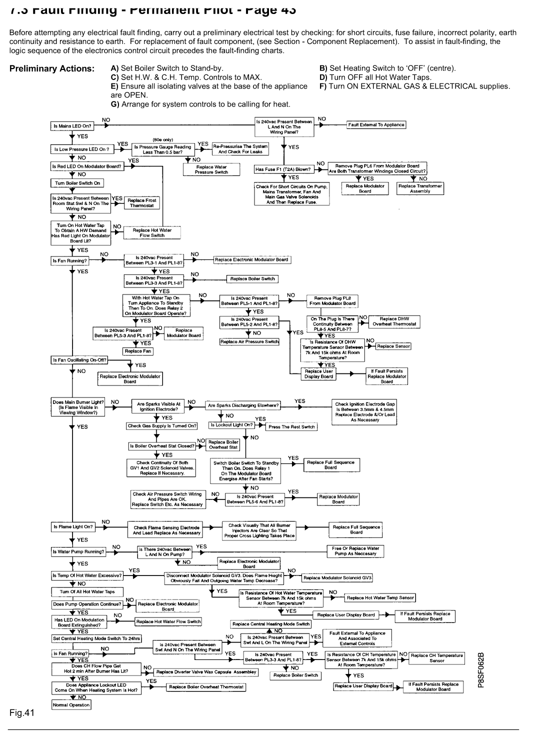

For some time I have had deteriorating hot water pressure, to the point that it is now painfully slow. Following the advice on here, I have replaced the diverter valve with no improvement (so now I suspect scaled heat exchanger??)
Having put it all back together, I now seem to have managed to cause a control fault. As soon as I switch the power on, both the Mains On and Flame lights come on, and so when I switch the thing out of standby it immediately locks out - I've tried looking at the fault finding charts in the manual (on partsarena.com), but these are unreadable on there.
Can anyone helo with suggestions of what to try next??
