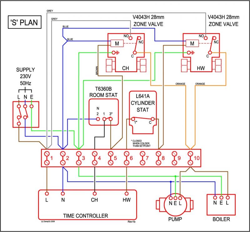

For the pump to over-run, does it have to be connected straight to the boiler pump terminals?, as mine isn't - it runs to the S-plan junction box
yes the pump needs to be connected directly to the boiler terminals and with an S plan you will also need to have a by-pass installed before the two motorised valves, the way the over run works is when the call for heat ceases the boiler will send power to the pump to keep it running till the boiler is cool enough hence the reason for a by-pass as the heat has to go somewhere
Well there's one issue then!, my pump isn't wired directly to the boiler, it's wired to the S plan junction box.
there is some additional pipework around by the two motorised valves, upto the boiler pipes so that may be a bypass
if it is a pipe that joins the flow and return pipes with some sort of restricting valve(commonly just a gate valve ) but may be a proper automatic by-pass then this is indeed the by-pass so you only need to sort the wiring out, it is not unusuall for a boiler to run for many years with the pump wired up wrongly, if you have a bypass it is an easy enough task to wire the pump correctly

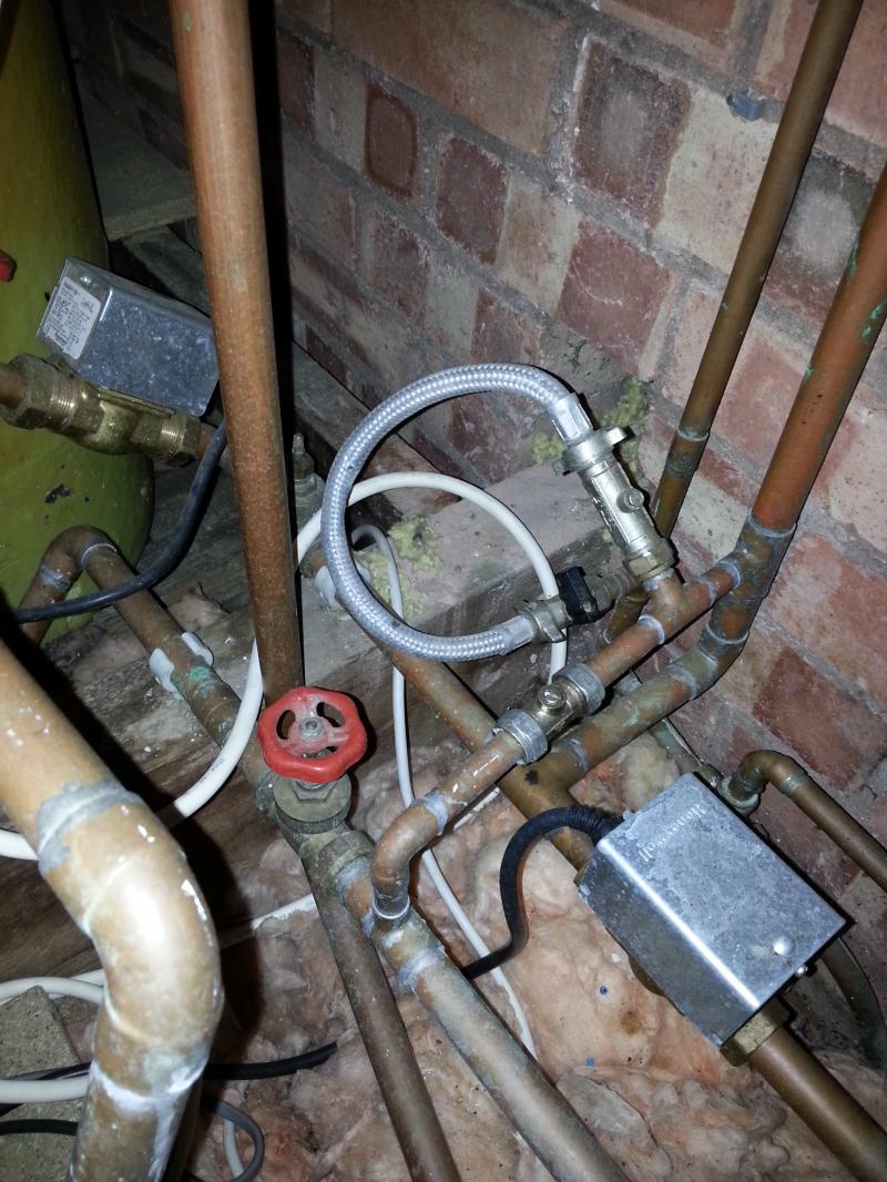

Look for a filling loop normally under the boiler or near the 2 port valves, then you can put some water in the central heating system.
Don't forget to let the expansion vessel down to 0.5 - 0.75 bar if you are going to fill to 1 bar.

Yes there is a filling loop right near the valves, or what looks like.
okay so when cold - let the expansion vessel down to 0.5 bar, use filling valve to fill system upto 1bar on gauge that correct?
Yes but when you are measuring the expansion vessel pressure it is important that the water side of the system has no pressure in it at all. So if there is a drain cock, connect a hose and open the drain cock before checking the EXV pressure.

This is the pipework by the zone valves, I assume this is the filling valve:
Also I have checked point-to-point continuity & my system is wired identical to this schematic. As you can see the pump is terminated in the junction box & not boiler?:
The pump may well be connected into the wiring centre, but does it have a live feed directly from the boilers pcb?
