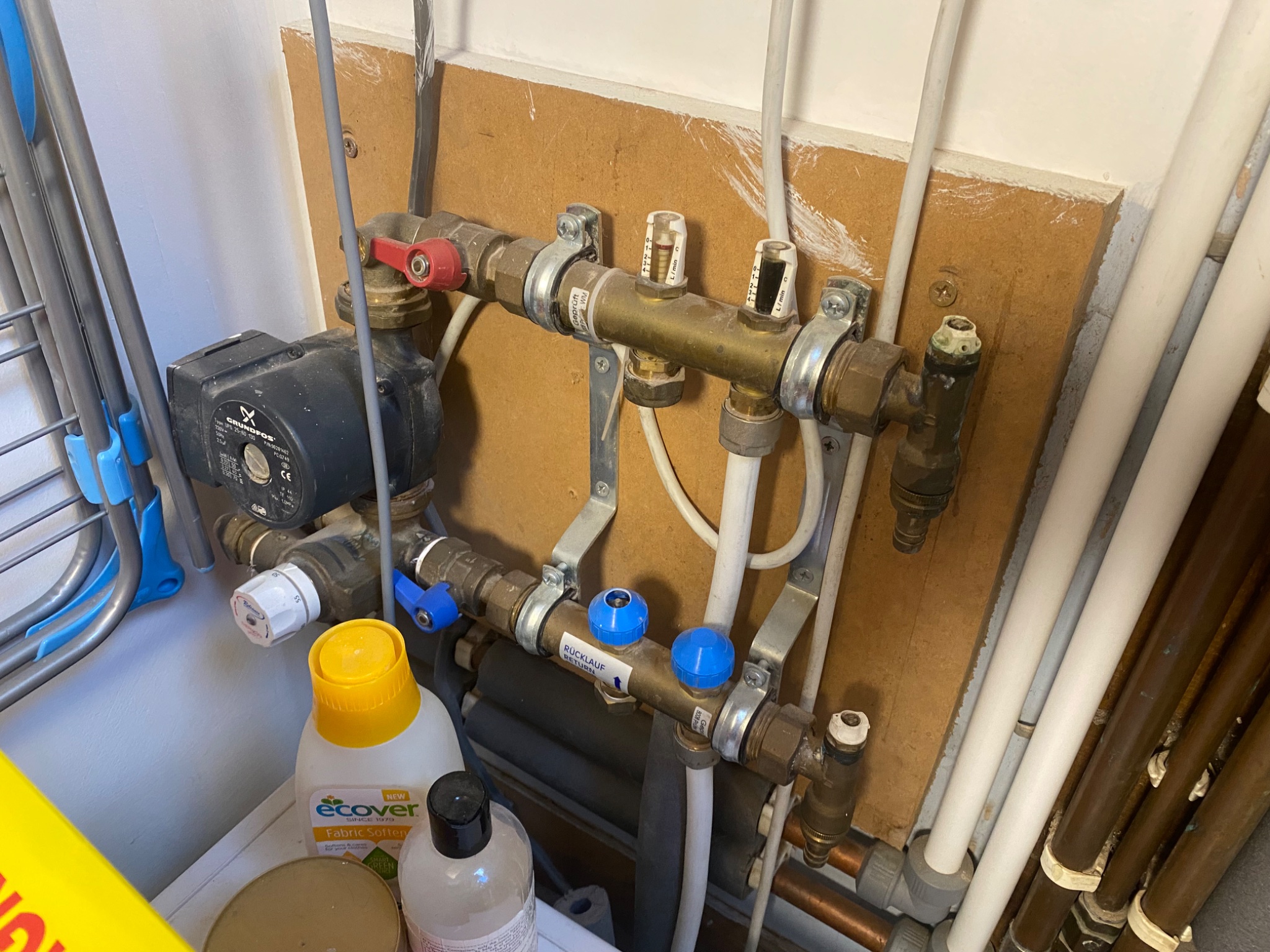

I am going to hire the fernox power flush machine from my local plumbers merchant. I have used it before, but a few years ago.
I took off a rad and attached the hoses to the two valves from this rad to connect into the system.
I can do the same again, but wondered if I can attach somewhere onto my UFH manifold in the photo. I am not sure where to attach to. Does anyone know? Also could I run the power flush through this manifold for all the rads as well or would I need to do the UFH first and then detach and attach the hoses onto the rad valves.

Any idea on how I connect in to the UFH manifold?
Take pump off and connect or did you think that's a problem?

Spoke to my engineer and he said to open the zone valves so the UFH system just becomes part of the heating system. So I will just treat the UFH as if it's a rad and zone off all the rads when I come to clean out the UFH part. Sounds easier.
Unfortunately - with the blending valve in between the manifold and flow/return on the CH system then that will cause a restriction to the powerflush. Even then, to do a powerflush properly, the machine should be connected to each radiator individually and the flow run forward and reverse while the rad is agitated by a rubber impacter. That loosens any crap sitting in the bottom of the rad and is then caught by the machine.

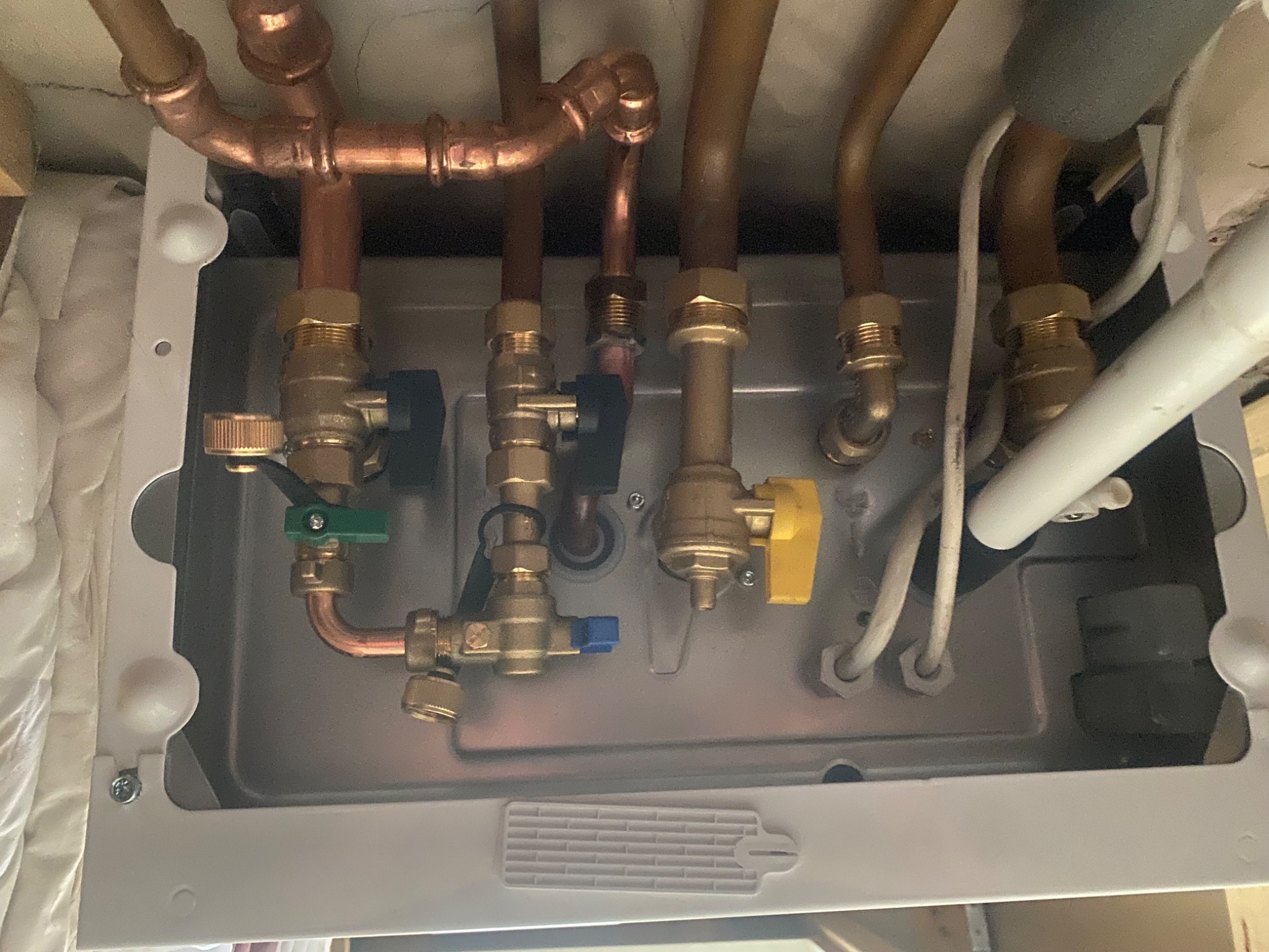

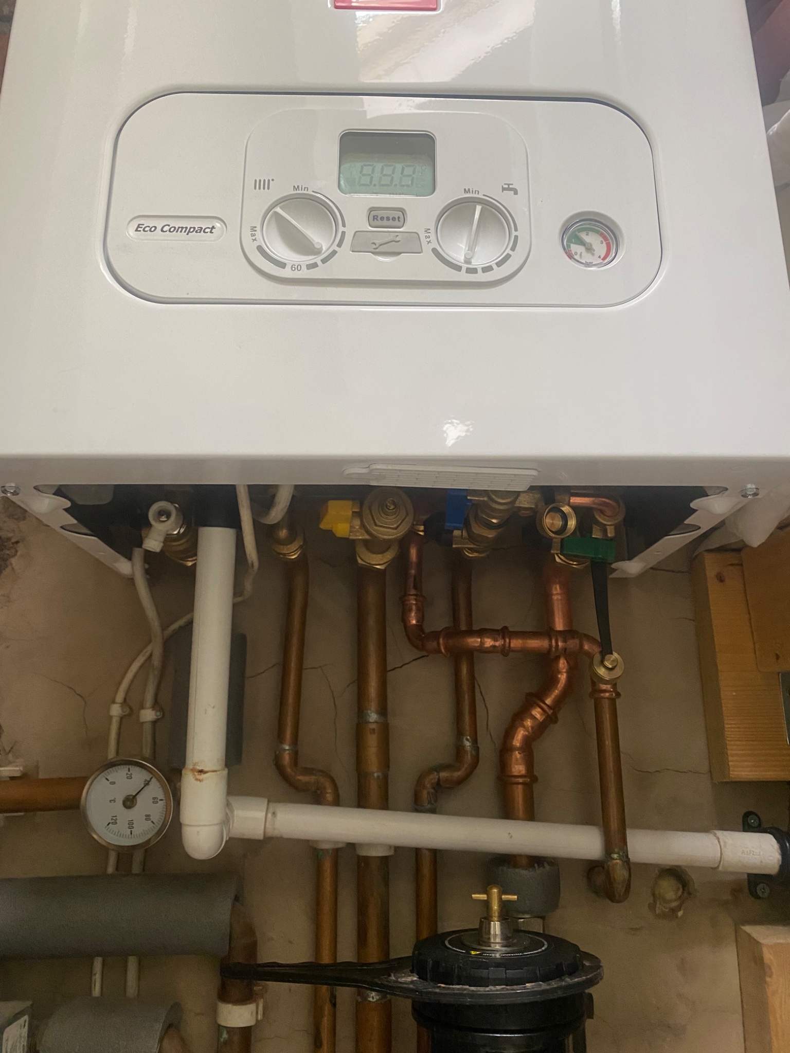

I have a drain off point on the flow side only (left)
It’s a MAIN combi

Ah - no , not the boiler drain point. I'm taking about a full system drain(s), external drain valve(s) run off of the central heating, usually set below floor level on an outside wall, where the whole system can be drained down. Some systems have radiator valves with drain points.
Alternatively, a radiator can be used that's close to an outside door and a couple of hoses.
I understand about the system drain offs. I have 3 rad drain off points. So all sorted there. Not sure if they are on the flow or return though.
Just to clarify, when I force water through the system from the boiler water feed I shut off all rads and open one and clean them out one at a time. Do I also close off the boiler isolator valves for flow and return? This is the point I’m unsure on
Yes - normally I wouldn't suggest using the boiler isolation valves, as some don't like being used if they are old and then leak afterwards but you want to force the water through the rads and any crud flushed out to be ejected out of the drain offs, you don't want any of that running through the boiler.
