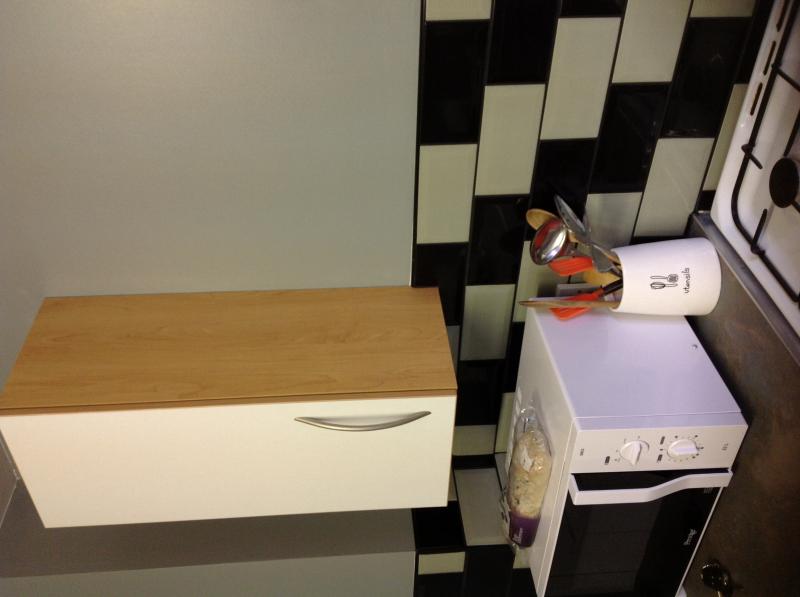

Hi,
I have decided to paint my old kitchen cupboards, the surface on them is laminate. I just want to paint the sides. I have chosen a light grey in gloss. Is it ok to use pva as a primer?
I would buy a paint primer from your local diy shop! A suitable paint primer for your job. The staff in shop will show you what you need. Pva should never be used as a paint primer!
