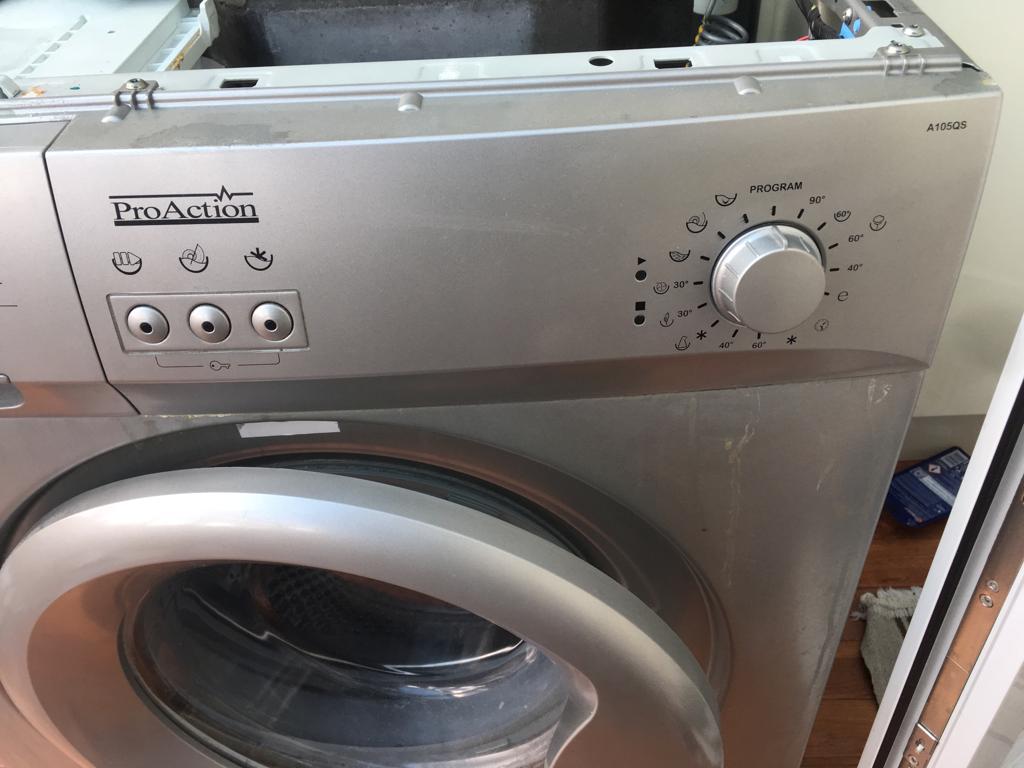

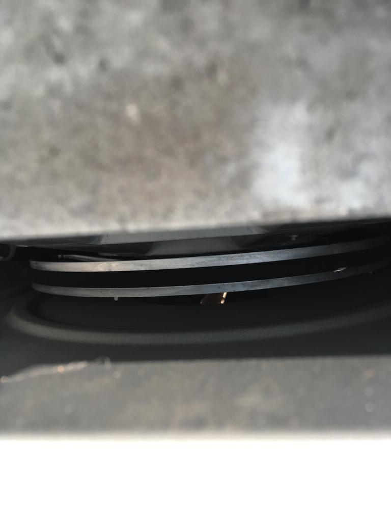

It made a very loud metallic squeaking this morning while it was spinning and then stopped spinning. I opened it up from the top and had a look at the belt and it looks fine. I looked at some videos online and have understood that it could be the capacitor but have no clue how to test this. I also understand the brushes on the motor may need replacing but again have no way to test this. Just wondering what people think I should do next. I was thinking that if there is no real way to test which one is the issue then I should just change the capacitor because it seems pretty easy.
Any help is greatly appreciated.

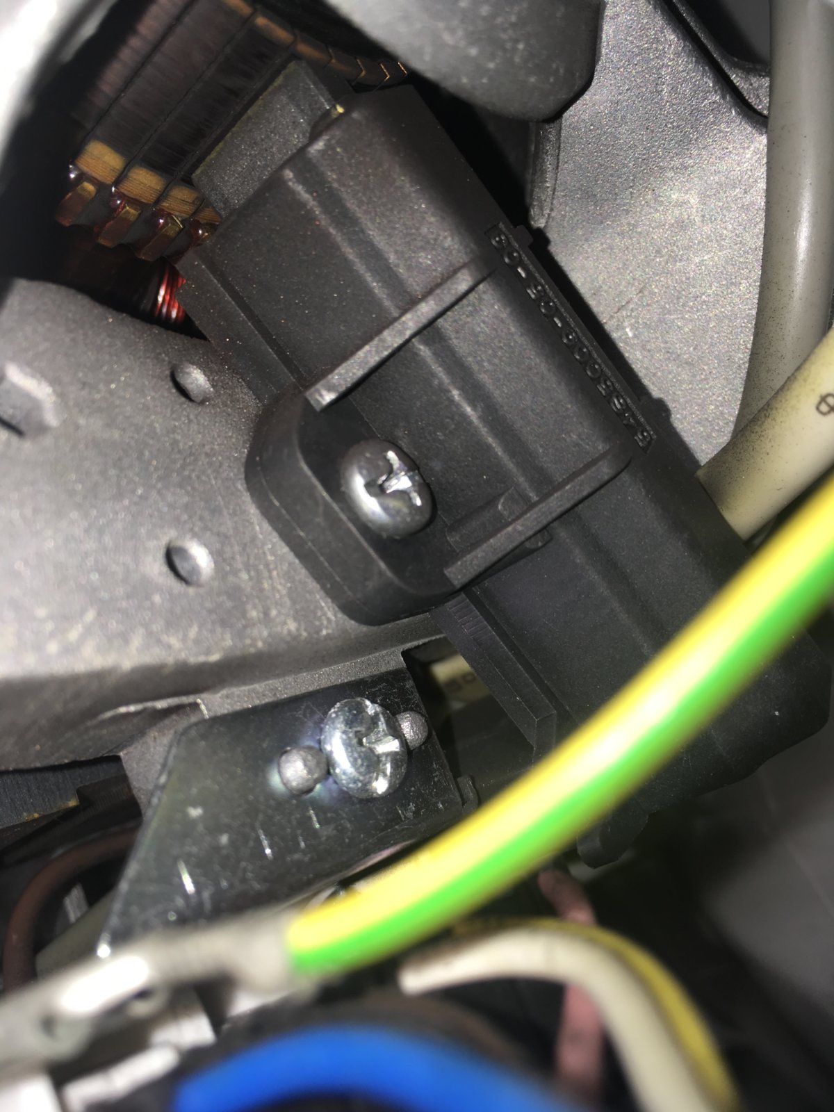

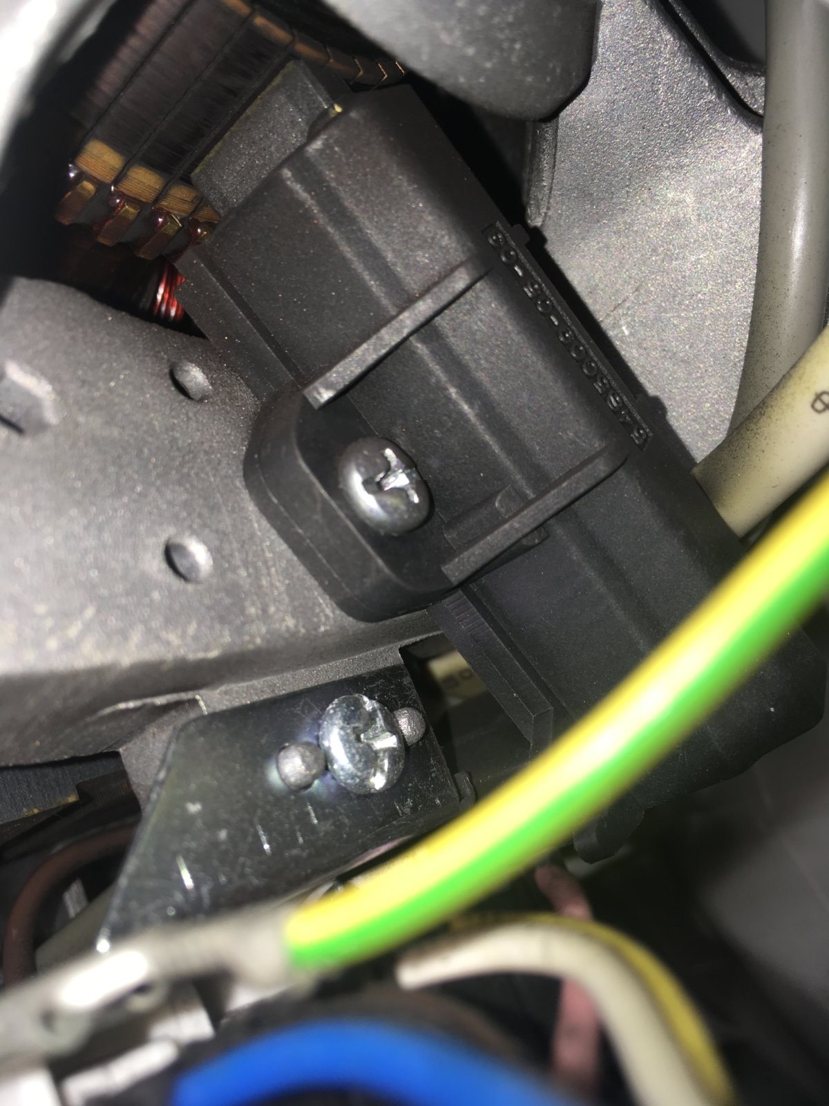

Check the motor brushes first, they should be at least 10mm long & free to slide in & out of their holders under spring pressure
Ok will do. Just curious. Would this explain the loud squeaking?
Looks like less than 10mm
How can I testing the sliding aspect? Do I have the remove the motor or can I just unscrew the brush
The brush is touching the the bit in the motor so I assume that it’s fine.

I've been presuming the inner drum is free to turn by hand, if that is so there is not much more anyone can do by remote diagnostics. You cannot test a capacitor without the proper equipment but you said it stopped in mid spin so if it failed it is unlikely to be the capacitor but I don't see how the pump can cause your symptoms either. I think you need to call someone out to it rather than throwing parts at it.

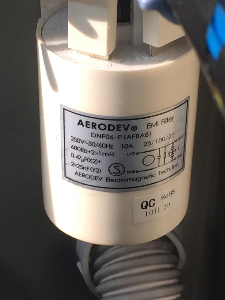

It's a brush motor, it's a suppressor, it's not a start capacitor. Please don't confuse the OP.
Ok I’m confused. I was referring to the thing I took a pic of in the first post. The cylinder that says aerodev on it.
Is that what I should try changing?
The capacitor is a start capacitor. If it has gone the motor will not start up so no wash or spin. Having said that I have never known a start capacitor to blow.
