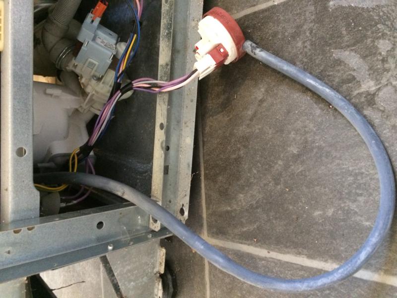

That's right fo5 is the error. Clear the Presure pipe by blowing down it. Blocked by fat in the sump hole.
which is the pressure pipe?
the dishwasher is taking on water and draining it away within the first minute of turning it on?
The pipe runs down the side. Look at the base for access

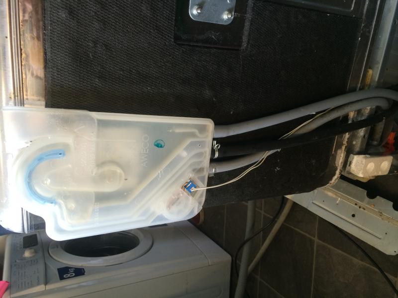

What happening is when I turn it
On this plastic part on the left hand side is filling
Up then it overflows into the sensors wheel on the bottom left that spins then all the water drains out and the 1st and third light starts flashing, I tried unplugging the sensor and it just kept filling up the plastic part then cuts out and then the 2nd and 3rd lights flash.
You think it could be the sensor or still something blocked that's making the water over flow into the sensor?
You are looking at the wrong side., you need the Presure pipe that goes to to sump. It's on the other side.
i have blown down that pipe into the sump doesn't seem to be blocked, turned on still same problem
Put some water in the sump and blow down tube does it bubble
I just came across this this forum while trying to fix my dish washer , was about to give up and chuck it out , but thanks rocks 1 , blowing down the pipe cleared a load of gunge out , now seems to work ok

I had the same problem I took the filters out and felt the exit hole where the water goes I cut a bit of hose and put it in the drainage hole and blew down it.....it stunk! Problem solved
Thanks, Rocks 1 - rest of the internet didn't even thinking error code F05 was possible, but blowing down the drain hole worked a trick
