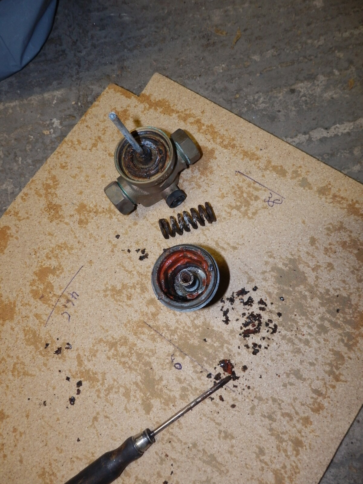

I have a problem with the hot water.
Our hot water works via a hot water calinder with inputs from a boiler and a solar panel loop.
The cylinder is made of copper and the inflow has a pressure reducing valving with a 2.1 bar rating. It has a 18l expansion vessel connected nad that was serviced and the pressure in there is about 1 bar. We also have a pressure and temperature relief valve on the cylinder, but they hardly ever / never get triggered unless for testing.
The cylinder heats up nicely and when we switch the hot water on in the shower or kitchen tap, we get plenty of water pressure. after a few minutes this nice water pressure evolves into a little dribble and when you wait the pressure will recover again but not to the original pressure.
There is no inflow obstruction / restiction. It is all 15mm pipe. The cylinder with all valves was installed together with the solar panel about 20 years ago.

I am wondering whether this odd water pressure is a sign of the pressure limiting valve being on its way out?
Is it an unvented cylinder, being copper then I wouldn't expect so. Is the expansion vessel(EV) red or blue/white/grey?
If it is an unvented then the EV isn't at the correct pre-charge pressure. Also there may be an issue with the PRV if you are seeing a drop off in HW pressure.
If it's unvented then you need to get a qualified engineer to service it properly, once it's serviced properly then it should be back to normal. It may require parts though.

OK, so pre-charge EV pressure is too low for a kick off.
The Pressure Reducing Valve (PRV) may need cleaned (filter) or adjusted/replaced. I am surprised that there is no pressure release valve associated with that PRV or is it further up the inlet line?
Ultimately you need to have a qualified and recommended unvented bod in to service the system properly. Once serviced you shouldn't have an issue. There is a flow restriction somewhere and it's taking time for the pressure to recover, especially given it's a 15mm feed.

The cylinder and pressure reducing valve together with the 15mm piping is all old since 2001 and fitted in the upstairs bathroom. We are on the 3. or 4. expansion vessel by now. The current one was fitted in July 2021. The pressure drop is a new thing.
The cold flow into the house is o.k. The bathroom upstairs gets the full pressure minus the drop / elevation.

We have proper hot water pressure again.
A new pressure limiting valve is fitted this week. Adjustable this time, but I am sure that does not matter.
As I had the old one in the garage and it is servicable I opened it up. Scaled up and rusty inside.
I do not think this is reusable after servicing.

Yes, be careful, you don't want any more than the required pressure entering a copper unvented cylinder, In fact if it's adjustable there should be a pressure gauge on the inlet so the pressure can be monitored, you really don't want any more than 2.1 bar entering the cylinder.
It should really have been changed for Newark's own 2.1 bar PRV, they'll be designed specifically for copper cylinders.
