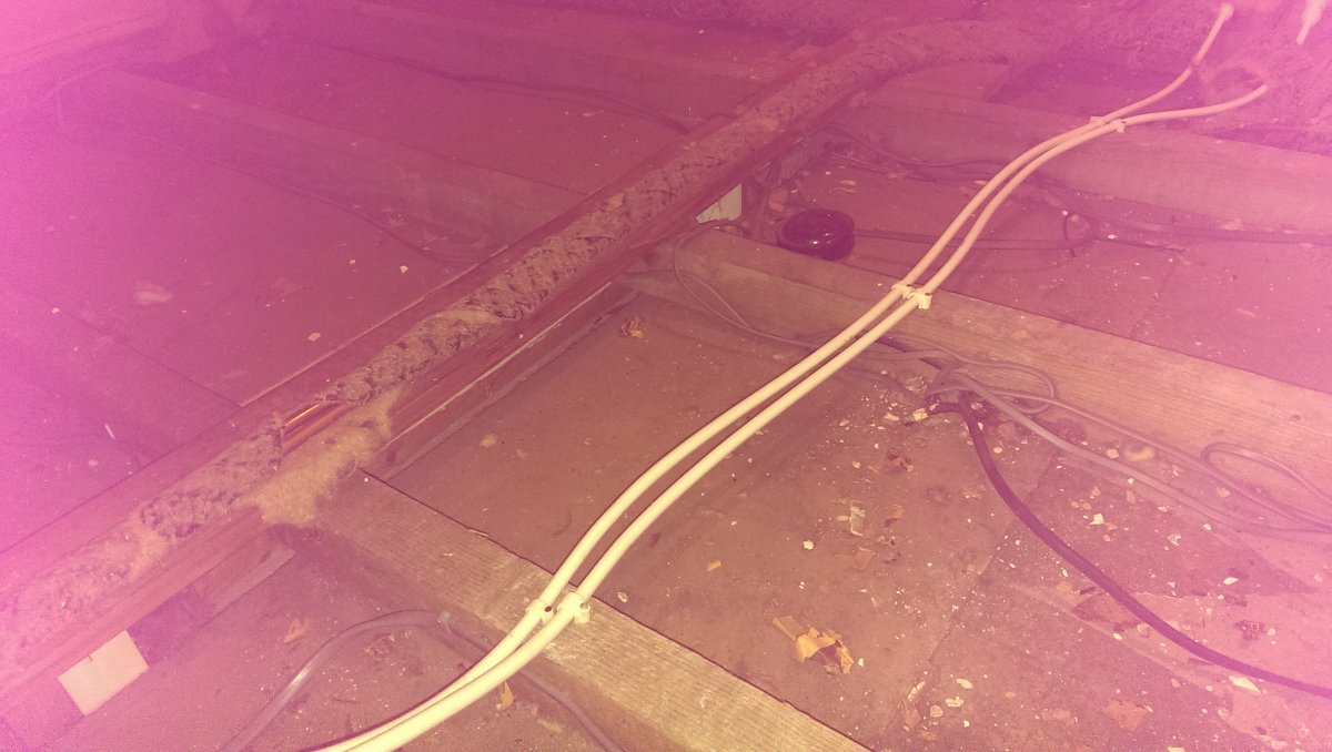

Hi all
I'm in the process of boarding part of my loft which is 6ft 9 x 9ft 2 but when removing the old insulation I found central heating pipes and wires going over the joists which are 3x2.
Can I make stilts out of some 3x2 to raise the boards over the pipework as I'm worried about putting strain on the joists. Some of the pipework is quite high above the joists so I'm thinking of making a box to go over it to protect the pipework.

Can't see that it's going to add that much extra weight. You could also reduce the timber section to 2 x 2 or even 2 x 1 edge on I'd say - providing you use sufficient fixings
No need for stilts. You can use counterbattens at right angles to the existing joists and board onto them. Use screws to fix, as banging in nails may crack plaster.
Counterbattens will spread the load a little, and add some rigidity, as well as allowing thicker insulation under the flooring. They are also more stable than stilts. Position them to suit the width of your flooring.

Thanks for your replies everybody I think counter battens will be the best choice as making stilts would require a lot of sawing and might not be as stable.
