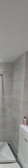

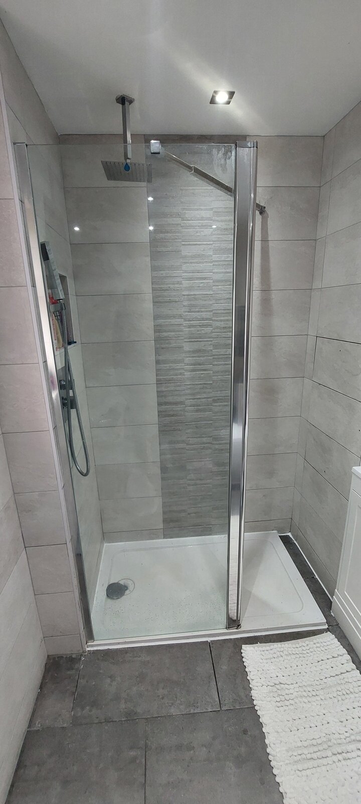

Hi guys
Firstly I know what you are thinking "what where we thinking" and to be honest with you we weren't thinking straight.

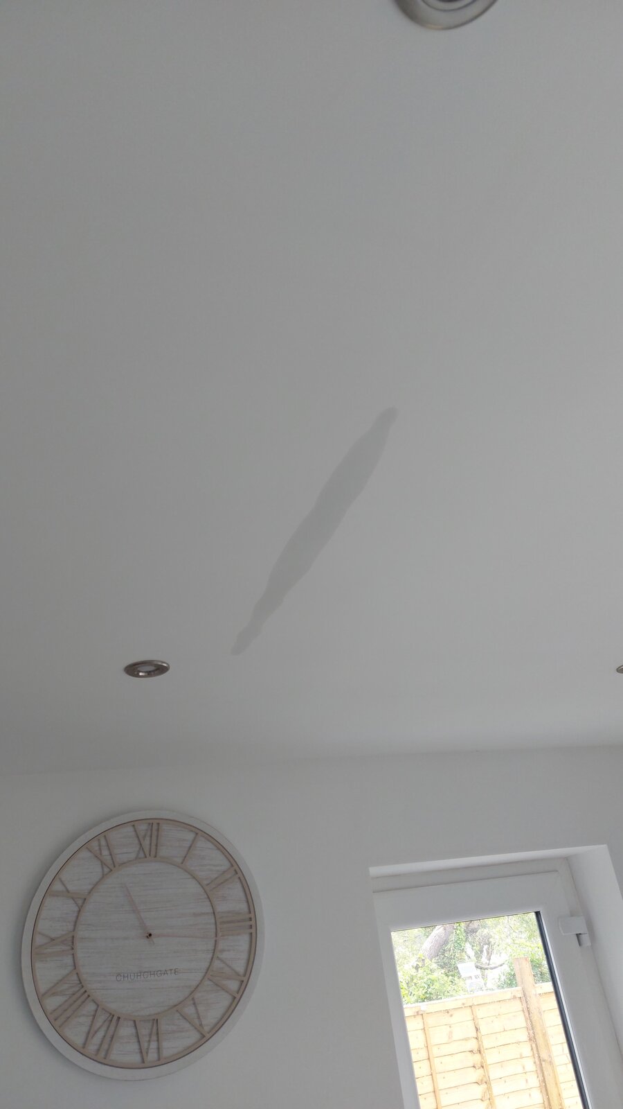

We have a shower which has been sat in place for about 2 years now all was fine. Recently we had a bit of a flood where a flexible pipe burst and flooded the bathroom with some leaking downstairs. We mopped it up and the only real sign was a water stain on the ceiling. Fast forward about 6 months and now we seem to get more evidence of leaking on the downstairs ceiling. I know we need to redesign our shower as this isn't helping but I'm unsure of the best way to go about it. Any suggestions please? Thanks!

Oh dear..... :eek: Did a 'professional' do that?
The trouble is finding out where the water's getting through. With that arrangement it could be several places. That could be sorted by moving that cabinet to the right or fitting one that's smaller (is it a basin vanity?), raise that section of floor to the right of the tray, seal and tile it and then seal it all again. Or fit a narrower tray wall to wall, then a new enclosure door to fit the whole space.

Only reason for that usually and I spotted the fact that the dip tube wasn't fitted, will be the way the waste has been run for the low level trays, typically without a good enough fall on the waste pipe. The tray could probably be raised up on a plinth and that would increase the effective head for better drainage too.
Who was your tiler - bit strange putting the small cut at the bottom like that too.
Tray needs re-worked properly.
Not sure a dip tube (just googled) is required for this shower? It came with a waste that has like a cup inside to handle the water. Also unless you can adjust the height of them I don't think it would fit? Or as you referred to raising the tray then obviously it would fit.
Also re the tiling - yeah not sure why he started with a small cut rather than half. Either way that's not the end of the world we just want to sort this water issue out

Cant tell from the pic, just saw the cover off of it, usually people do that because the trap doesn't drain properly and lifting the cap/dip tube makes it drain quicker.
Yeah, 600mm trays are harder to find but you can get them. How long is the space? There's a 900x600mm low level tray
What is the cabinet to the right edge of the pic, can that not be moved?
Haha the cap was off probably because we cleaned the shower and never put it back on
